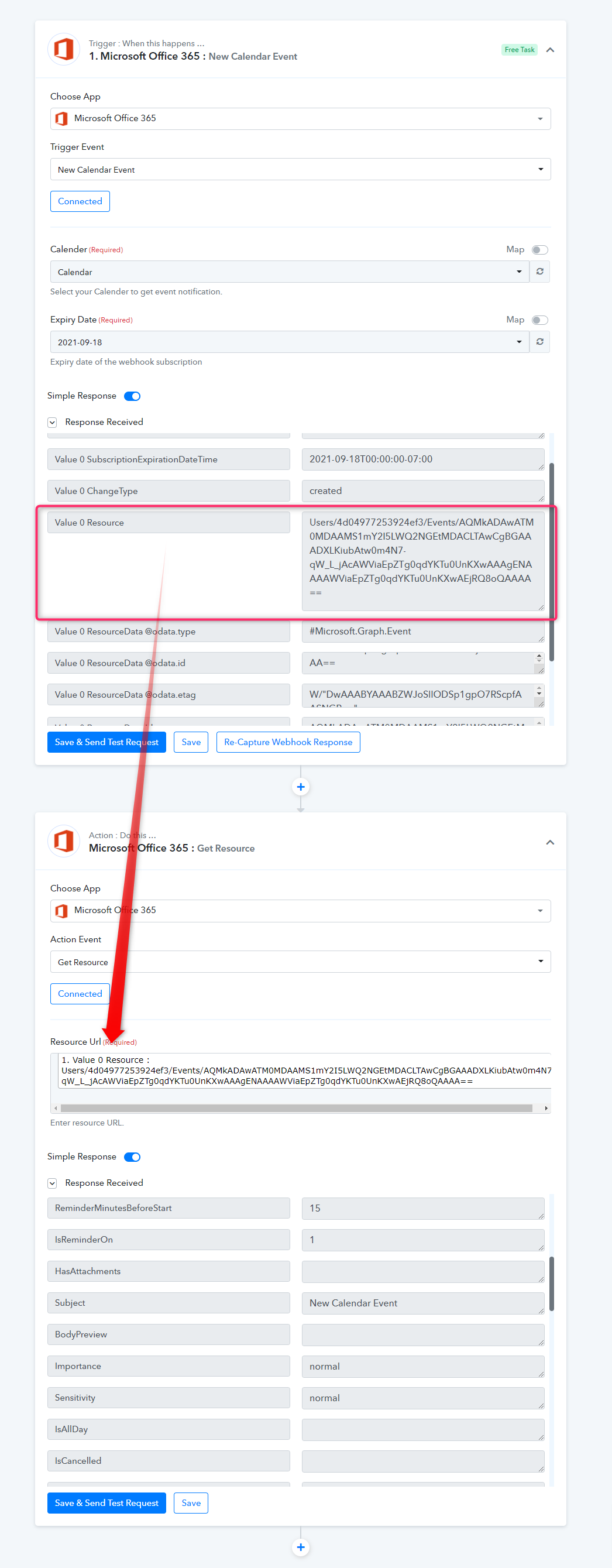

We checked Office 365's Trigger Event "New Calendar Event" and it is working fine. Although the spinning is because the trigger was waiting for the API to respond and sometimes the API takes a little bit more time to process the response.
Moreover, to retrieve the additional data you might need to use an action event of "Get Resources". Kindly check out the following screenshot for a better understanding.
