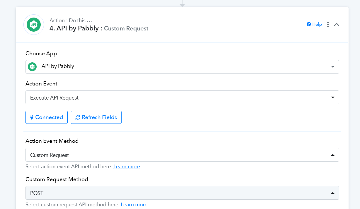

Hi @SnackGuy,
Could you please share the API documentation for the endpoint you are attempting to execute using the API by Pabbly module? You can try using the Custom Request action event method to get the field in which you can enter the data.

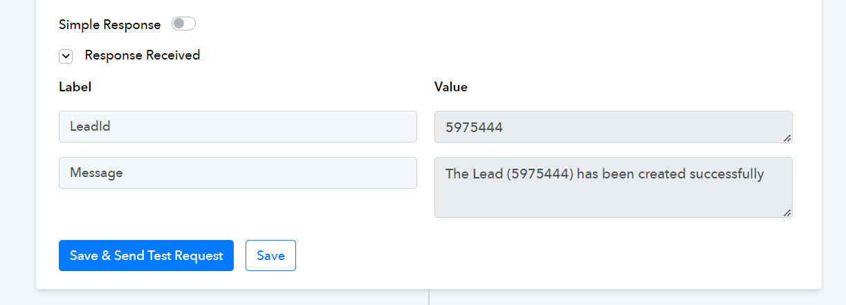

I have made some changes to your endpoint request, and it seems to have fixed the issue.
