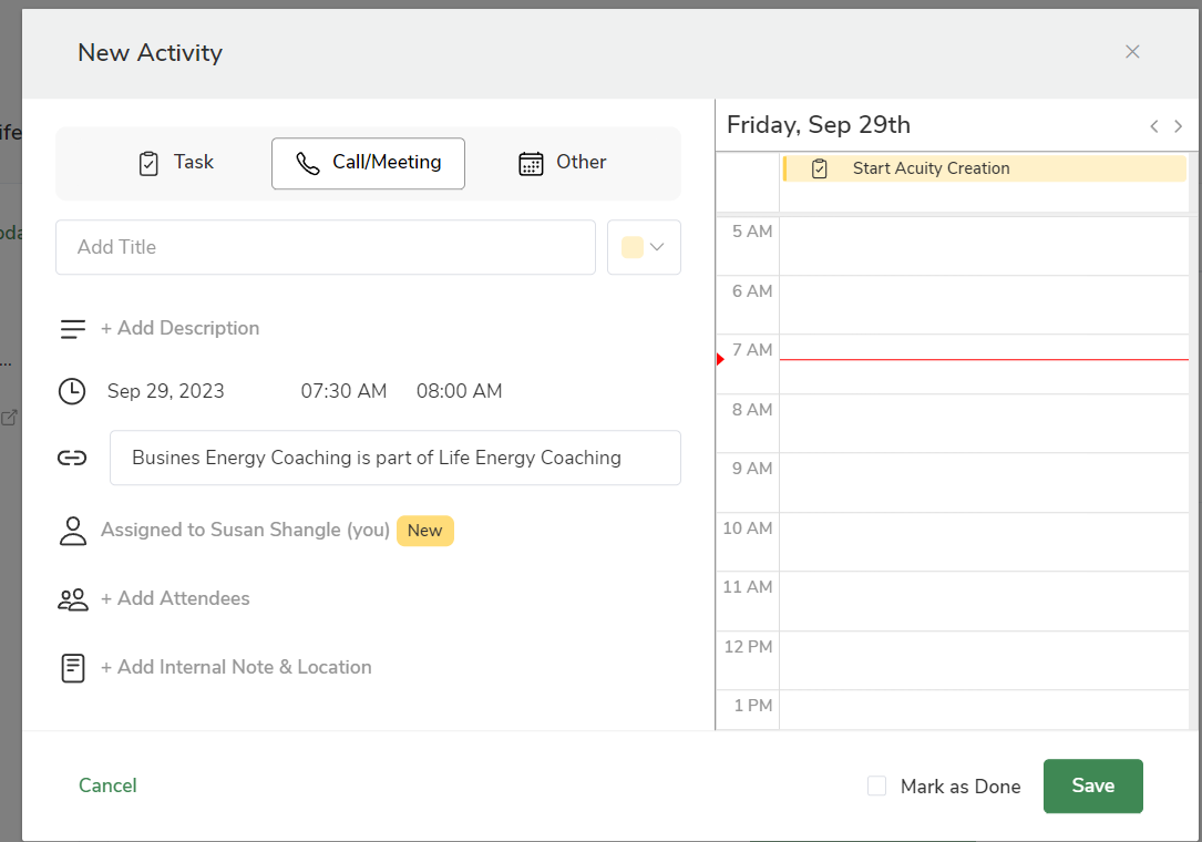

I've actually tried to make this work - and it seems impossible.
Creating an appointment from the Acuity data - which only gives the start time fails because CJ is requiring an end time.
Also I can't figure out how to make it attach the appointment to the right lead.I

I think part of the issue is that in CJ when I click on New appointment it is tied to the business name
I've attached a screen shot of the record that was created via automation in Zapier and a screen shot of what I see when I book an appointment in Client Joy as I think that will help us see what the roadblock is
So booking the appointment seemed to fail in Zapier as well - so it must be something weird on CJ side I'll see if they can help me.

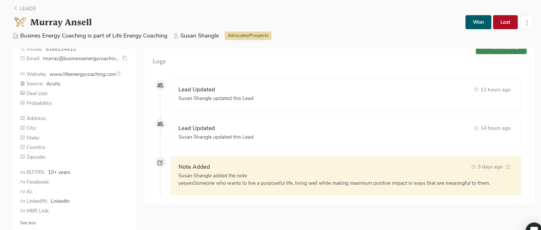

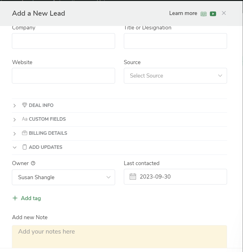

What can I do, if anything to expose all the fields I see when I use create LEAD in CJ.
I'm missing the Notes field
shangle — Reply ·
Hmmm -
I can see in the documentation that those fields don't appear to be available in the API.
In CJ here's what I see.

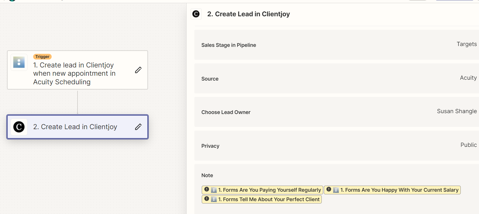

And when I use Zapier I can write to that field -
I am still waiting to hear back from support at CJ - and asked them why I can't see that field with Pabbly. I'll update this thread as soon as I have an answer.
And I've also asked why they connect the Meeting with the COMPANY name not the individual when that field isn't available when we try to automate booking an appointment.
