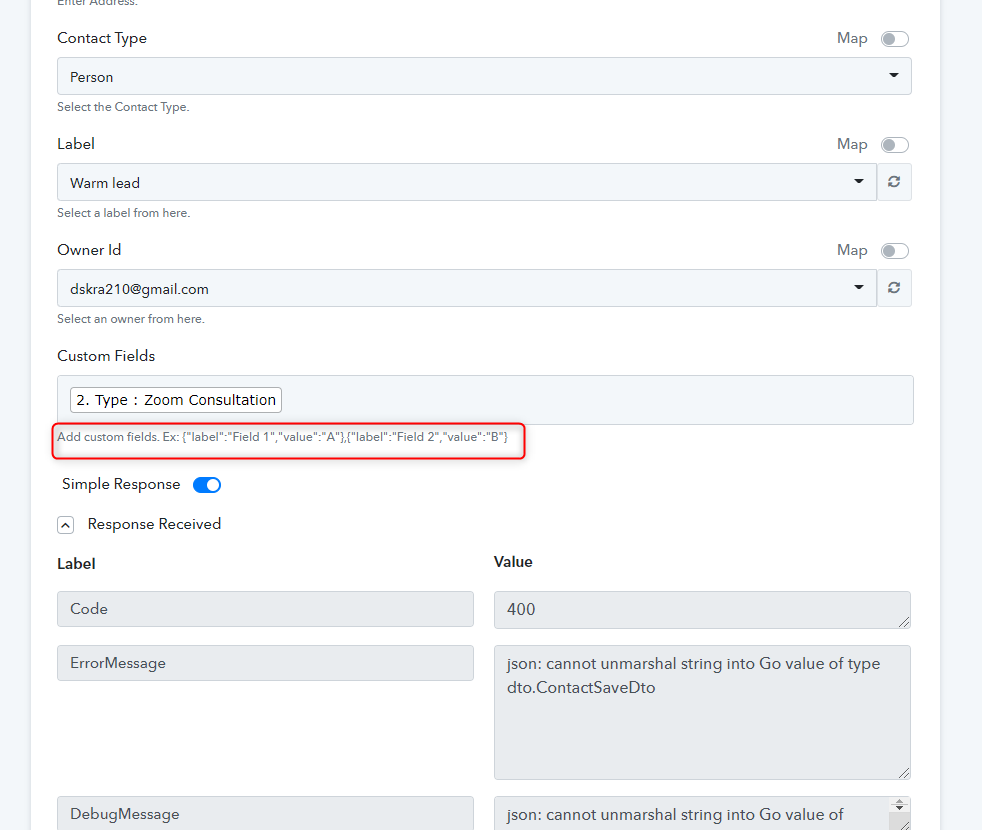

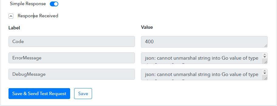

Everything appears to be working fine until I sent the last test request and then I get the error messages:
json: cannot unmarshal string into Go value of type dto.ContactSaveDto
Am I doing Something incorrectly?
Hey @csdoes
We check your Deskera action step and we found that you need to pass the Custom Fields in a certain manner, please check this out-
Please try again in the correct manner and let us know if some problem still persists.
Neeraj Agarwal — Reply ·
The label above is the id of your custom field and the Value is the value of that custom field.
So for example:
If your custom field id inside Deskera is consultation_type and the value you want to pass is Zoom Consultation.
You have to write
{"label":"Consultation","value":"Zoom Consultation"}
