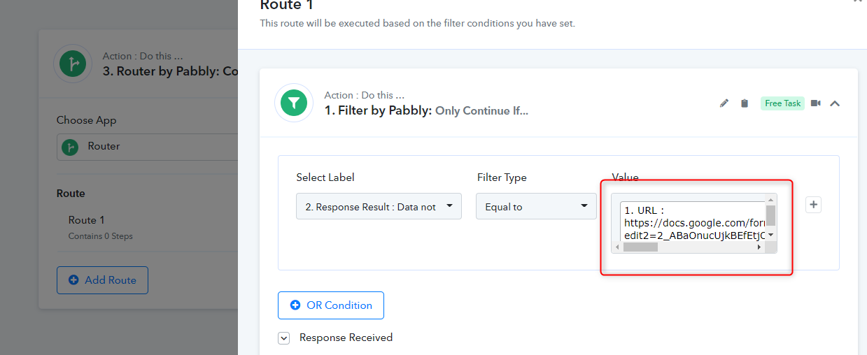

But I don't understand what you're saynig about adding a manula value in the Value column - the whole point here is to check if a preceding lookup step in a Google sheet find the value in the URL filekd, and if not, then create it, so I really don't see how to enter a static value and achieve this?
PabblyMember4 — Reply ·
Hey @Lars
Usually, we suggest all the users keep the value field as a manual field. However, in your case, you are filtering the URL values so you can continue with adding URL in the filter condition.

Hi, starting to narrow this down a bit. It appears that the trigger does appear to fire as intended, but the router at the end of the workflow returns false for both conditions.
What I’m trying to achieve is that once triggered, perform a lookup in another sheet for a unique value in the new/updated row in the current sheet. The lookup returns either a row number or 0, if I’ve understood correctly, and I’ve set the router up to create a new row if 0 is the returned value, otherwise update the row at the returned row number. But it isn’t working with the way I’ve set it up and so I really need som clever input here on what I’ve done wrong.
Hey @Lars
Could you please once check the router condition again as you are checking it Rowindex:97=0 every time, because of which you are not getting the data in the Google sheet?

I shared the sheet as instructed last Sunday, and of course I'm not checking literals! Before the router comes a Google sheet lookup which return either a row number of key already exists, or zero if it doesn't. QUESTION: Does it return zero or som other value of the row doesn't exist? Can't find documentation or video regarding this.
And yes, I've followed up twice now, and still no reply. As a paying customer, I'm currently less than happy.
Hey @Lars
We have made some changes in the Router>> Filter condition and check if the value you are searching for via the Lookup function exists in the Google Sheet then update the records and if the value does not exist then it will create a new record in the Google sheet.
