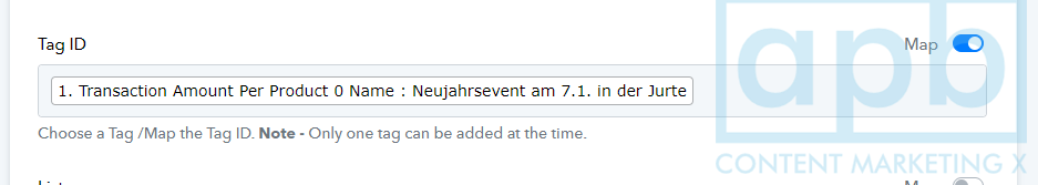

I want to update/create an ActiveCampaign contact and want to add tags from fields provided by the trigger to them.
But I got failures while testing:
Set up:
Failure:
I also tried the action "create tag" and then "add tag to contact", but the failure is the same. And: In the end, I want to add multiple tags to that contact, not just one.

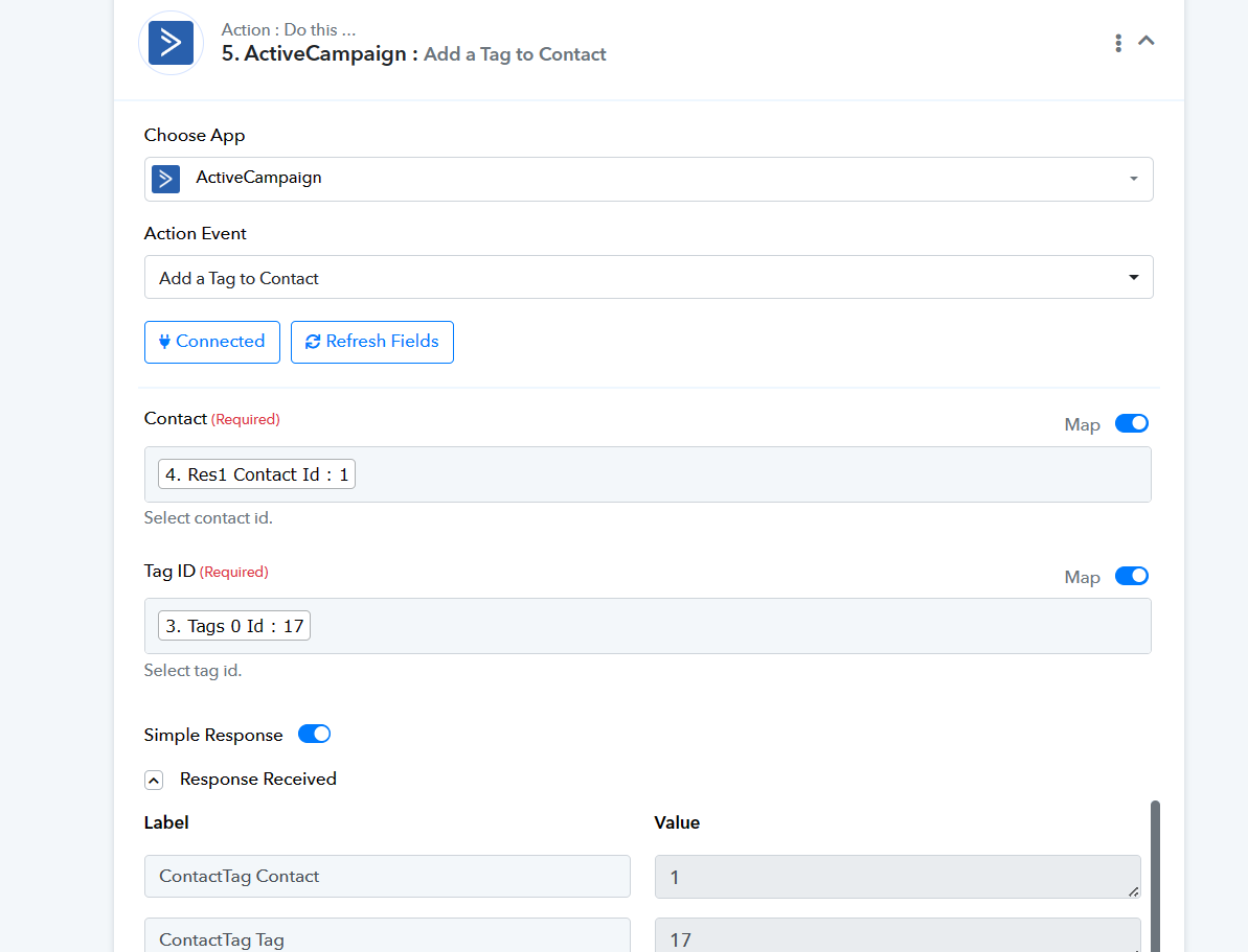

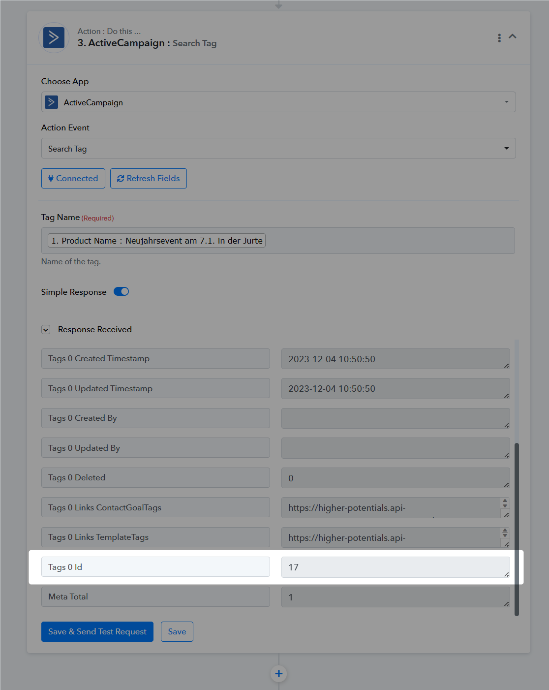

Hey @kontakt@contentmarketingx
As mentioned in the Tag ID field you need to pass the Tag's ID in the field if you are mapping with the help of the Search Tag action step.
After correcting the mapping the action step will work accordingly.
