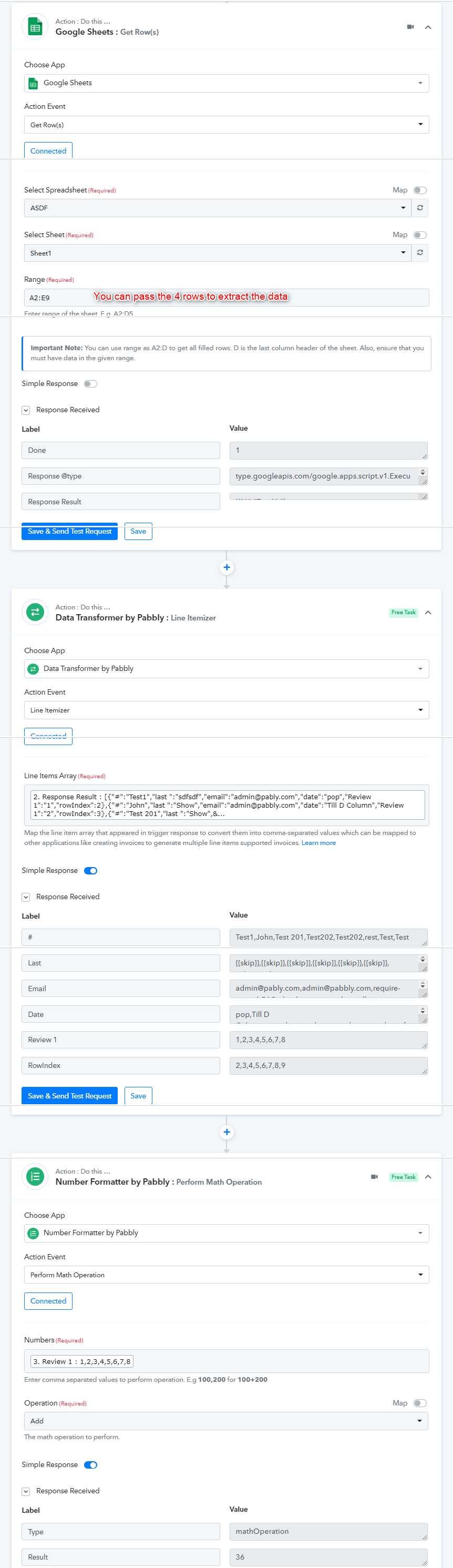

You can refer to the following screenshot on your concern, please check that out and let us know if that works for you.

Please refer to the following workflow for your concerning use case, kindly give it a try and let us know if that works for you.
mikec29526
This works incredibly well!!! This is an amazing template you sent me that I customized just a little bit. That arrays feature you sent is great! Thank you so much for the great support!!!
