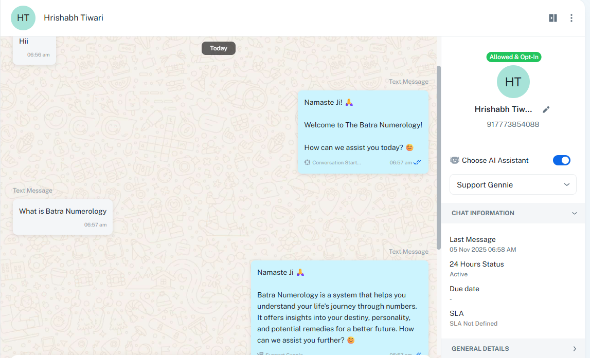

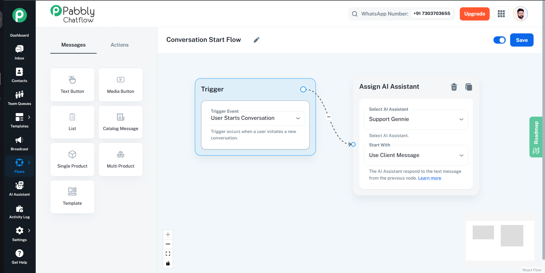

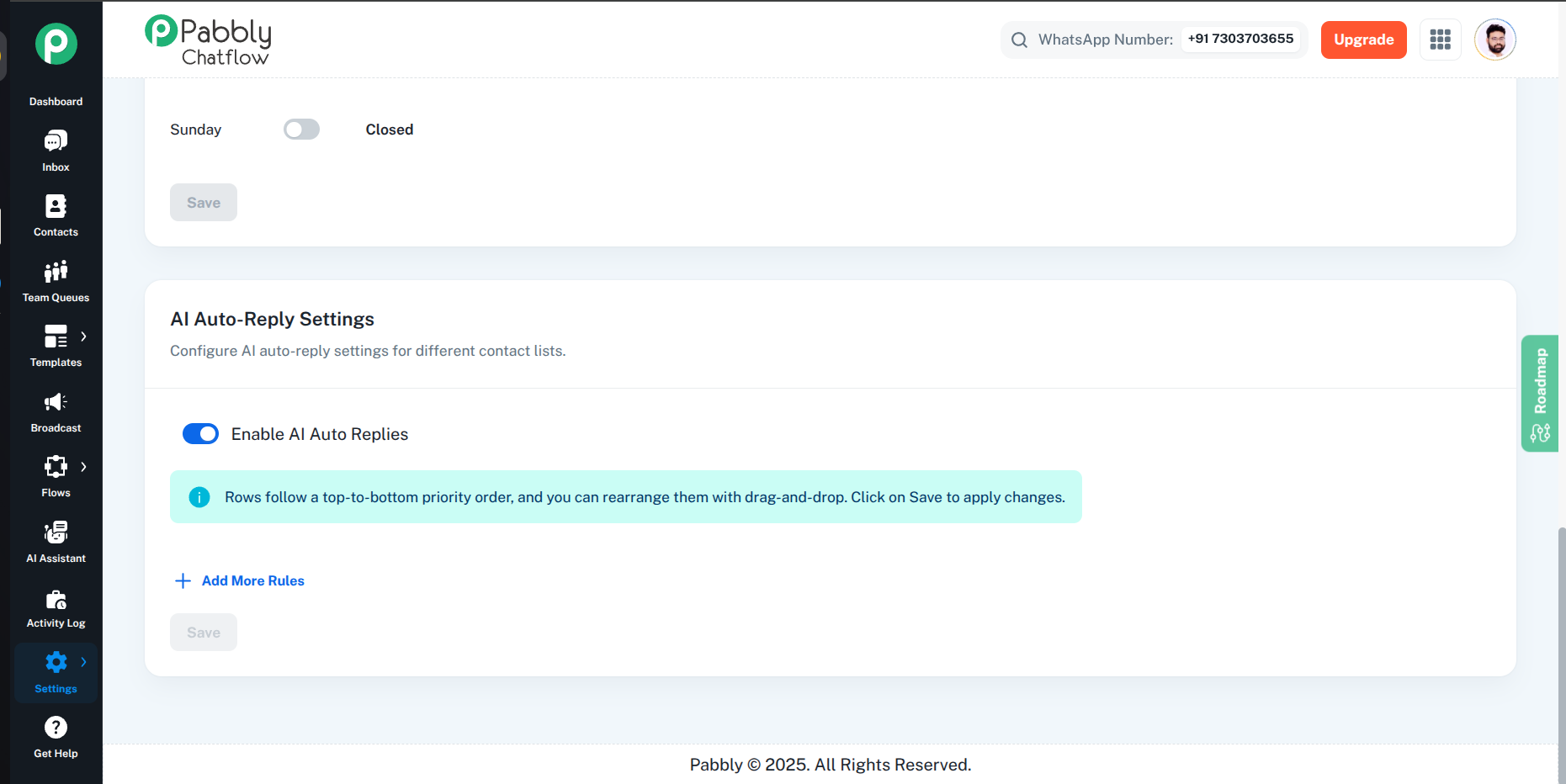

I have created an AI assistant, and have created a chat flow also but when I am getting the messages from the new contact then my chat is not getting enabled. here are the SS attached. and from inbox settings I have made the auto replies enabled. In place of having manual enbale for each of the contct or new messages how can i enable the automated support ai assistant.

We tried sending a message to your WhatsApp number connected with the Pabbly Chatflow (+91 7303703655), and the AI assistant was automatically assigned to the chat and able to respond as expected.
Please share the specific Inbox ID where you are noticing that the AI assistant did not reply, so we can check the configuration and help you further.

Additionally, the flow you’re referring to will only work the first time when the user initiates the chat. If the chat has already been initialized and the user sends another message after a long interval, the flow will not be triggered again.

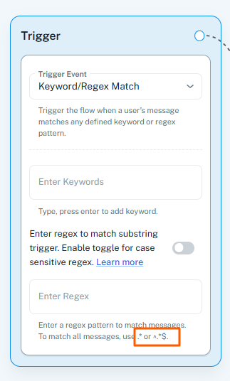

Hi @vivekpathak2025,
In that case you can set up a flow with Trigger as per the attached image and regex to accept all messages.
Ok Will do that and let you if there is any issue.
