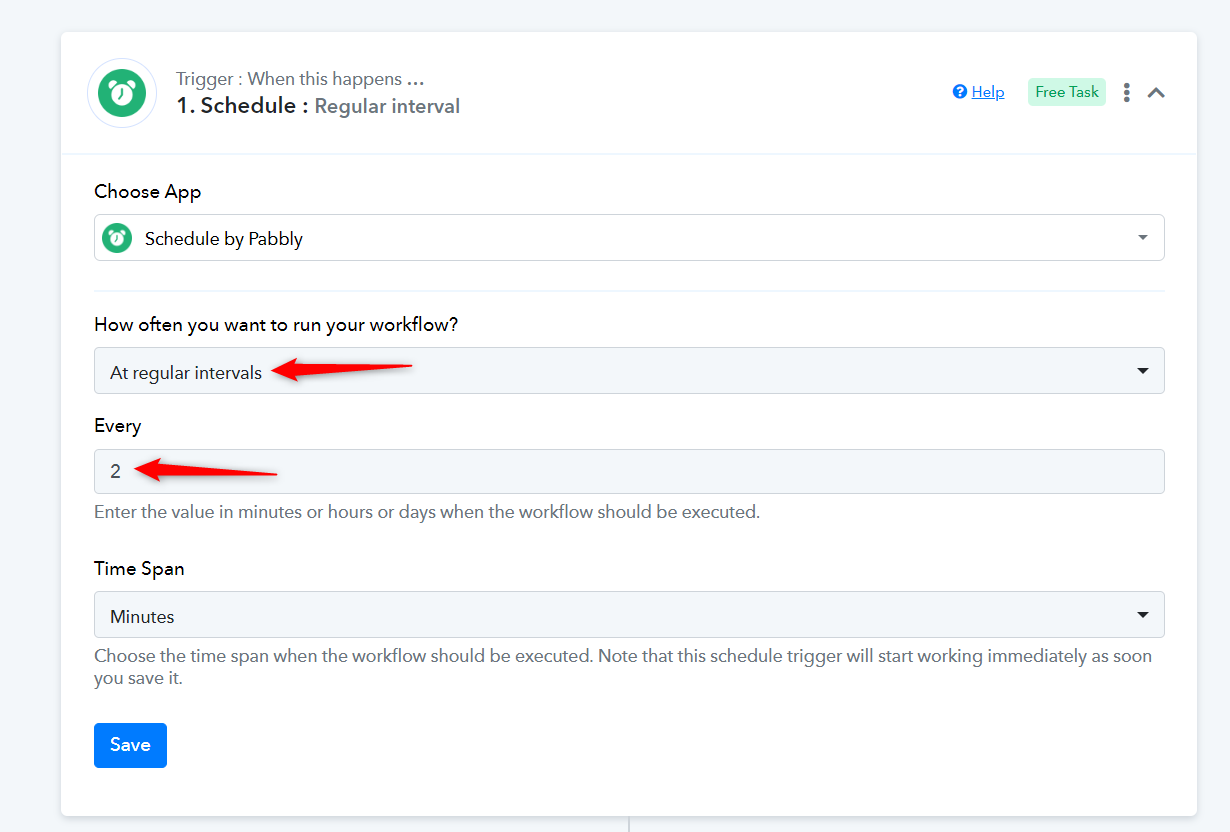

Please set up the first three steps of your workflow in this manner, and remove the Delay step altogether.
You can set the Scheduler to trigger every 2 minutes. This will allow you to process each row in the Google Sheets spreadsheet every 2 minutes, instead of all at once.
