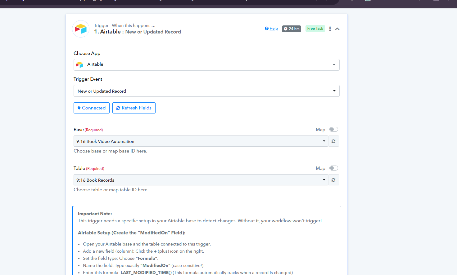

Here’s what I’ve already verified:
  • The Airtable connection is active and connected
  • Base and table are correctly selected

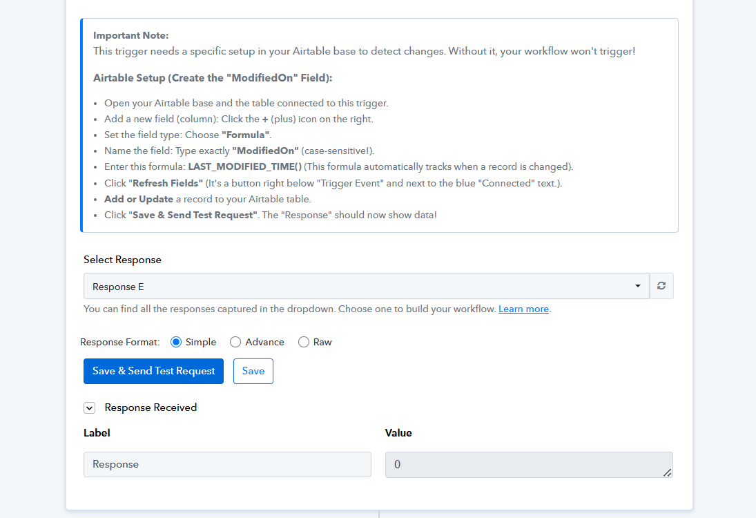

  • I have created the ModifiedOn formula field exactly as instructed
    LAST_MODIFIED_TIME()
  • I refreshed fields after creating the ModifiedOn field
  • I updated existing records and also created new records
  • I clicked Save & Send Test Request, but the response still shows 0
  • No trigger event is detected even after confirmed record changes

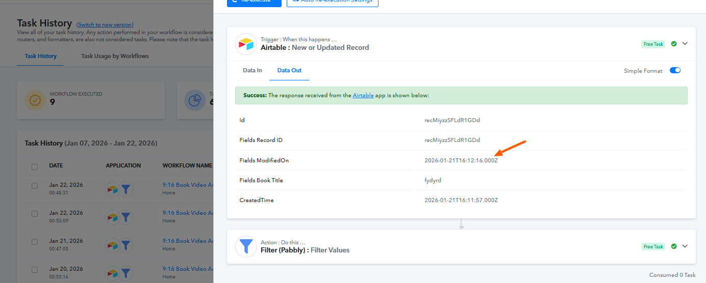

I’ve attached screenshots for reference.

Could you please confirm if you have modified or created any other record in Airtable after the latest timestamp shown in the attached image.
Once you confirm this, we will be able to guide you further accordingly.
CenterSquareSoftwareLLC — Reply ·
No, modifications or other created records after the timestamp shown above.
Hi @CenterSquareSoftwareLLC,
Thanks for the confirmation.
That explains why the workflow did not trigger — since there were no new records created or modified after the latest timestamp, the trigger did not detect any updates to capture.
