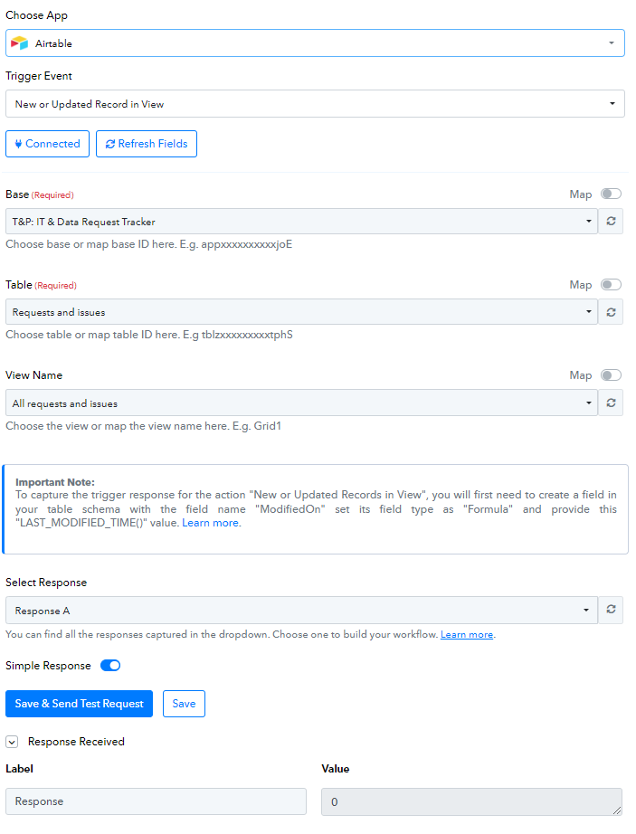

I am having a problem with the new record in view trigger. When I test it in the app it works, but when i leave it to just run, it isn't running.
Jeni — Reply ·

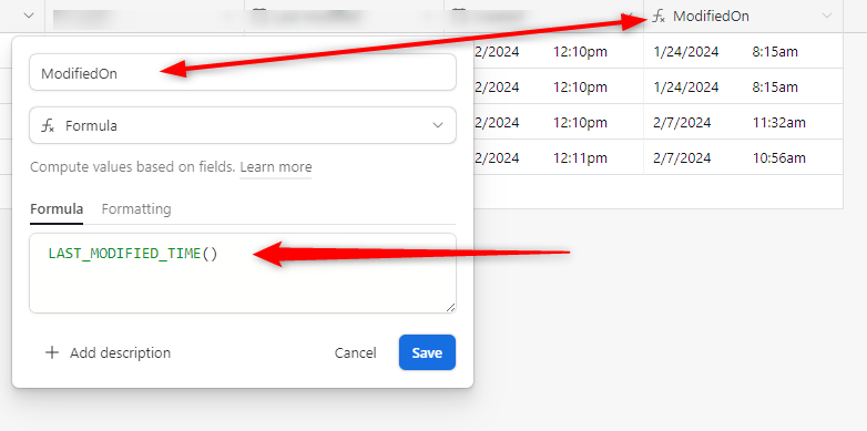

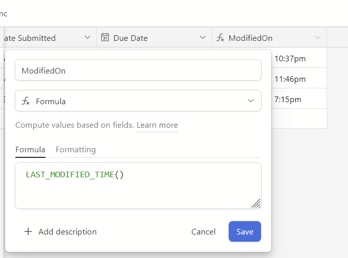

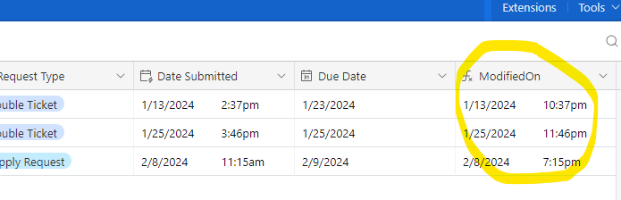

I am also having an issue with this trigger:
I have set up the Airtable with the proper formula:
Hey @Jeni
Can you please check from your Modified On field once that have you entered the formula as mentioned in the trigger event?
Jeni — Reply ·
