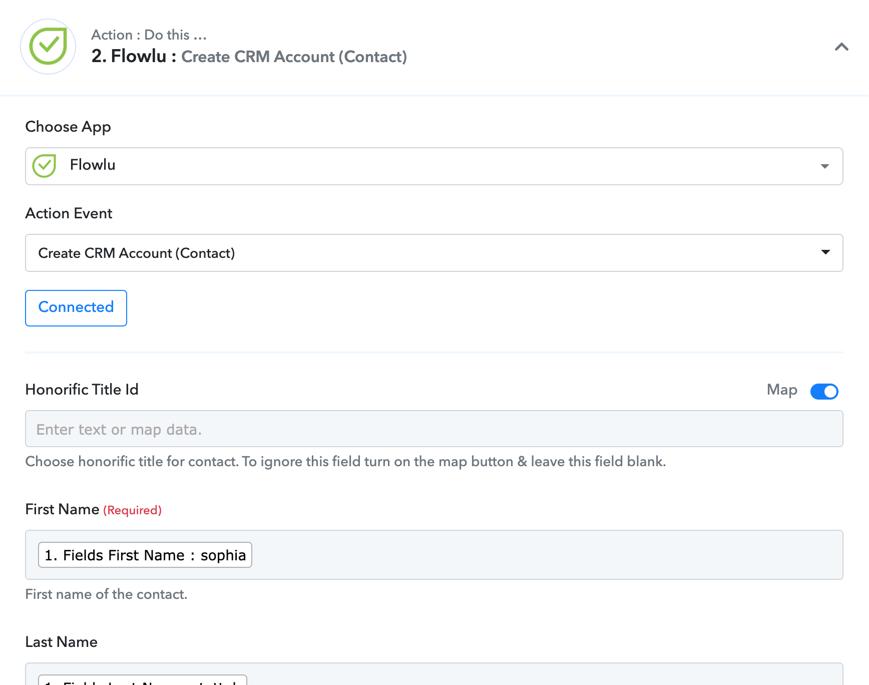

Linked Airtable (New Record) with multiple fields to (Action) create a new contact in Flowlu
After multiple successful tests
NOTHING HAPPENS
I've toggled the workflow on and off and nothing is happening for 12 hours
Is there a step missing?

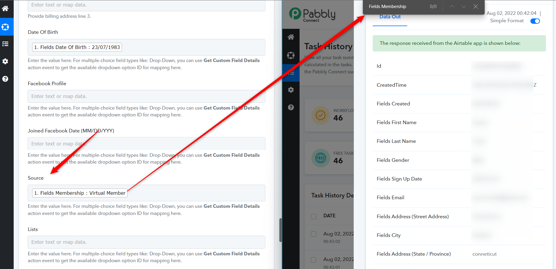

UPDATE Just added a batch of records but the fields needed (Source, Phone Number, Birthday) did not migrate over.
Does something need to be reset?
Hey @Glow33029
Kindly make sure that are you getting the mapped data in the (Source, Phone Number, Birthday) from your trigger response.
Glow33029 — Reply ·
Hey @Glow33029
What about the older records that were created?
Those still did not migrate over.
Hey @Glow33029
Kindly trace back the task hisotyr Id and check whether the mapped label data re coming from your trigger response or not.
If not then make sure that all the mapped data has data on it, you can also try recapturing the webhook response and map the fields again.

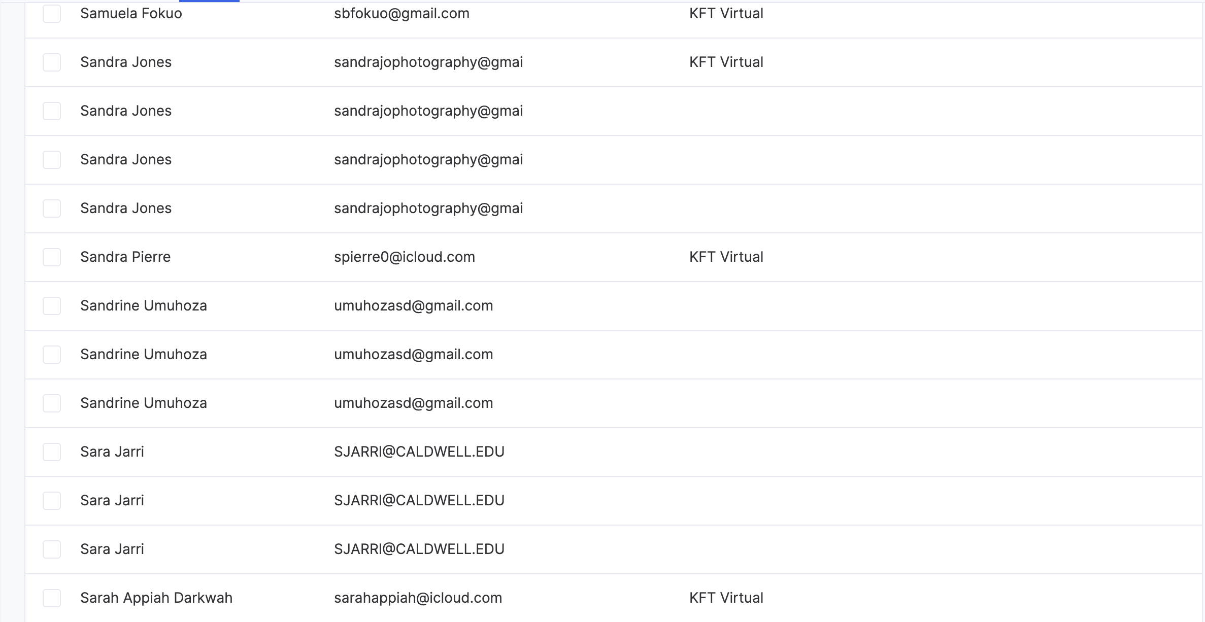

I turned off the workflow,
cleaned up the Airtable list to remove all the entries that were successfully added to the Flowlu platform
recaptured the webhook,
remapped all the sources to the correct input fields
turned on the workflow
Pabbly is now wasting my allowed tasks for duplicate entries that were removed from Airtable and creating duplicate entries for those that were already successfully added.
How is that possible?
Why are my tasks being wasted like this?
Glow33029 — Reply ·

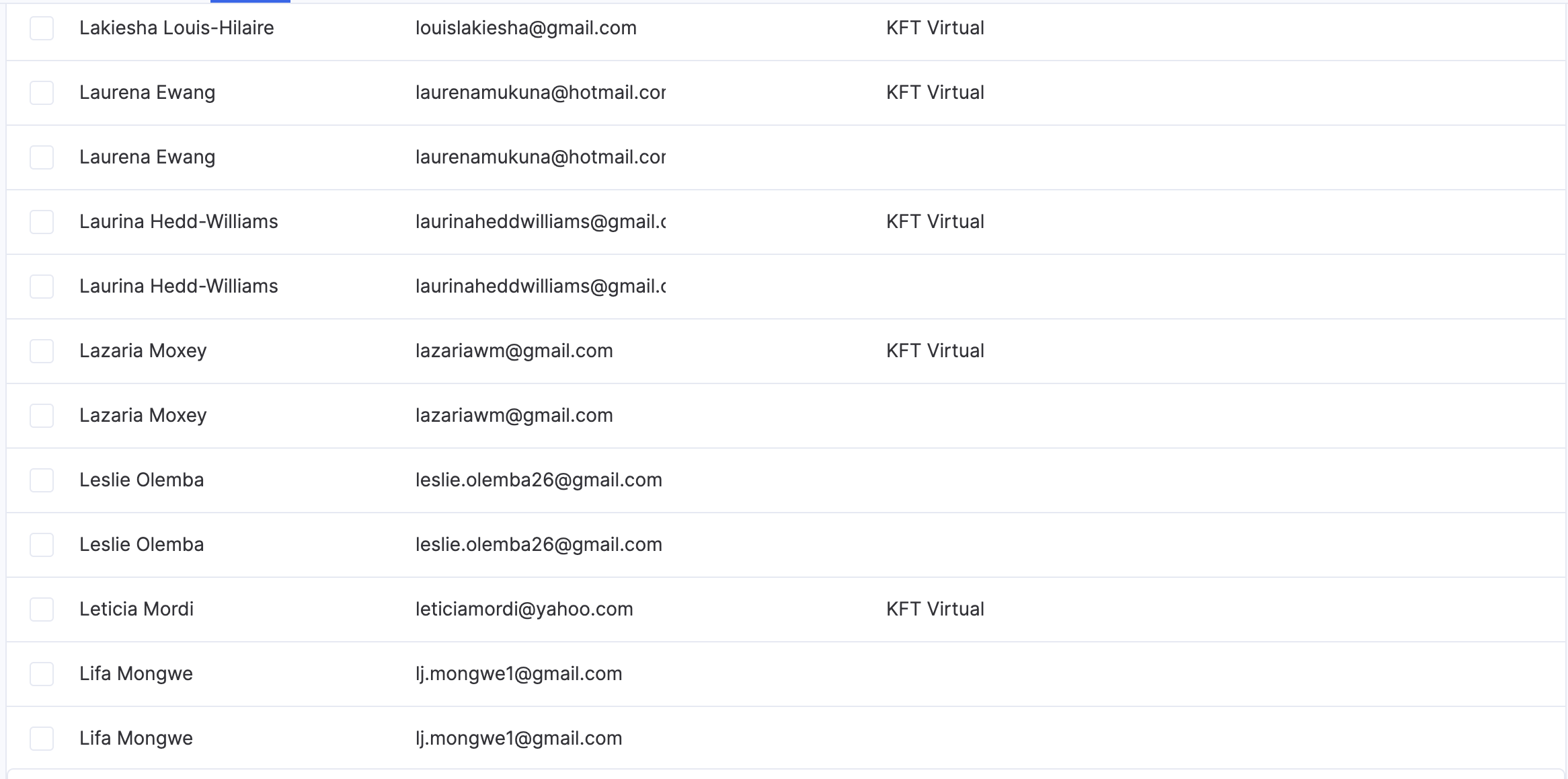

I have had to delete more than 50 duplicate records
SMH
Glow33029 — Reply ·
Another 50 tasks were wasted on duplicate records

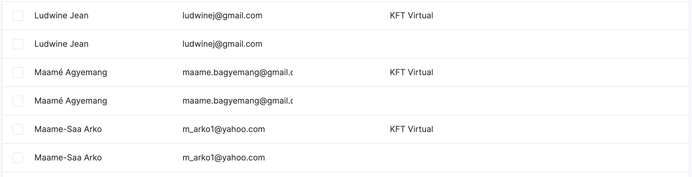

Glow33029 — Reply ·

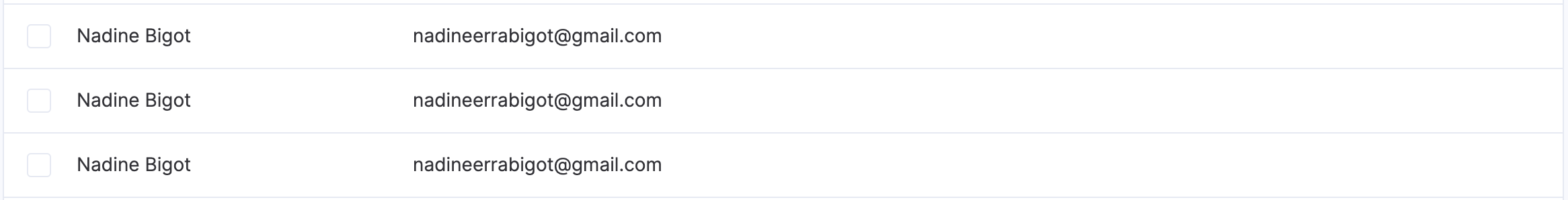

We have officially graduated to triple and quadruple entries

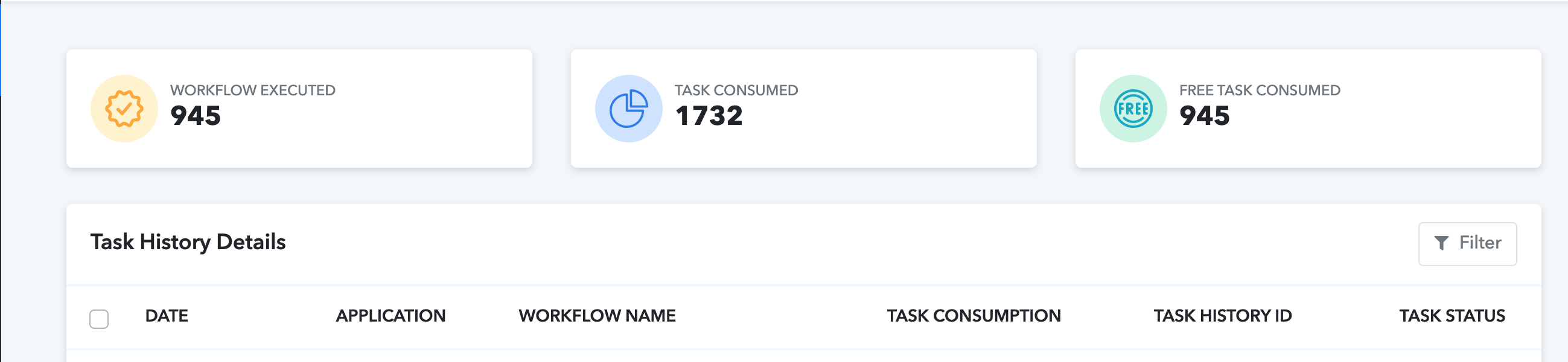

Glow33029 — Reply ·
The number of tasks consumed for 454 records is crazy, especially for the multiple duplicate entries. More than half of my allotment is gone.

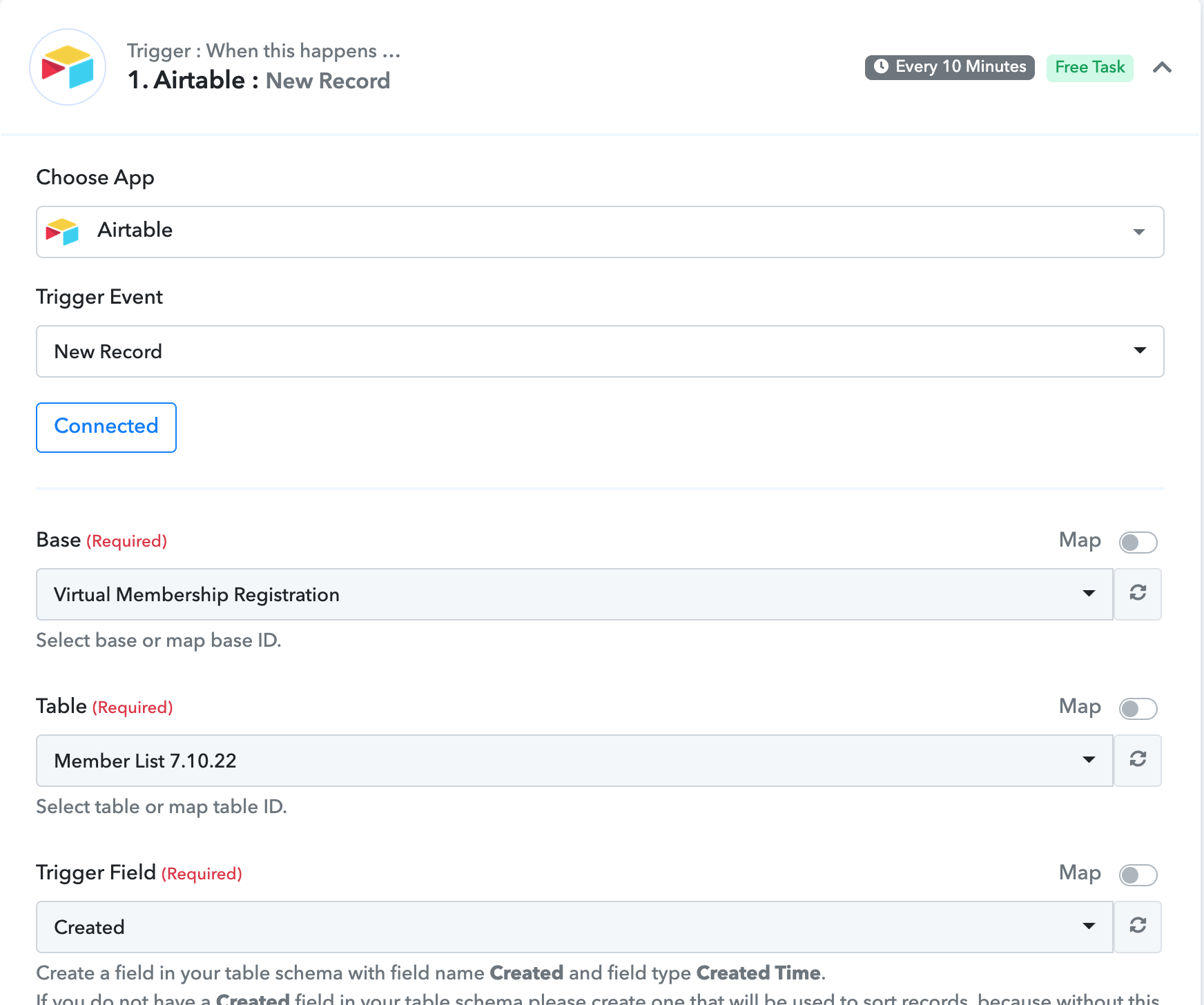

Because the triggers would time out after 24-48 hours, I would have to go back to Airtable and remove the records that were already transferred and copy-paste the data that was not transferred to start the trigger. After 2-3 days I had to copy-paste the data that didn't transfer multiple times due to the trigger timing out.

I added 35 records to the Airtable spreadsheet this morning, I am now double checking Flowlu and I am still running into duplicate entries and my number of tasks being wasted. I counted 45 workflow histories in Pabbly Connect (why is this happening? Will I be credited?)
