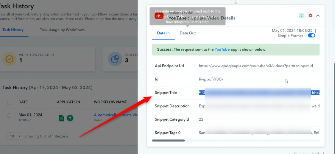

Task History ID -
IjU3NmMwNTZlMDYzMTA0MzM1MjY4NTUzMTUxMzU1MTYxNTQzNCI_3D_pc
Executed at
May 01, 2024 18:08:26, (UTC+00:00) America/Danmarkshavn
Error code 400
Data In : Success

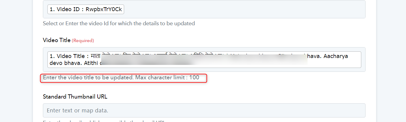

but in Data Out (Failed: The response received from the YouTube app is shown below:) it gives error as,
The request metadata specifies an invalid or empty video title.
I have tried Video URL of a Public video, Unlisted Video but still facing same error
WHAT TO DO ????????
Hey @OTechnical
From the task history ID, it seems that the video title you've provided exceeds the 100-character limit by 152 characters, leading to an error in your YouTube action step. We suggest trimming the title to 100 characters or less.

Hey @OTechnical
Solved the issue with your suggestions
