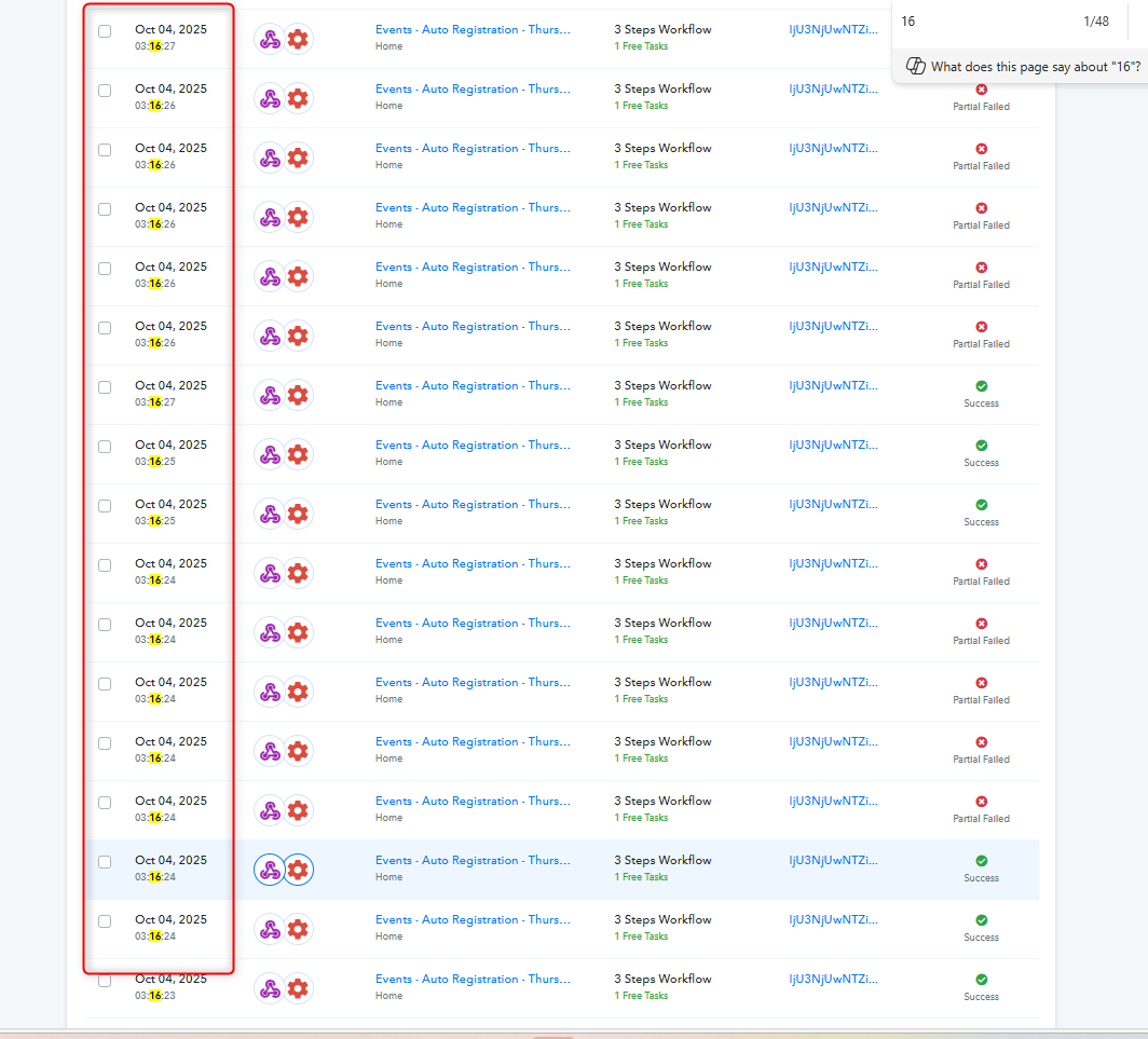

Hey team, I'm hoping for your help with failures occurring on this workflow please - https://connect.pabbly.com/workflow/mapping/IjU3NjYwNTZiMDYzMTA0M2M1MjZlNTUzMzUxMzEi_pc
The workflow is triggering once a week for approx 85 records at once, where there is a GET request being sent to Ontraport, to get data and that step is failing due to - API concurrency limit exceeded. Please try again later.

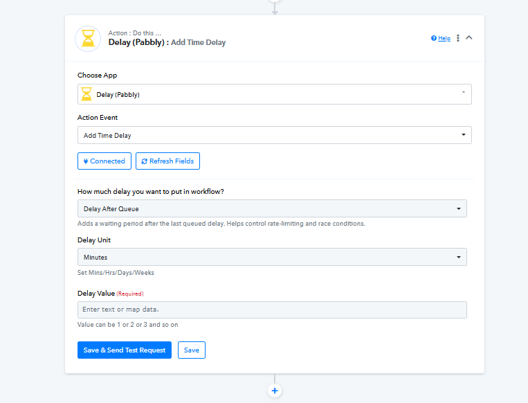

Hello @AbsoluteAutomations
As we checked, the workflow is sending a large volume of data at once without any delay between the requests. To help resolve this, we recommend adding an additional action step “Delay After Queue” to introduce a gap between requests.
Additionally, the error “API concurrency limit exceeded. Please try again later” is coming from Ontraport, which you are accessing via API by Pabbly. We suggest reaching out to the Ontraport team for further clarification regarding their API limits.
This adjustment should help reduce the failures, and the Ontraport team can confirm if any further changes on their end are required.
As mentioned previously, the error “API concurrency limit exceeded. Please try again later” is coming from Ontraport, which you are accessing via API through Pabbly. Since this application is not natively integrated and you added it via API by Pabbly, we recommend reaching out to the Ontraport team for clarification regarding their API limits. You can also share a screenshot of this response with them.
Additionally, to reduce the likelihood of hitting this limit, you can add a Delay step before the API action. This will process the data in intervals, allowing the next action step to run smoothly.
