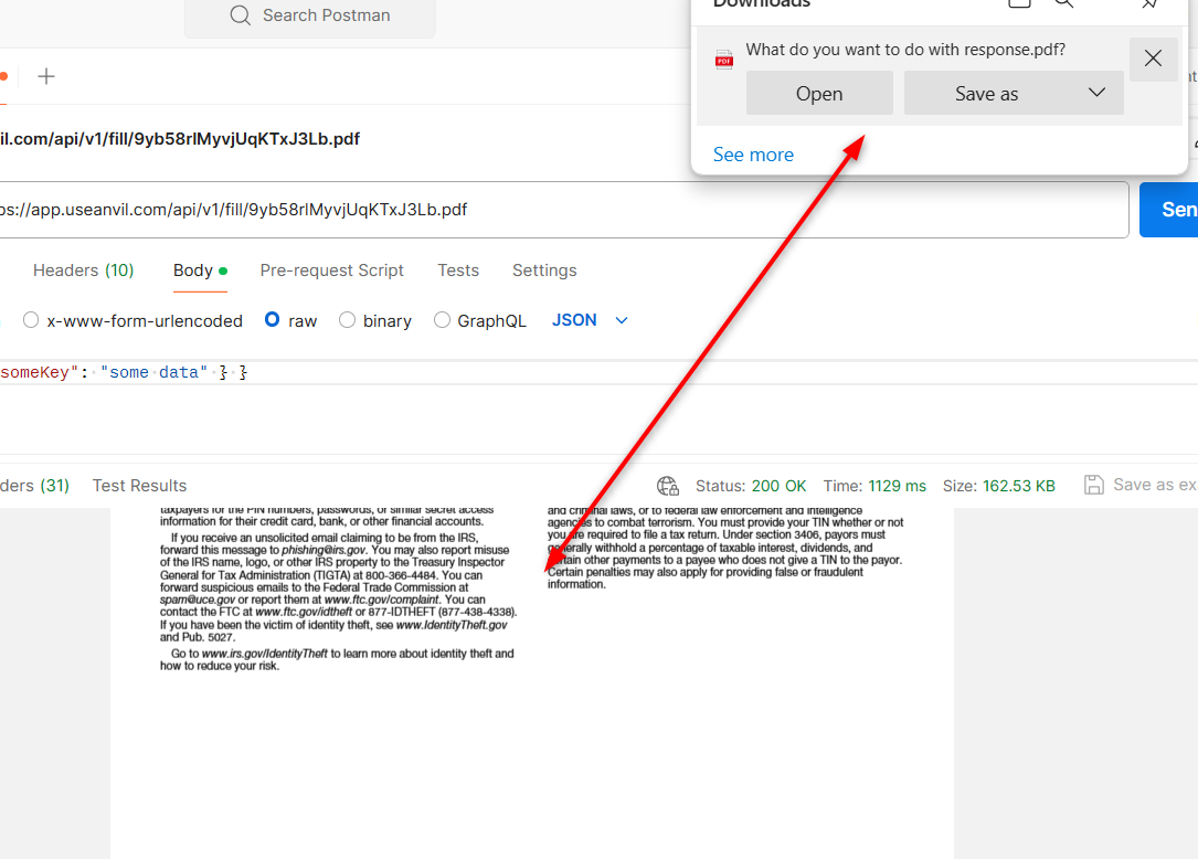

I am calling the end point below and I should receive the pdf as binary data :
https://www.useanvil.com/docs/api/fill-pdf/#:~:text=The%20response%20from%20the%20PDF%20fill%20endpoint%20will%20be%20binary%20PDF%20bytes.
It works fine with Postman or Zappier but I do not see what can be done to make it work with Pabbly as I receive a 200OK with a blank response.
Thanks for your help
I also tried the curl import feature but same result, it would be sad to use Zappier for that workflow
