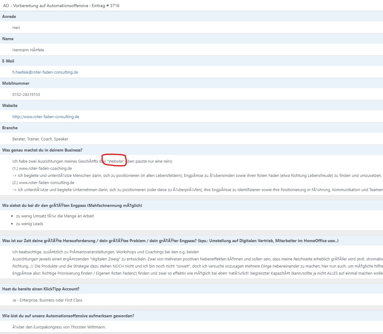

I want to transfer form subscriptions made in Gravity Forms to Google sheets. The Task is Working so far, but every time someone posts the sign " in a text field the transfer fails. Unfortuanelly the sign " is used quite often in german while explaining.
Therefore, is the a way to avoid Pabbly failing the transfer when in a textfield is the " sign?

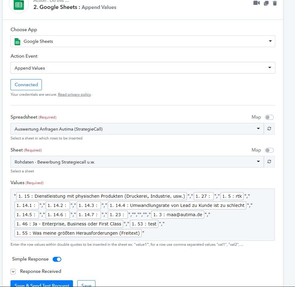

Thanks for the fast answer, I mean Google Sheets, not forms, you're right. The workflow I've attached as a picture below.

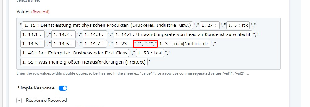

This is for the columns in which I don't want to insert data from this formular.
e.g. I want to insert some information in column 1 and 2, and then in 6 and 7, but wanna pass the columns 3-5 in between. That's why I don't send any data in these columns.
You said in your question that when you try to pass double quotes sign " in google sheet you get error, but I am not seeing any " sign in your mapped values.

This is the Task which could not pass in Pabbly. Later tasks worked all fine, as long as there is no " written in text. I can provoke the error, by just adding " in the text or removing it.

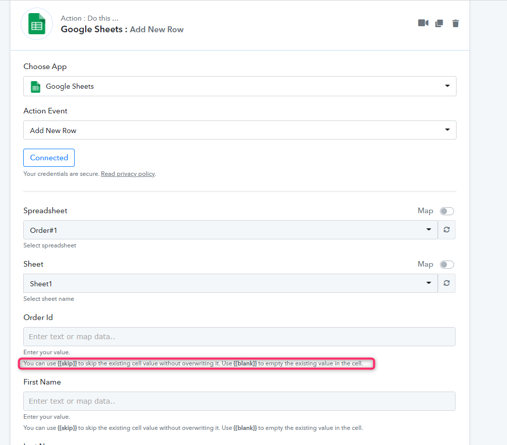

We looked into your concern and we would suggest you use the " Add Row" Action event of Google Sheets Action, which would be easier to set up and you won't be getting such an issue.
And to avoid the particular column you can simply use {{skip}} to skip the existing cell value without overwriting it. Use {{blank}} to empty the existing value in the cell.
