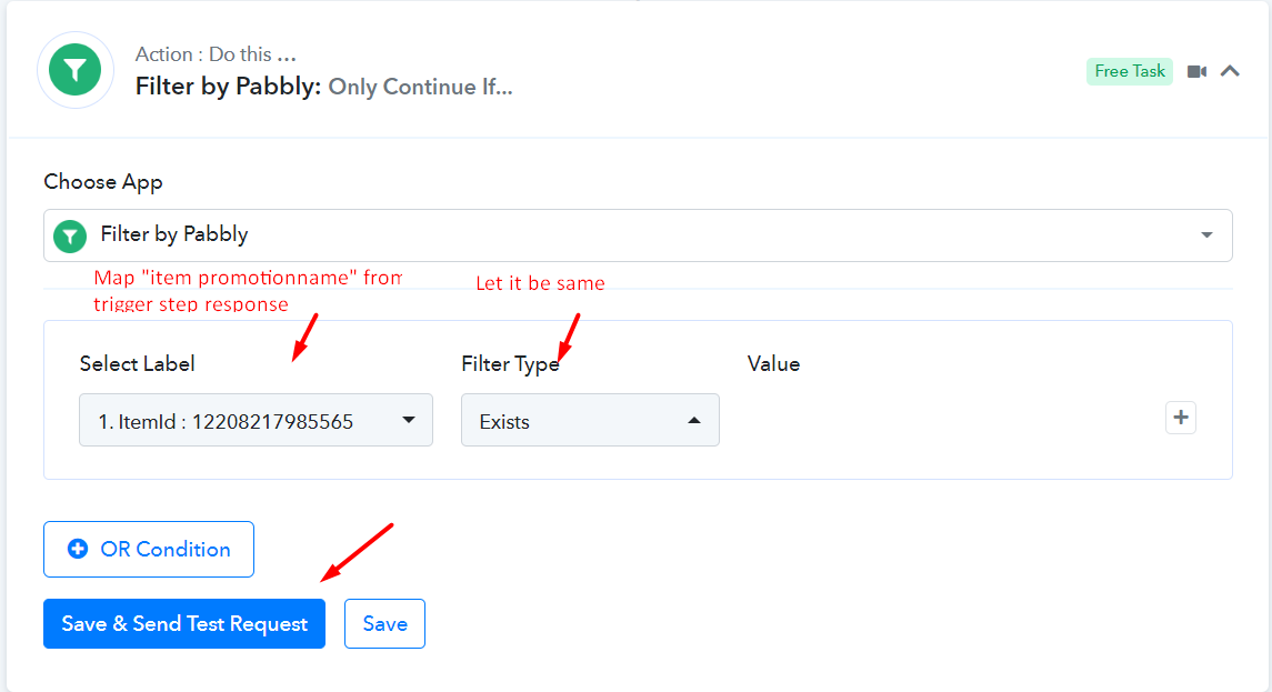

Kindly create two workflows where in the first workflow, you can collect the Booking with a promotion code from the Bookeo.
You just need to add a "Filter" step as shown below-
This workflow will allow on the promotion code data to flow further.

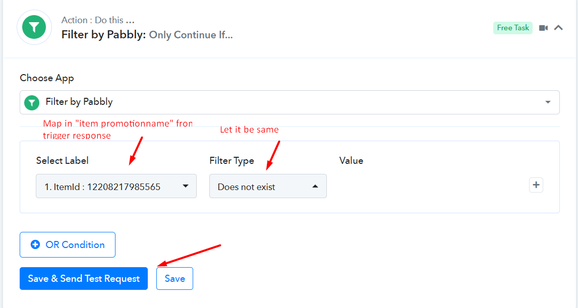

In the next workflow, you need to use the "Filter" step as mentioned below-
This filter will only allow the data which doesn't have the promotion field in it.
Through these two workflows, you won't get an issue.
