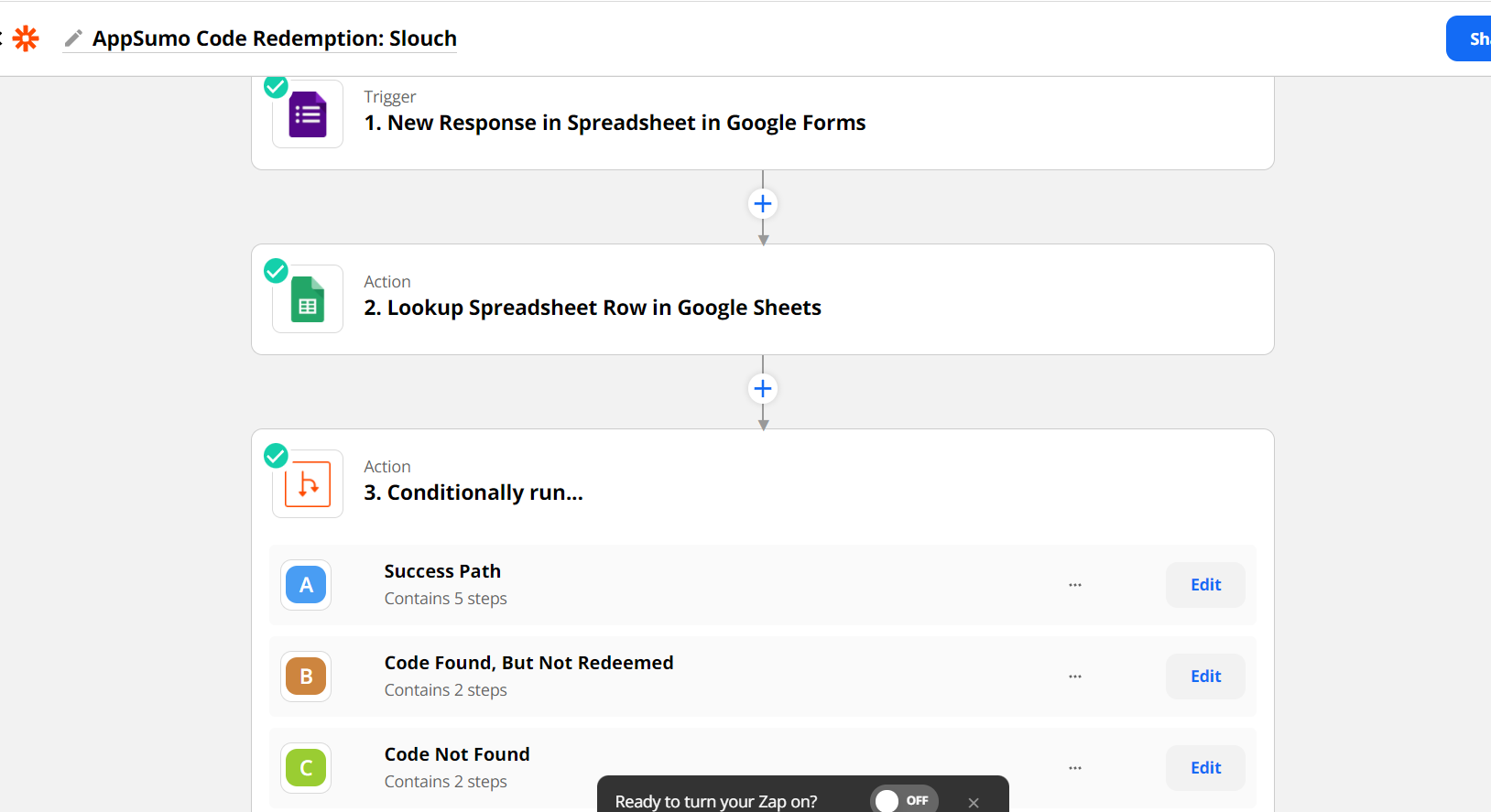

Does anyone know how to set up a Pabbly Connect for an AppSumo redemption flow? This is where after user submits a coupon code to google forms, the code is looked up in a Google sheet that has the list of acceptable codes, and then marks YES in a different column if the code is found. The sreenshot shows the basic steps in Zapier. I'm trying to reproduce this and get it to work. The conditionally run gives the 3 possible scenarios for the results of the code look up. If you can help, I can give more detailed screenshots.

You can do the same in Pabbly Connect as well very easily.
1. For google form as a trigger you need to setup a webhook URL in responses google sheet for that form. So it will send data to pabbly workflow when there is a new form submission. Here is a video for help -
2. Setup Google Sheet -> Lookup Row action. Here is similar type of video -
3. Insead of Path like zapier, pabbly has Routers. Which works the same as paths. More info here -
