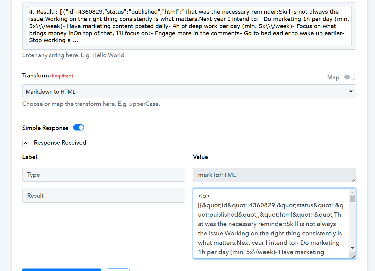

Apologies for the oversight. We have added a Text Formatter to your workflow to transform Markdown to HTML. Please check if that gives you the desired result.
hugohamelcom — Reply ·
I am confused as to why there's a need to add markdown to HTML, the API returns a JSON with an HTML value already, so the Text Transformer HTML to Markdown is normally fine. The issue happens when we do Array Reverse, if you look the HTML values in the JSON is fine before, then after the Array Reverse the HTML (all the `

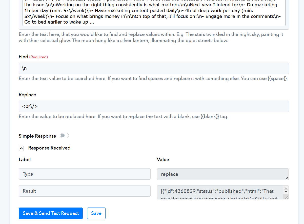

Our technical team is working on fixing the issue related to the
tags being removed in the Array Reverse action step. In the meantime, as a workaround, we have added a Text Formatter to your workflow to reinsert the
tags into the text.
