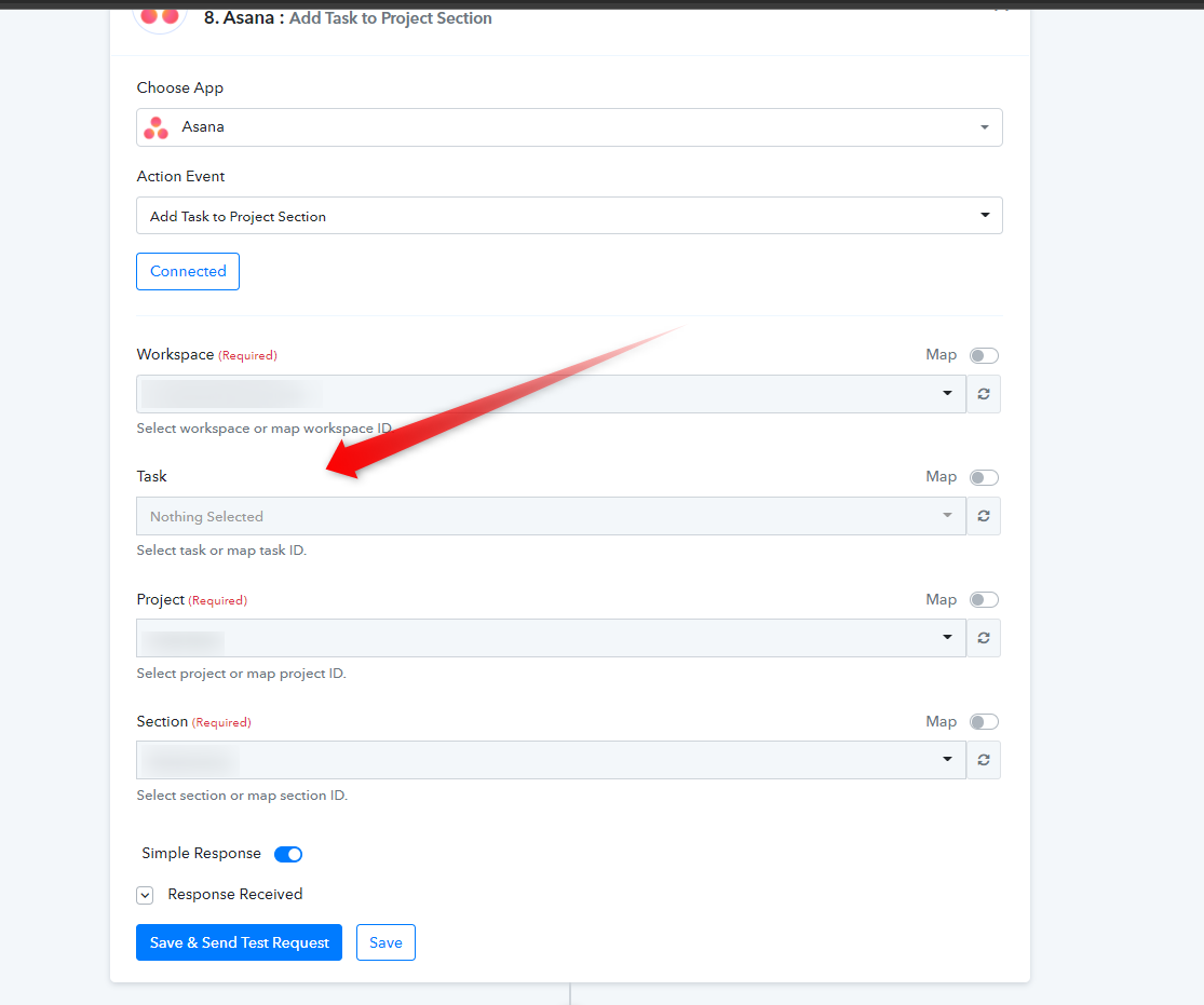

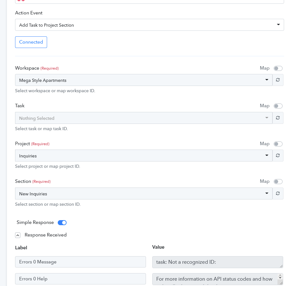

An Asana action "Add task to project section" tries to add a task and receives a response task: Not a recognized ID.
The section and the project is known, but the task is new, so how am I suppose to specify the ID of a task that hasn't been created yet?
Please assist?

Hey @msa
It seems like in the respective Workspace in your Asana there might not be any task present and because of that, the error message is coming.
Kindly make sure that there is a task present in your workspace to make this action step work.

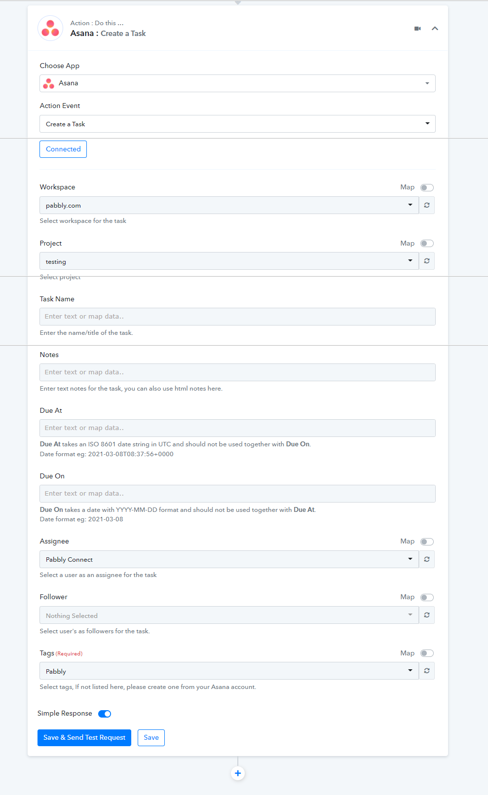

Hey @msa
If you are trying to add a task in Asana, you can use the "Asana: Create a Task" action event.

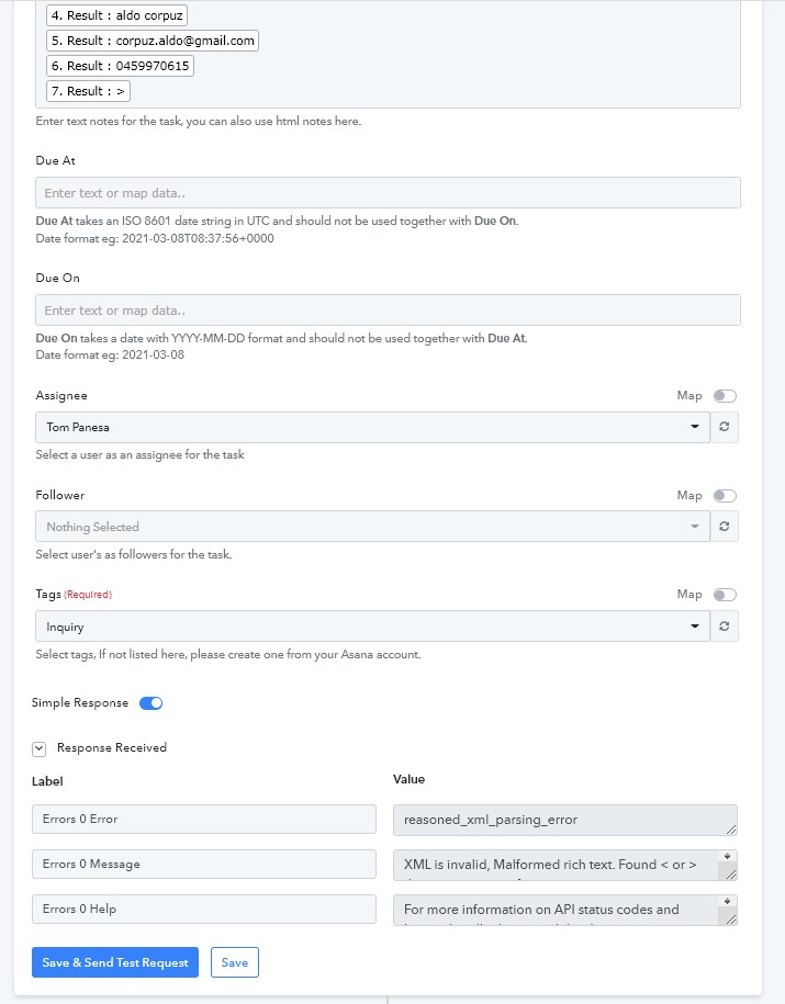

It seems like you didn't extract the comment from the content correctly and because of that, the ">" angular bracket is appearing which is not supported by the action event.
Though we have made a little change in your workflow and seems fine to us. Kindly review that in your workflow and let us know if that works for you.

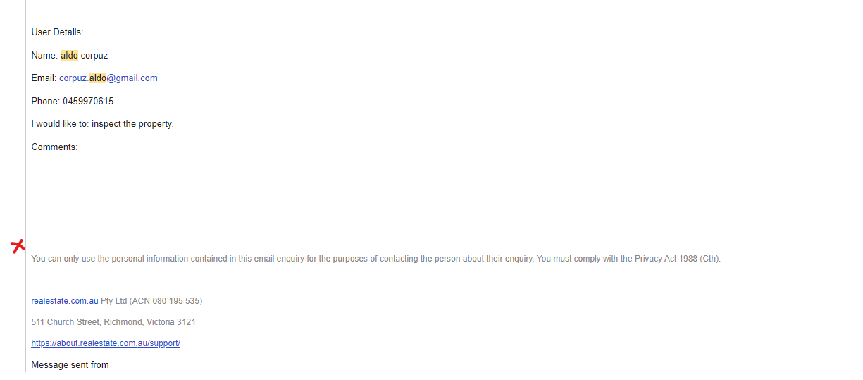

Thank you for fixing it! I would prefer nothing to be shown in the comments for this example, is it possible to look for anything before a new line?
