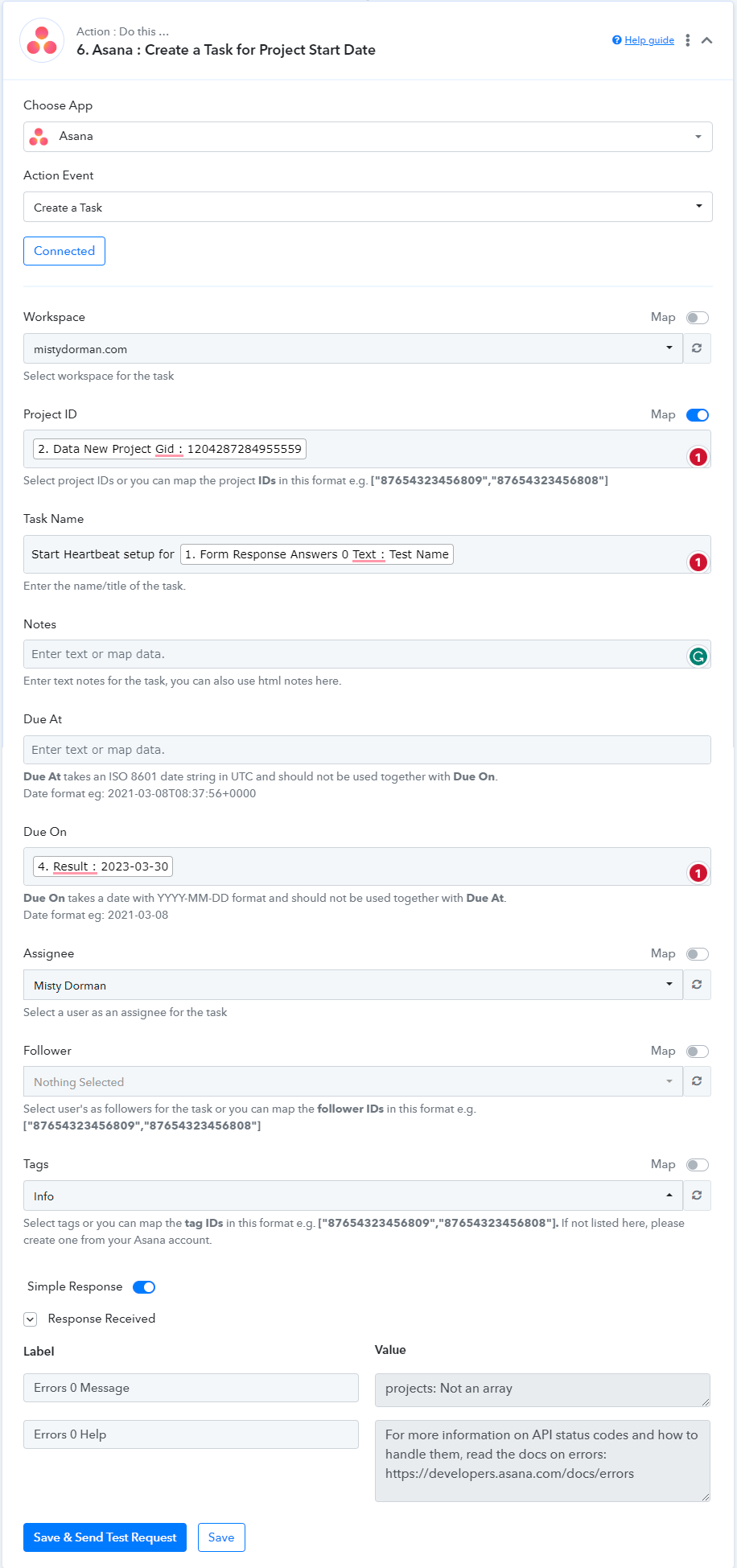

I'm getting error message "projects: not an array" on a "create a task" action. Here's a screenshot of the action. It's pulling project ID from a previous Asana action.

I'm not sure what you mean here. I pulled the project ID from a previous action. The previous action duplicates an existing project & then there was this "data new project gid" field from the results of that, which I assume is the project ID of the new project. Are you saying that's the wrong field to use? If so, which field should I use?
Misty

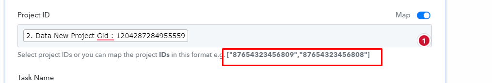

You are missing [" and "] around that mapped value.

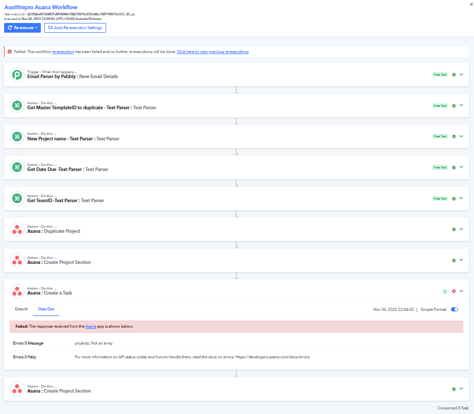

@Supreme, I have the exact issue as described by @lifeinjamisty when creating an Asana Workflow.
I have been able to get most workflow steps to work correctly apart from Create a Task. I have tried various ID variables but I keep getting the same error msg. Projects. Not an array. Yet, I can pass the same variable in the final step and create a Section in the project successfully? Not sure if you can provide some guidance as to what I am doing wrong.
I have added the [" variable id ]" but I get the same partial error?
Hey @Patrick.Hall
It seems that the configuration of the action step was not completed in a single attempt, which resulted in an inaccurate passage of the previously configured project ID.
We have taken the necessary steps to rectify this issue, and it now appears to be functioning as expected. We kindly request that you review the configuration to ensure it is satisfactory and inform us of any further adjustments needed.
