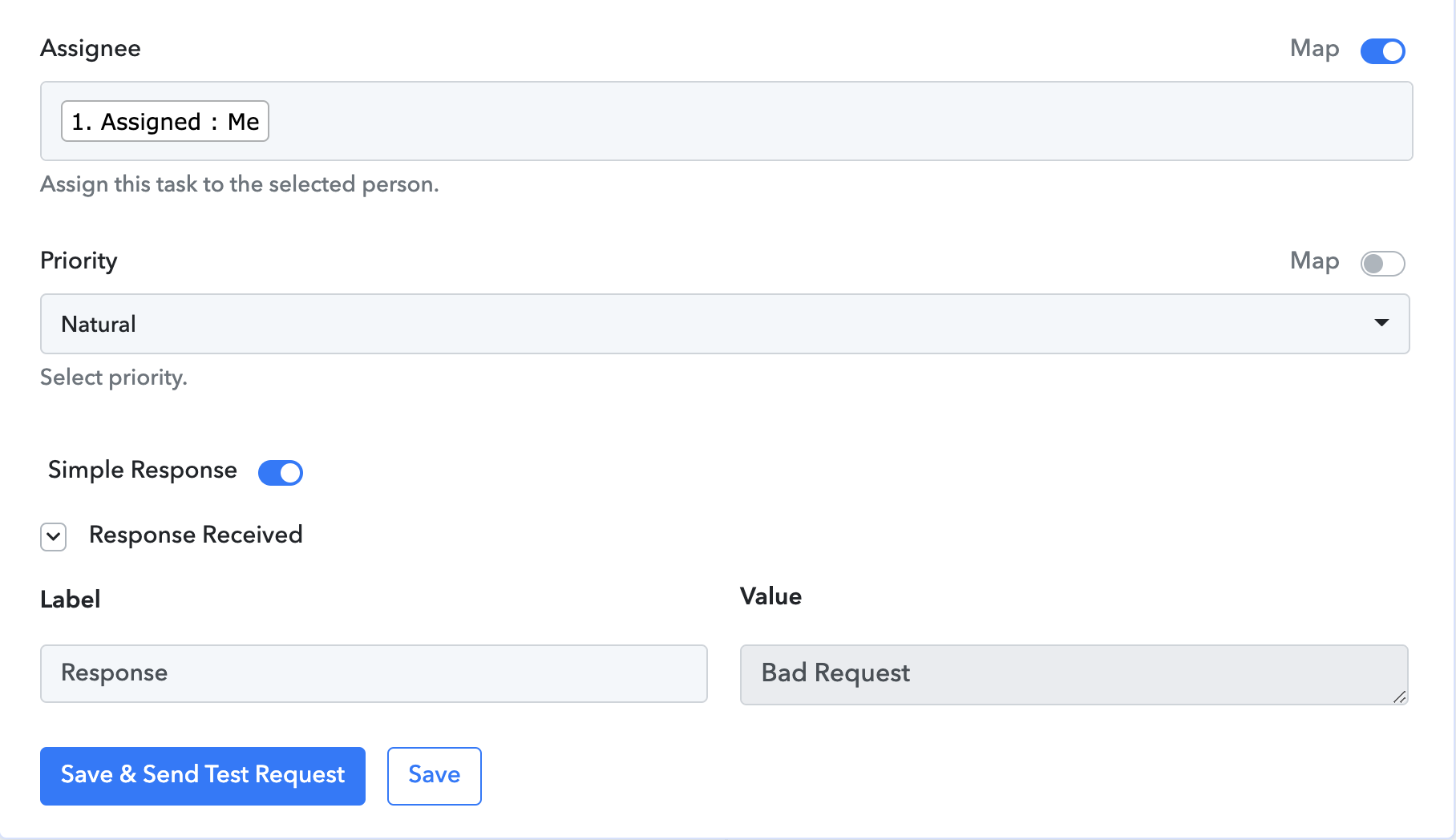

When I try to identify the assignee of the task with the data pulled from the google sheet I have set up I get an error. If I opt not to select an assignee it works fine. I am not sure what I am doing wrong but I would like to be able to create the task and assign it with the data being pulled in from the google sheet.

I did that but get a "Bad Request" value when I try to test it. If I remove the Assignee all together then it works...

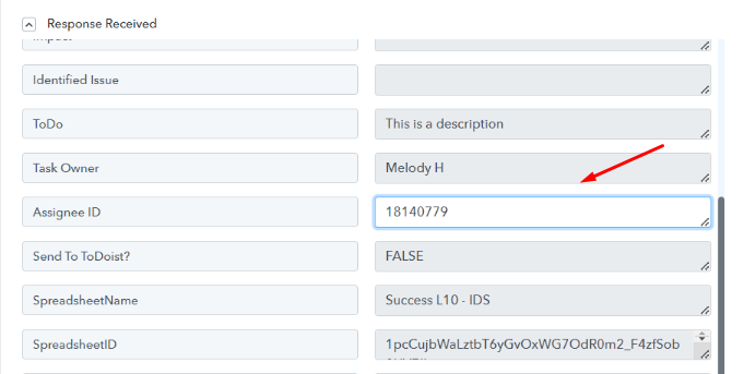

This is helpful! Would you happen to know how I can obtain my ID and the IDs of people who are on a shared task list with me?

When checking upon your workflow, we could see that you were able to pass the Assignee ID, which was exactly how it was to be done as a workaround-
You can now check on the workflow by adding the Assignee ID and rest of the data in the Google Sheet and check if the workflow is working or not.
Also, just a suggesttion for you on how you can get the ID's-
Switch on the map button for the Assignee ID you need to get as show below-
For instance, you need the assignee ID for the below email-
Then click on the map button and you can see its ID-
Or secondly, if you can get the Assignee ID's in your Todoist account.
Hope, this workaround works for you.
