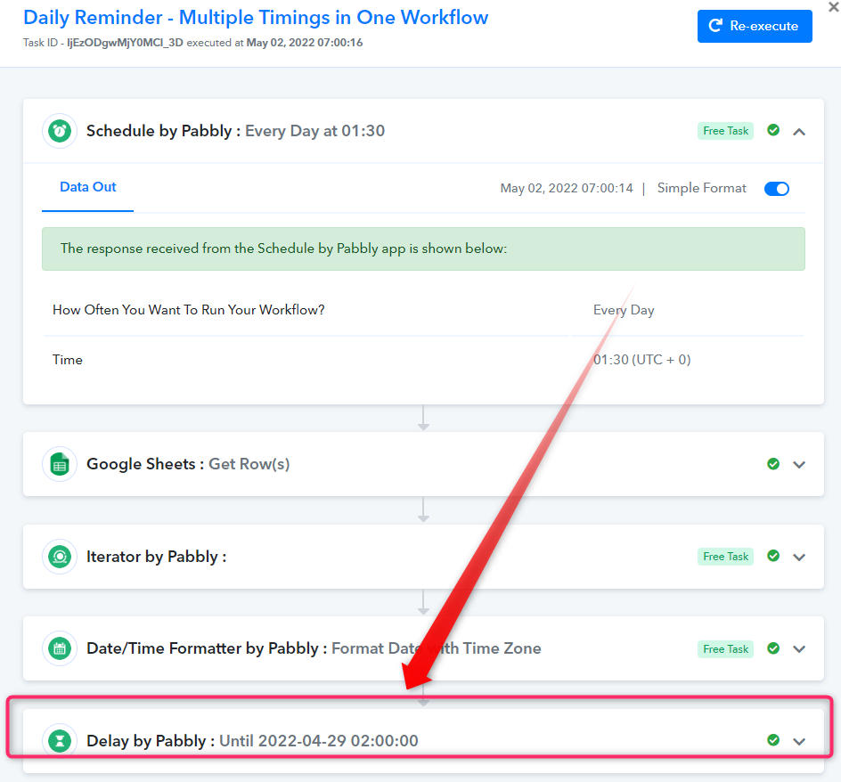

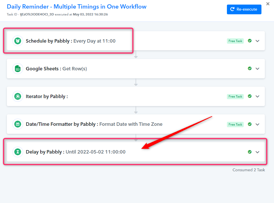

Hey @zest83
The respective workflow is triggered at the exact time but you are using the old date in the Delay Until action step, so because of that your workflow didn't execute.
Kindly check the data accordingly before using the workflow.

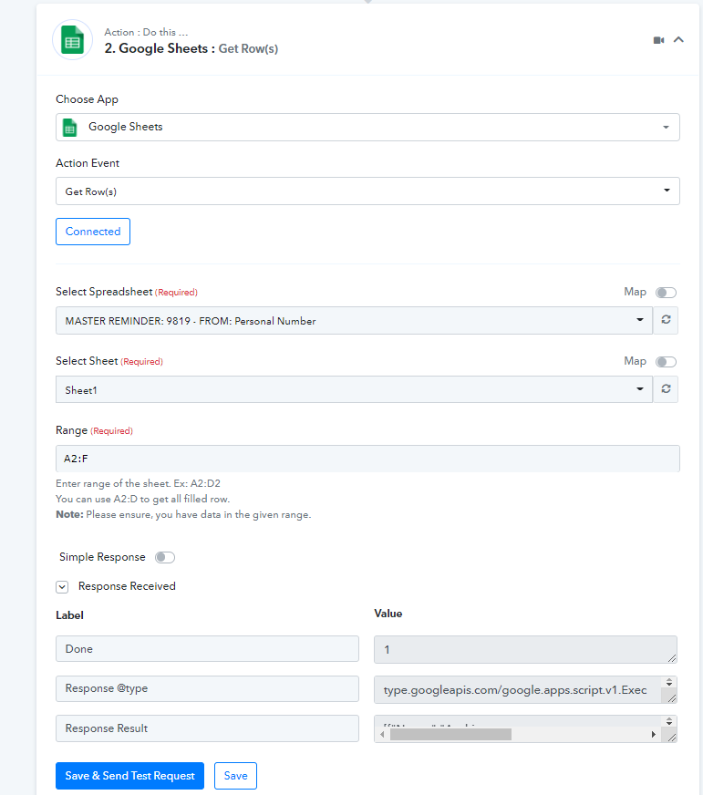

Please could you check the workflow and the Google sheet
I have made the google sheet public - Easy to check!
https://docs.google.com/spreadsheets/d/1d7sVDR4rGWX9GmcPj8fAKXdx04p9oFu7hVR9Y_aeLuA/edit?usp=sharing

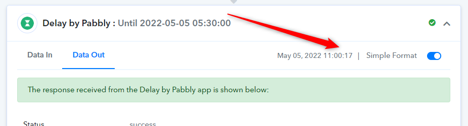

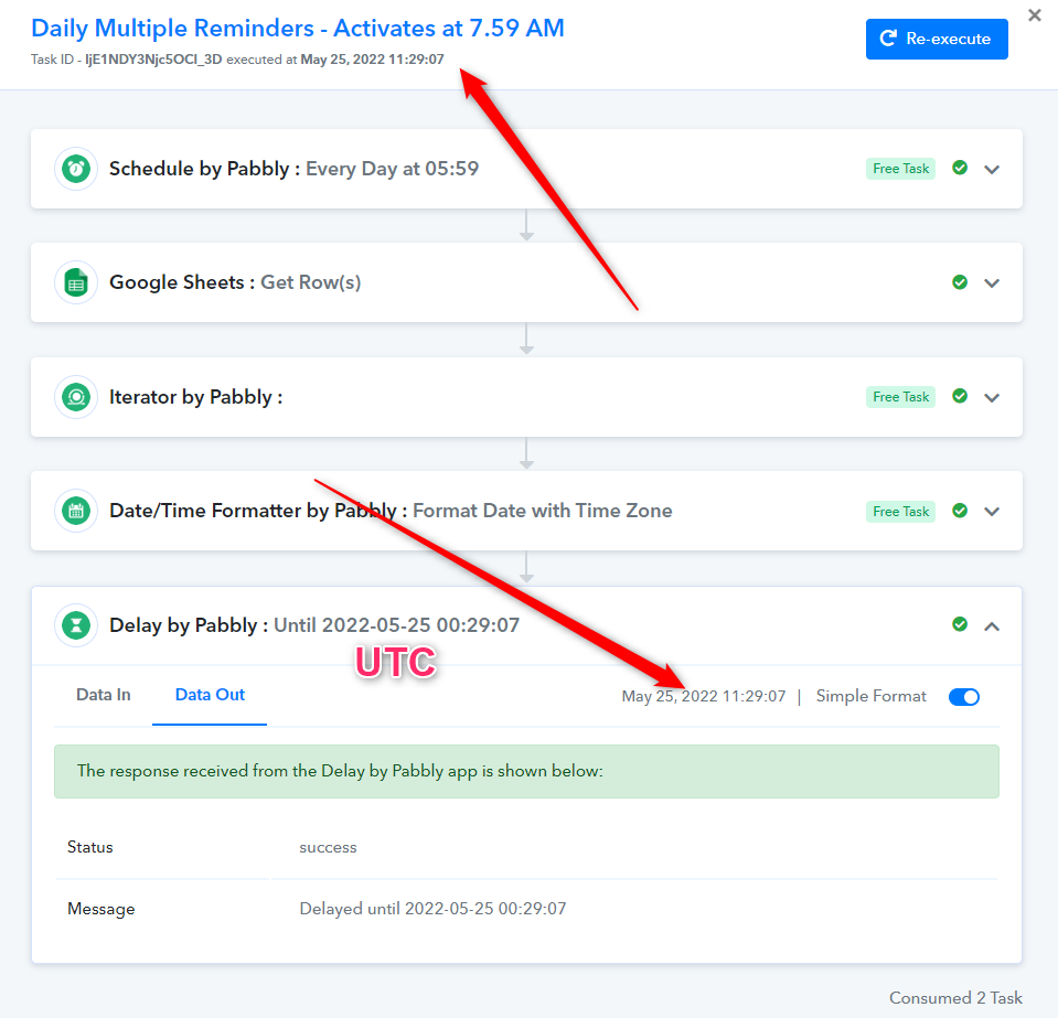

Hey @zest83
Since we have already mentioned you to pass the DateTime in the Delay action step in the future, as you are again passing the date which is a few hours old.
Note - Delay Until action step takes UTC date-time. Kindly convert it first then try to match the timing in the task history.

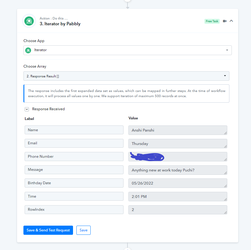

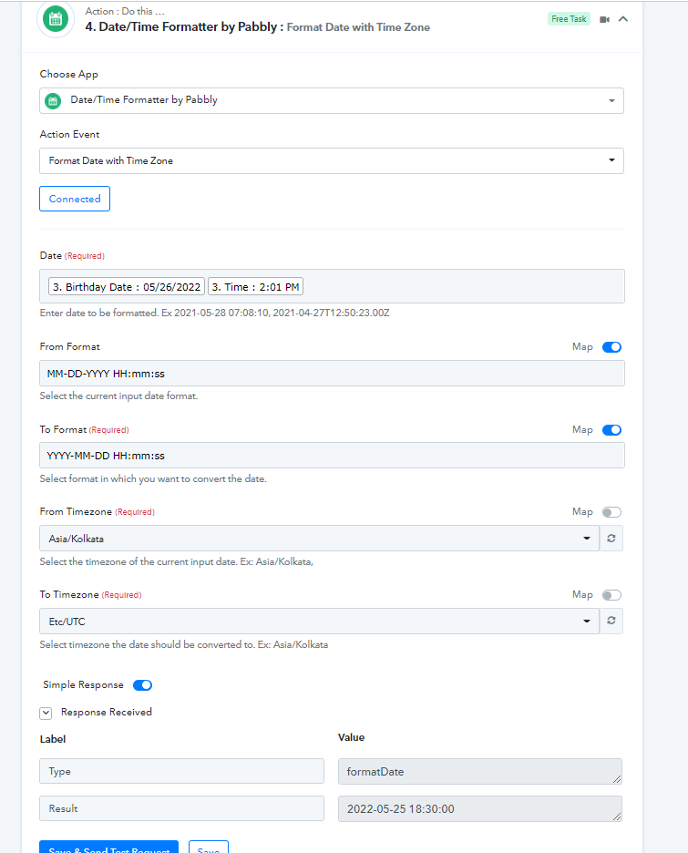

Next Trigger is at 2.01 PM IST 26th May 2022
I have PUT screenshots for EACH Step here!

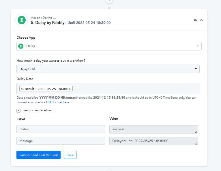

When I RUN a SEND & Test ... It is giving me a Date of 2022-05-25 18:30:00 (ON Step 4) - inspite of the Date being 26th May with Time 2:01 PM on my google sheet

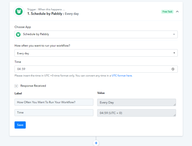

The Scheduler has been set to 4.59 AM UTC
So what next?

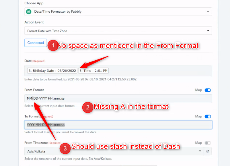

Hey @zest83
As we can see from your workflow, you haven't passed the date-time in the incorrect format and because of that, you were not getting the appropriate DateTime.
Kindly read the help text correct and pass the date-time as per the "From Format".

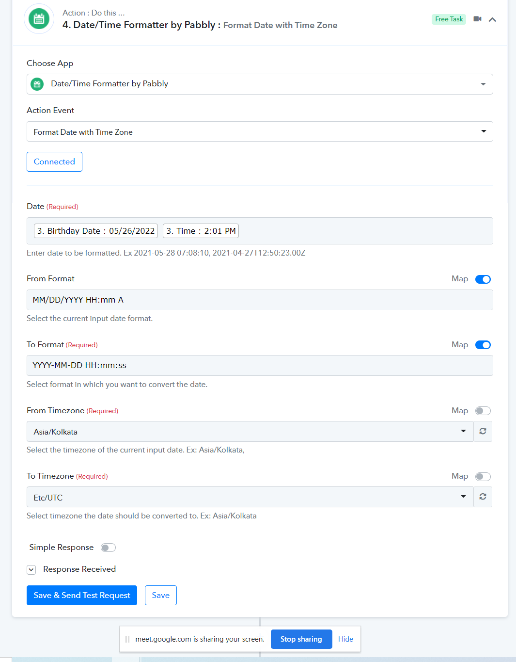

After correction -
thank you for making the corrections and helping resolve this!
