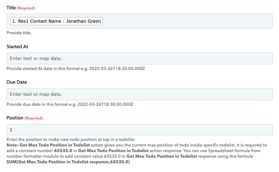

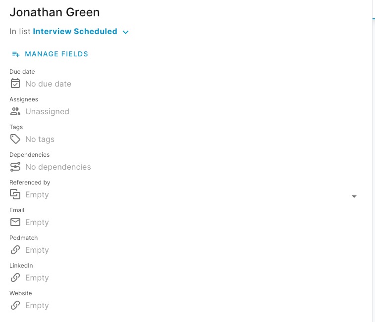

I have my Blue integration working and I'm using the option Create Record (The Create ToDo shown in the support video doesn't appear in my options)
I only have the options of title, Start Date, End Date and List Position.
I don't see any custom field options.
What did I do wrong?

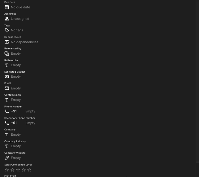

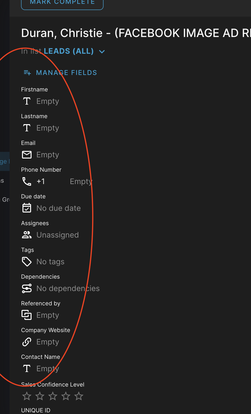

Hello. Can you please let me know if the review team will be adding more custom fields please? it makes the Blue PM system useless or makes us use Zapier for Blue and want to use Pabbly connect all day please. Please see attachment. Even the 5 basisc - Firstname, Lastname, Email, Phone and Address would work

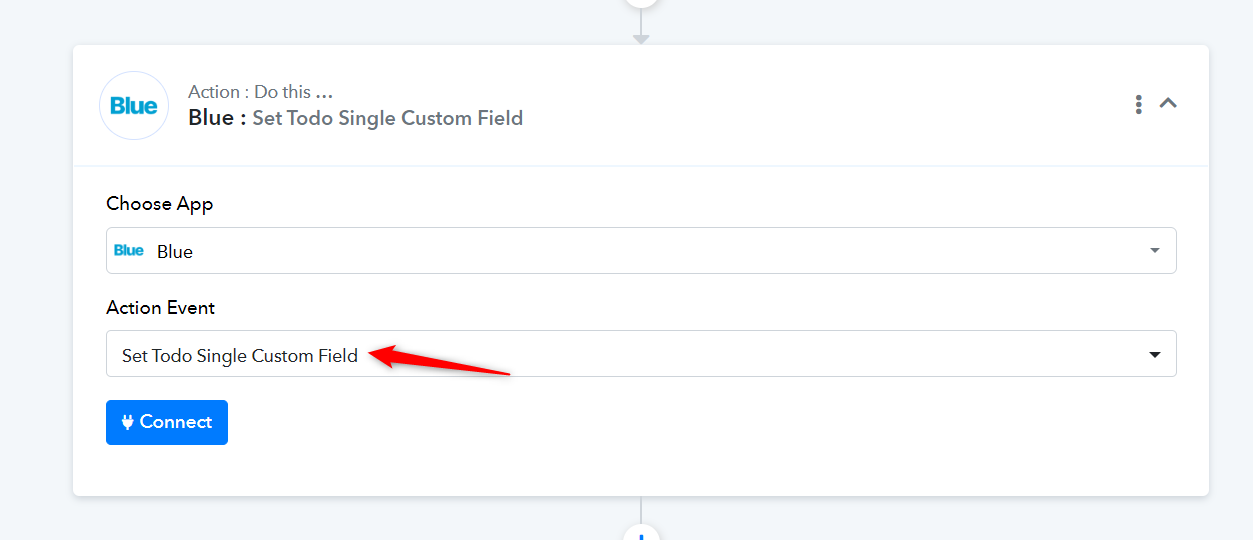

Hey @DocApply @JonathanDragonDJ
We already have the "Set todo custom field" action step, which you can use. Please note that only one custom field can be updated per action.
DocApply — Reply ·
Can you elaborate how we can use what you stated with my request please?
You need to use one "Set Todo Single Custom Field" action step to update a single custom field. So, if you need to update 5 custom fields, you will need to add 5 "Set Todo Single Custom Field" action steps to your workflow, each for updating a different custom field.

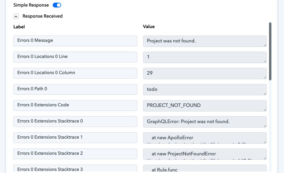

Can you elaborate this? As far as I got, we have to run "Get todo custom fields" first and then map it with "Set todo single custom field", It will consume hell lot of tasks for a single record update. I didn't understand why you structured it like this? It should be like whole record (all custom fields) updated in single step.
Apart from this the "Get todo custom fields" action has errors, throwing "project was not found" error everytime.
imsaini — Reply ·
Please check attached screenshot of error,

Sorry for the misunderstanding, you can check this ss of blue, custom fields.
Hello @imsaini
Thank you for sharing the screenshot. However, it does not provide the complete context, as it only shows the field names but not the project and the to-do list under which they are located.
To better understand the issue and assist you effectively, we kindly request a short screen recording that clearly shows the custom fields along with the associated project and to-do list. Without this, it will be challenging for us to provide accurate support.
We appreciate your cooperation and look forward to your response.

This issue of error occurs because in Blue, everytime you create a connection, you need to specify the company name and project name . Unlike other apps where if we establish connection, it works seamlessly, in case of blue, for each project there should be a different connection. So while testing, if you created a project A, established connection and then you deleted Project A and created project B , then the connection you used for Project A will not work for Project B. For project B, you need to create connection once again and while establishing the connection itself you should specify the project name. I found this hardway. So putting here as comment so that it can be referred by others as well as myself in the future.

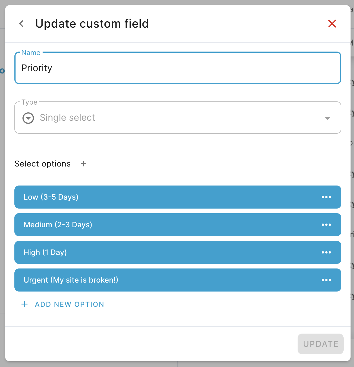

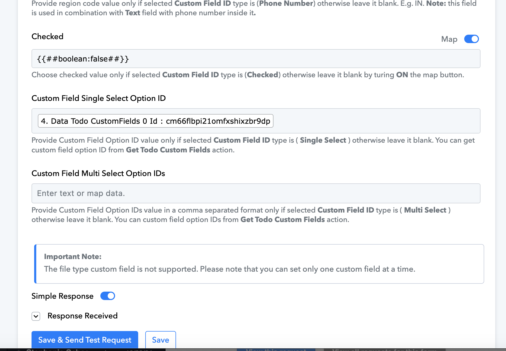

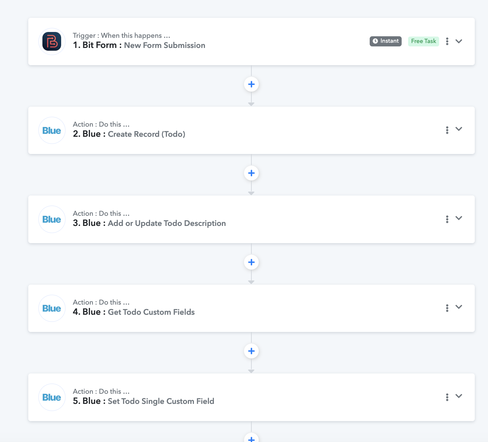

Bitform - Blue Custom Fields
I'm really close to getting this work but need another set of eyes. I have the integration from Bitform to Blue set up.
I am pulling the custom field with the step "Get Todo Custom Fields".
But the last step of actually assigning the custom field is where I'm stumped. Set ToDo Single Custom Field
I am using the Custom Field Single Select Option ID.
The custom field is called Priority and there are four options to select.
When I select the ID and test it - the record in Blue updates the Priority Field but it updates based on what I selected - not what the user selects.
Here's a video showing my process / steps.
What do I need to select or what steps do I need to add to update the Priority of the Record to what the user who filled out the form actually selected?
Sorry to barge in your thread. I too am a user like you facing integration issues with Blue and during my research found your thread. Thank you for making your thread public so that people like me can benefit.
Having said above, i want to ask you when you can directly use "Set ToDo Single Custom field", why would you need "GetToDo custom field"? If the input that you are trying to push from bitfom to blue is just a single field called "Priority", it can be directly done by "Set ToDo Single Custom field" without needing "Get ToDo custom field". After that whether you fill the bitform or the user fills the bitform, it does not matter for pabbly. The data that is in "Priority" field of bitform should automatically go to the "Priority" field of Blue.
jkriggs — Reply ·
My understanding is that you have to "Get" the custom field ID first and then you can "Set" it.

Could you make it work? Isn't blue integration too complicated? I am facing issues at "Position" field in "Create ToDo records"
jkriggs — Reply ·
