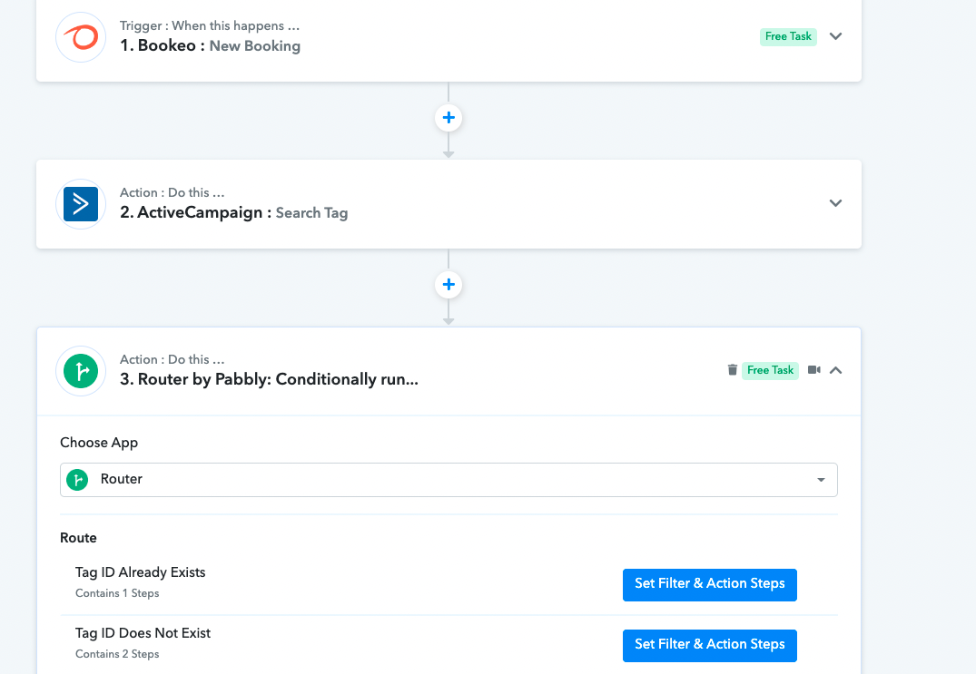

I have a workflow set up pushing data from Bookeo bookings to ActiveCampaign.
Once a booking is made, the contact should be pushed to ActiveCampaign and tagged with the purchase they made.

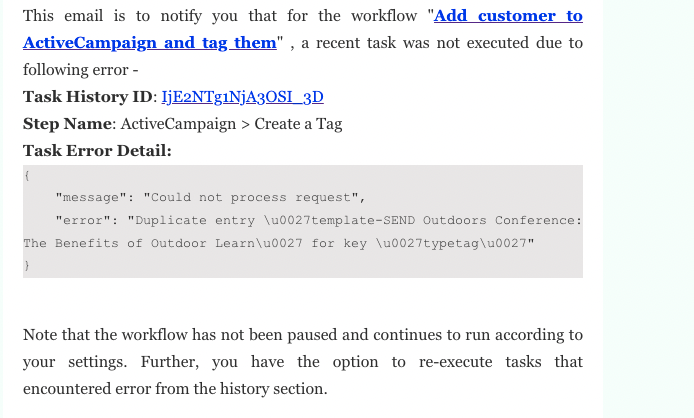

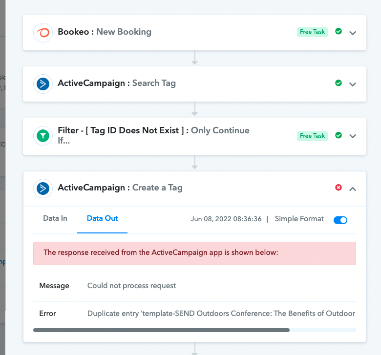

Somebody from Pabbly helped me set this workflow up a few months ago but there are a lot of errors in the workflow history.
We have recently upgraded our account to a paid premium version so that we can use more tasks.
See below example
The contact has been pushed through to ActiveCampaign but they have not been tagged.
Please can somebody advise?

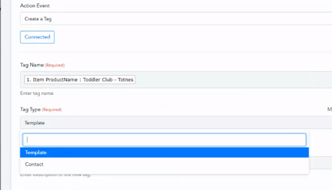

Hey @George231
As we can see from your workflow, you have selected the Tag type as Template, kindly change the type as Contact to add a tag to a contact.
Please try after the change and let us know if you get stuck at any step.
