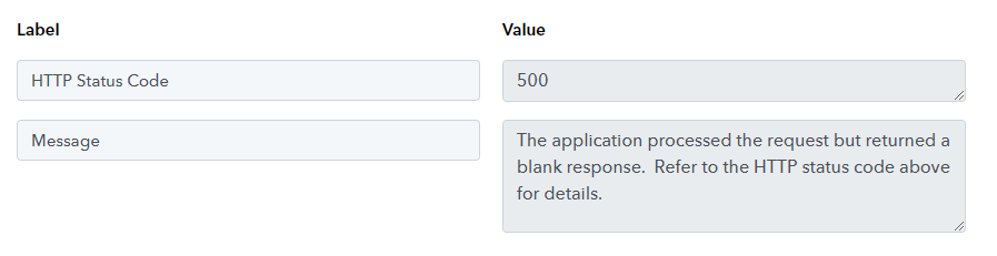

Hi there, I have set up an automation to auto post blogs ('Post-Standard' in BD) as a Google Business Listing Update - have followed the Pabbly You Tube video. Trigger capturing blog, filter ensuring blog is published (status 3) both working - publishing to Google not working and receiving an error code 500 - screenshot below.
Any ideas to help me? Thanks!

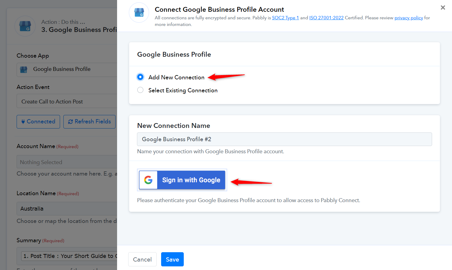

As you can see in the video shared above, the Account Name and Location Name fields are automatically listed when you create a new connection with the GMB account. However, based on the workflow you have shared, we can see that both of these fields are empty (you cannot map random data to these fields).
Please log in to your GMB and Pabbly Connect accounts in an Incognito Tab, establish a new connection with your GMB account, and see if that fixes your issue.
Anna Shannon — Reply ·
Thank you! Yes that worked! And I was able to see it posted.

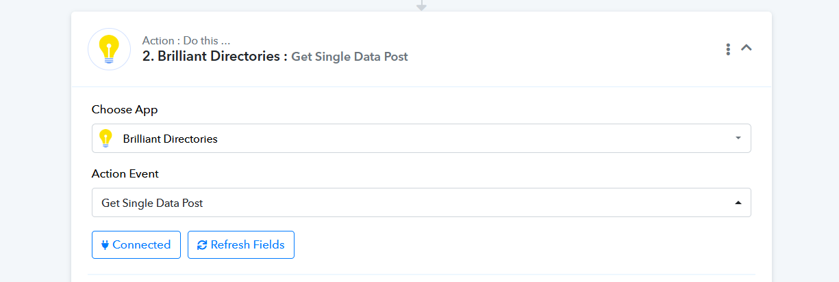

Also, it would be great to have the Meta Description appear in the post on Google, but its not pulling through from BD even though I have that data in the blog. Any ideas?
Hey @ms_akasha
Please use the 'Get Single Data Post' action step, which will retrieve the full details of a Post using the Post ID. Give it a try and inform us if it meets your needs.
