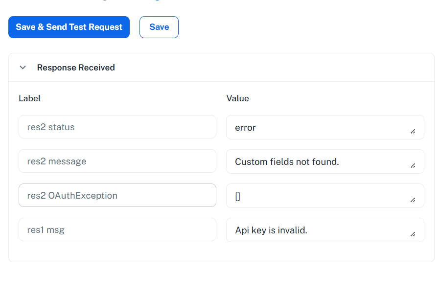

I want to create a process where when someone signs up to be a member in the directory, it is added to my Go High Level account. But I keep getting an error message.
Not sure what the problem is, and not sure where those values

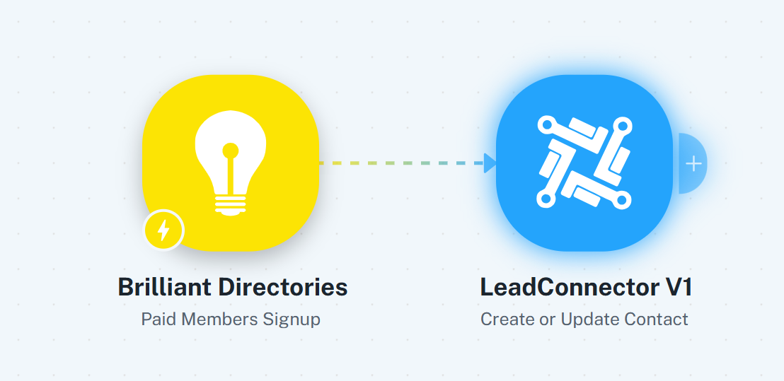

Upon reviewing your concern, it appears that you are currently using the LeadConnector V1 connection, which is likely causing the “Invalid API Key” error.
We recommend switching to the LeadConnector V2 application, as it is the updated version and more reliable for integrations with Go High Level.
Additionally, while connecting your GHL account, please ensure that you select the correct sub-account under which you intend to create or update the contact. This is important for the workflow to function as expected.
Kindly update the connection accordingly and test the workflow again. Let us know if you continue to face any issues, and we will be happy to assist you further.

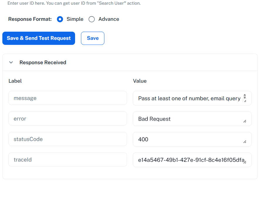

I have updated to LeadConnector V2 I selected the correct sub-account and I am getting this response

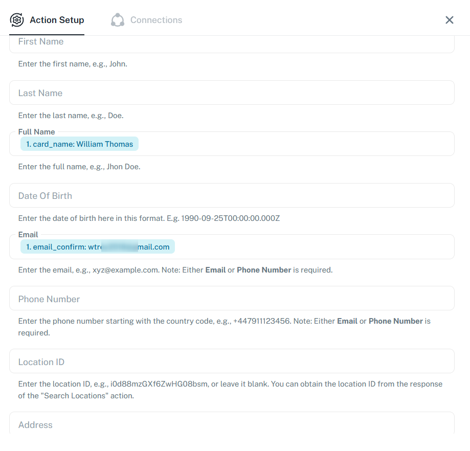

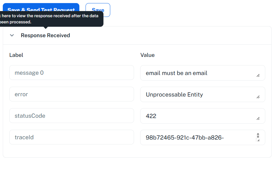

upon going through the forum I see you prefer we use Create or Update contact form so switched to that and got this error code
I dont understand what it means. Am I missing a place that walks through how to fill out each type of form?
The error you encountered occurs when you do not pass an email address or phone number in the LeadConnector V2: Create or Update a Contact action step. Please note that you need to provide data in at least one of these two fields. We have mapped the email address from the trigger step on your behalf, and it appears to have resolved the issue.
