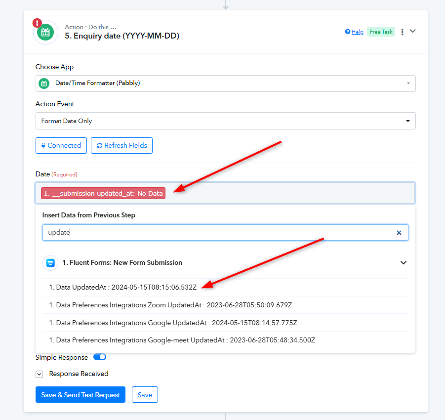

Upon looking into your issue it appears that your workflows executed multiple times because the 're-execution' option was enabled for three iterations. Also, re-execution happens for failed steps only, and the errors in your workflow is dur to incorrect mapping.
Specifically, "Enquiry Date" step is not mapped properly. We would suggest you to map "Date UpdatedAt" response, instead of "submission updated_at".
We recommend a few steps for smoother workflow execution:
1. Please turn off re-execution for your workflows.
2. Disable "Ignore Error" for the steps where it is enabled.
3. Make a test entry and ensure all fields are properly mapped.
Additionally, we have restored your tasks for now. Let us know if you encounter any issues afterward.
