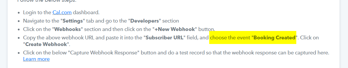

Situation: Lead books via Cal.com, Trigger Event: Booking Created. Everything works perfectly.
Issue: When lead cancels booking, same "Booking Created" automation goes off.
Other Notes: No other integrations with cal.com in my workflow. Just one. It seems to fire off whether it is a new booking or a cancelled booking. Haven't tested a reschedule event yet.

It seems that while setting up your trigger step, you chose more than one trigger event. You were supposed to select only the 'Booking Created' event.
Anyway, for now, we have added a filter as step 2 of your workflow. So, even if the workflow is triggered for more events, the next steps of your workflow will only be executed if the trigger event is 'Booking Created'.
7alan — Reply ·
Thank you for your assistance. We have Booking Created selected on both the Pabbly & the Cal.com side so I'm going to rely on using the filters for future workflows. Thanks again!!
