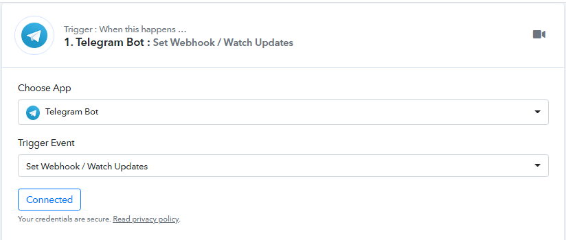

You need to use Trigger as "Telegram Bot:Set Webhook/Watch Updates"
Connect it with your Telegram account.
Then, Click on "Save & Send Test Request" button.

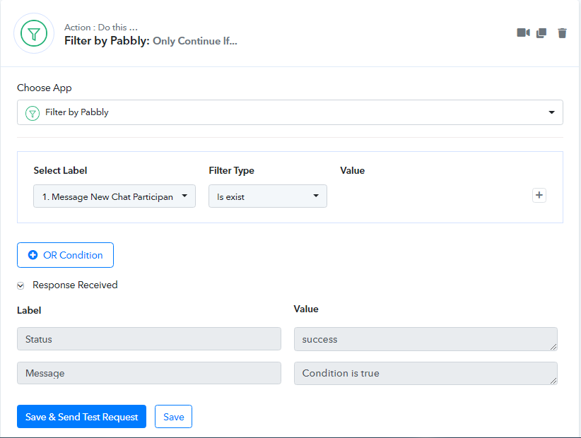

Now use the next step as "Filter by Pabbly Module"and Select Label as
And then use Filter Type as "Is exist".
Now do "Save & Send Test Request".
