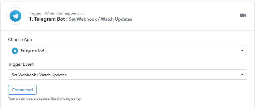

You need to use Trigger as "Telegram Bot:Set Webhook/Watch Updates"
Connect it with your Telegram account.
Then, Click on "Save & Send Test Request" button.
You can see that the Webhook Response shows spinning.

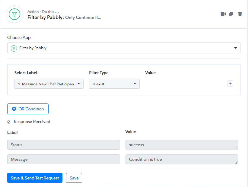

Now use the next step as "Filter by Pabbly Module"and Select Label as
And then use Filter Type as "Is exist".
Now do "Save & Send Test Request".
