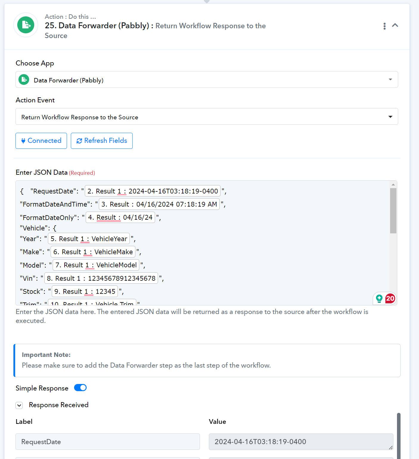

- Step 3: Data Forward "Return Workflow Response to Source" (Workflow A)

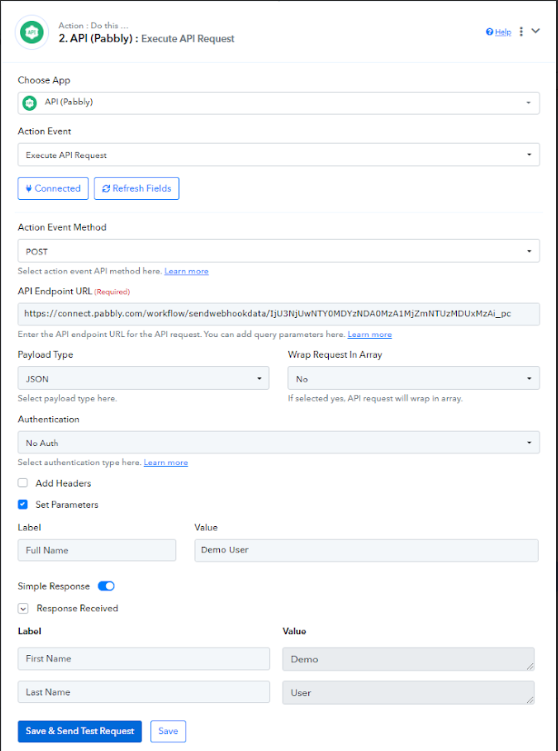

Kindly use the API by Pabbly step in the 1st workflow to send data to the second workflow-

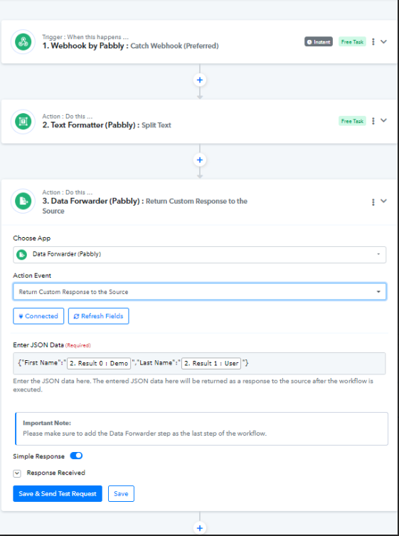

In the second workflow use the last step as shown below to received source in the first workflow-
This should work for you.

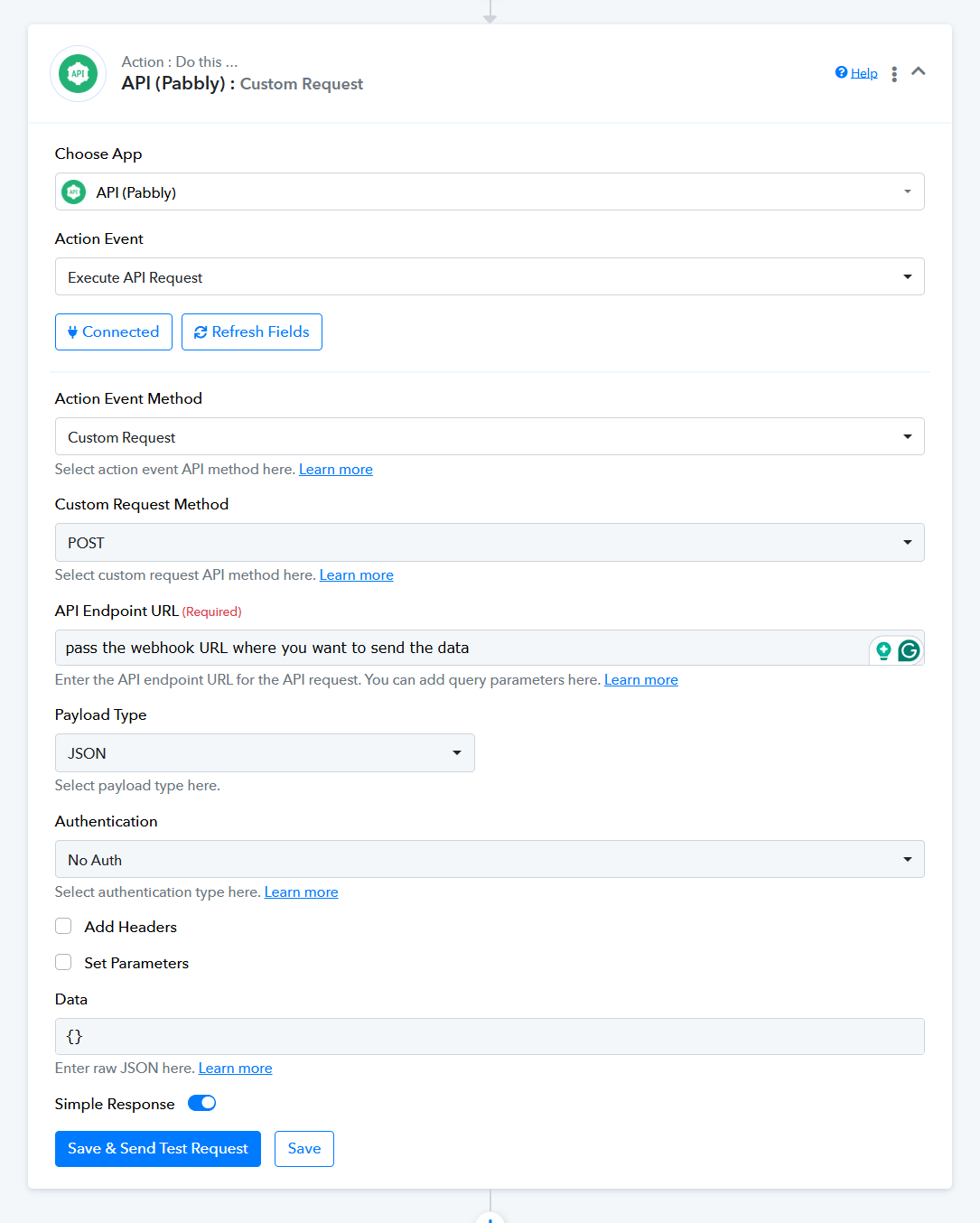

I see. I used the API in workflow 1 and was able to send the data to Workflow 2.
Workflow 2 is executed and the end i added the "Return Custom Response to the Source".
Now im lost on where the data goes when its returned. Where in Workflow 1 do i see or get the response from Workflow 2?

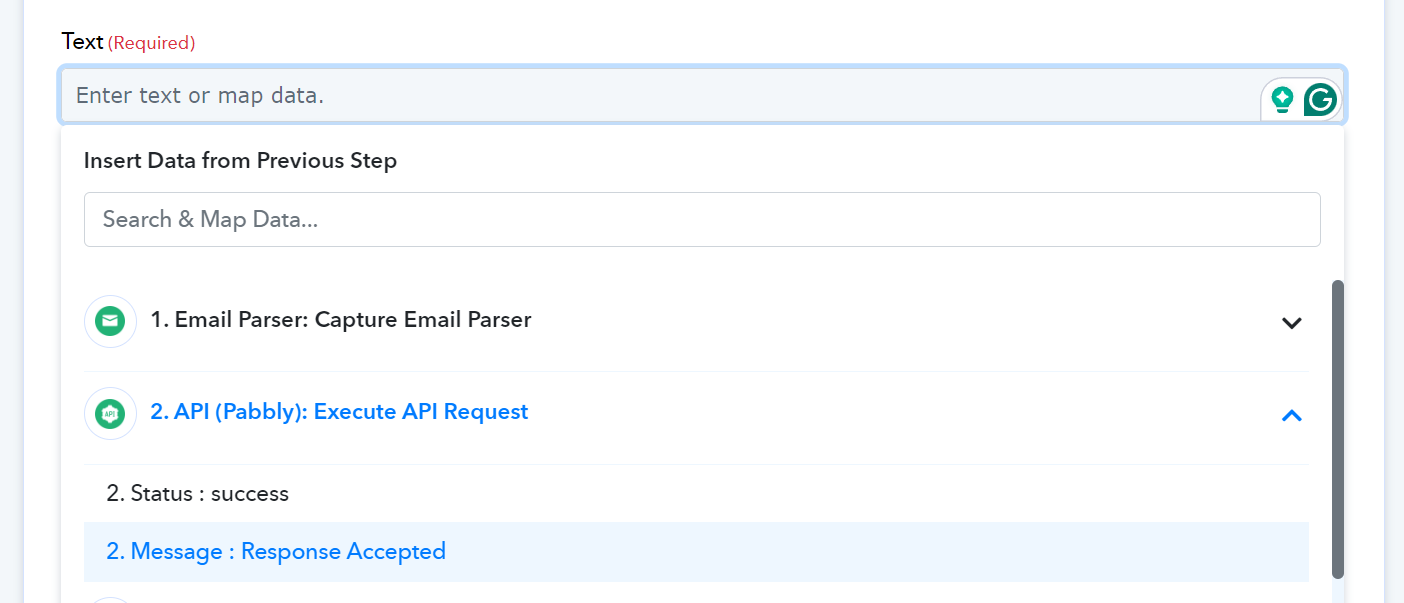

Automated Marketer — Reply ·
Back in Workflow A after Workflow B (Send back to Source) is completed, simply shows "Success" and "Accepted" but nothing regarding the response from Workflow B Source Return.
