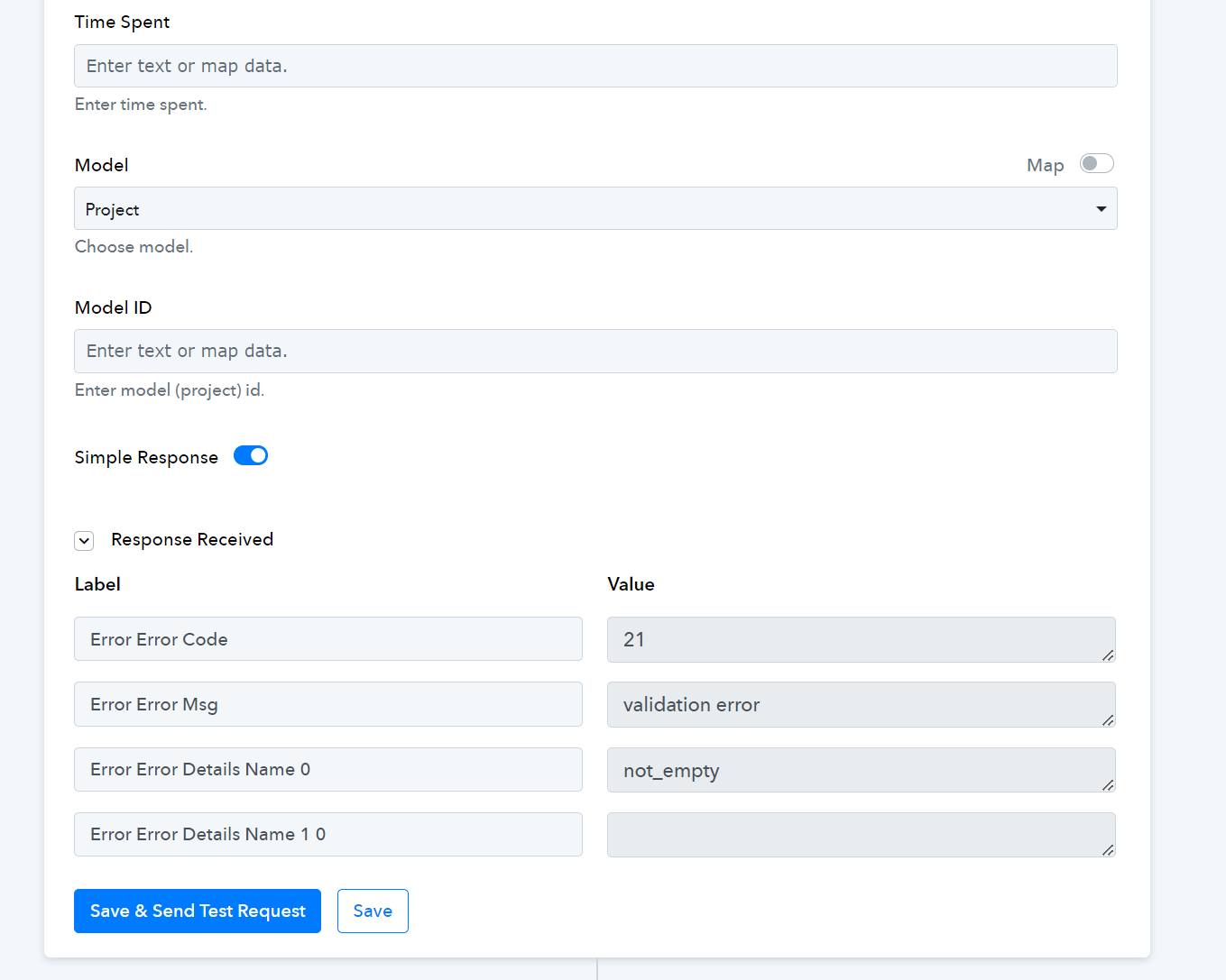

Hi team, I want to create a task after a form submission, but in the drop downs, I can't select a project or anything else.
I guess the issue is the missing Model ID. What is the format and how do I find it?

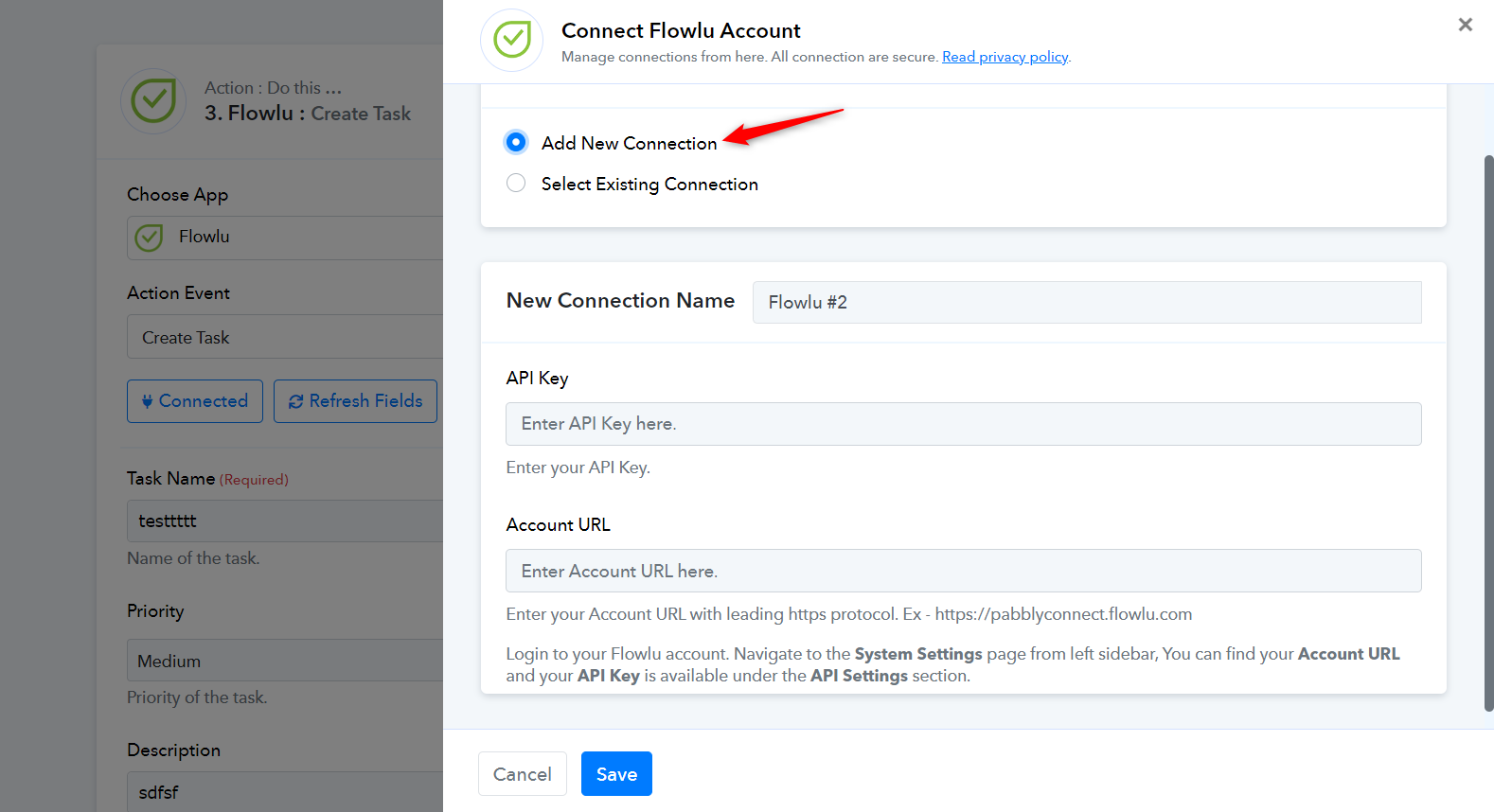

Please follow the steps provided in the video below to establish a connection with your Flowlu account and see if this resolves the issue for you.

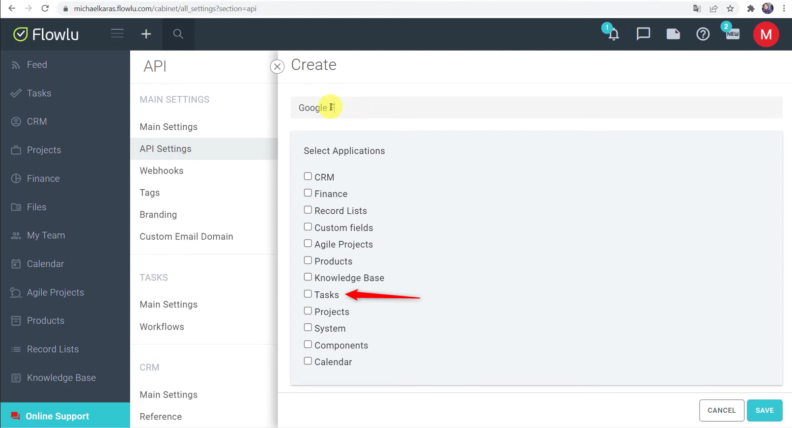

Make sure to choose 'Tasks' as your application when creating a new API Key, instead of the application selected in the video.

Please make another connection in the manner stated above; otherwise, I won't be able to diagnose the issue.
Thank you, just created a new connection called Flowlu Task Only

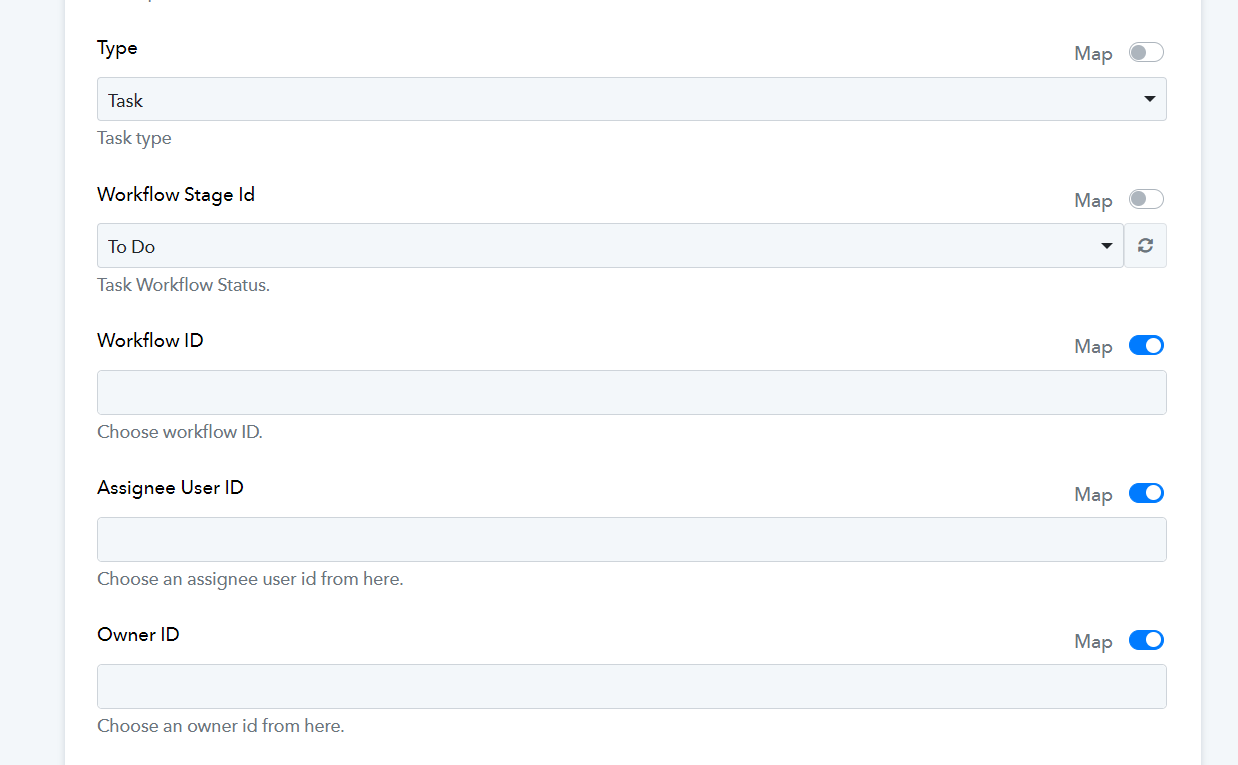

Could you please try to fill the workflow stage ID, workflow ID, assignee user ID and owner ID and then try again?
Unfortunately I don't know what those IDs are or where I can find them.

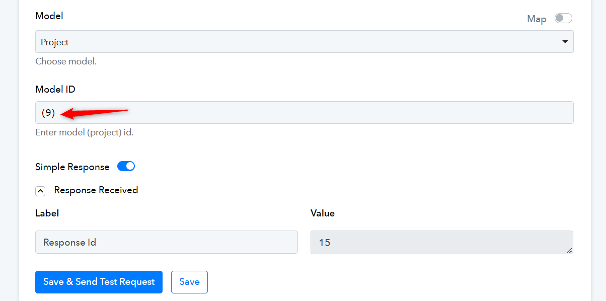

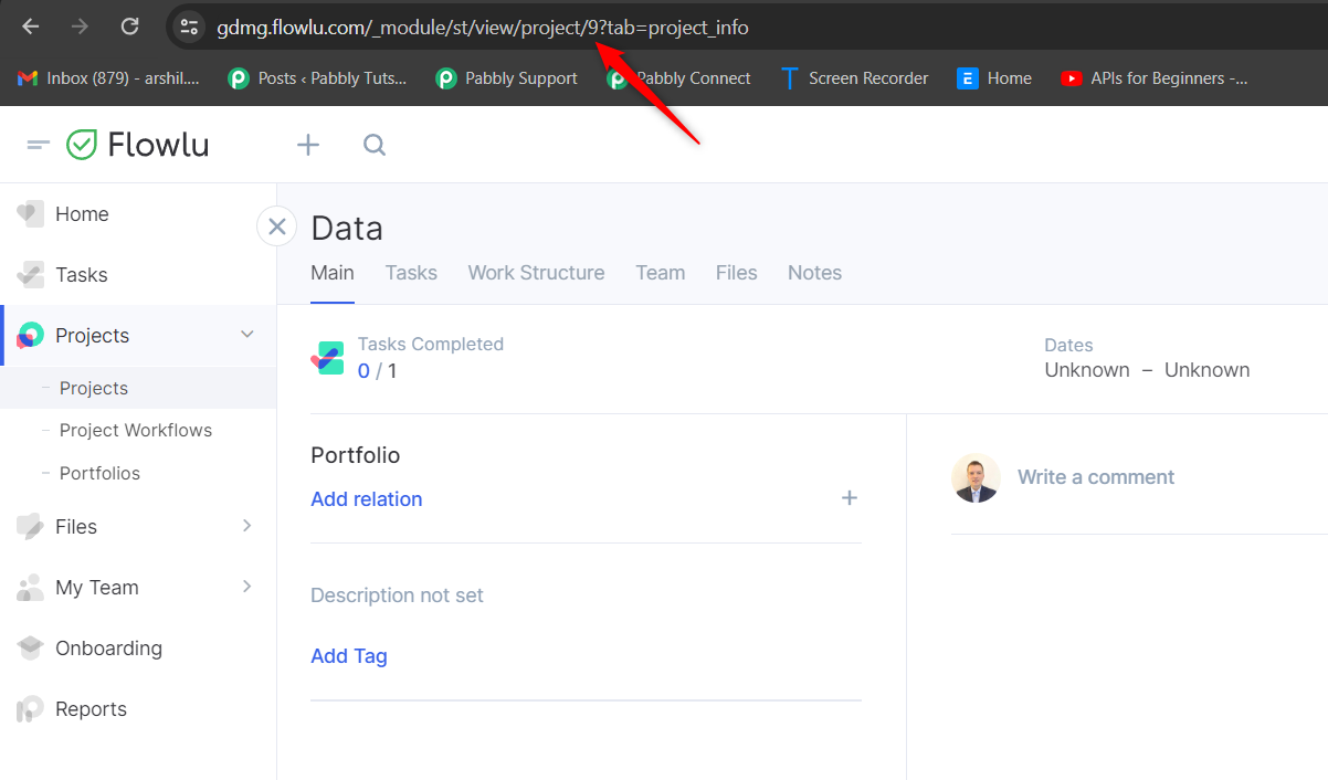

How can I specify what project to add the task to? For example, I have a project called "Data".
You can enter the Model ID associated with a particular Project into its designated field to specify the project.
