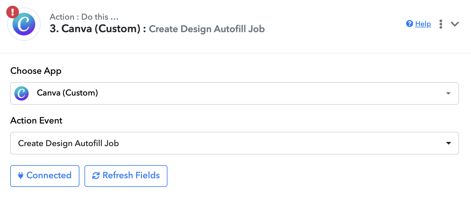

Hi i am having an issue of the Canva access token is revoked after a few days of setting the integration up. Every time i have to go and create a new integration in Canva. I am not sure where the issue is and would appreciate some help on this. If it is not a Pabbly issue some guidance would be great. Thank you.

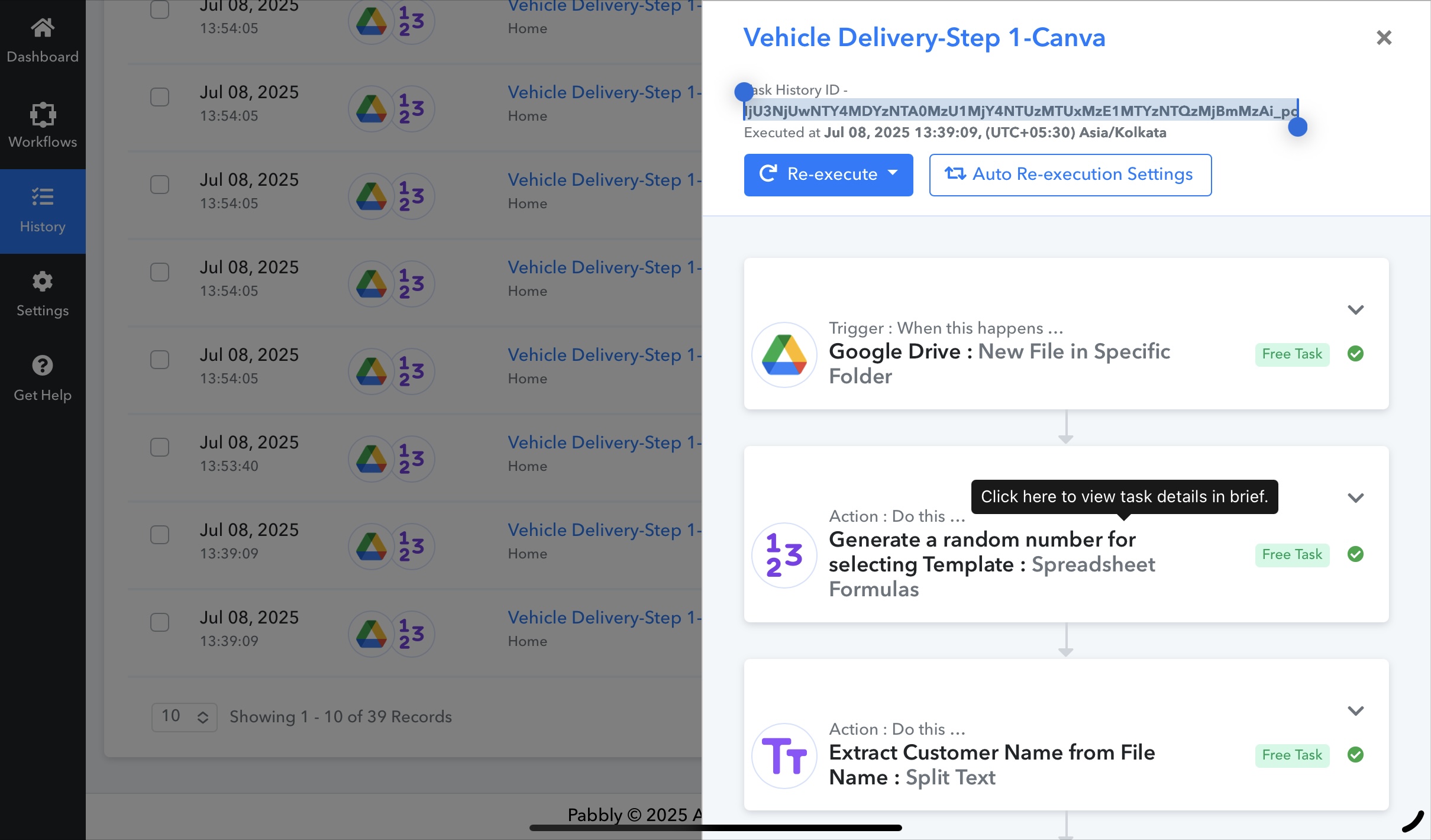

Task id: IjU3NjUwNTY4MDYzNTA0MzU1MjY4NTUzMTUxMzE1MTYzNTQzMjBmMzAi_pc
Workflow name: Vehicle Delivery-Step 1-Canva
The above task id is one of the failed ones out of the few.

Ok got the connection issue again of access token revoked.
Task history ID: https://connect.pabbly.com/task/history?filter_status=applied&filter_by_task_id=IjU3NjUwNTY4MDYzMDA0MzY1MjY0NTUzNzUxM2I1MTYyNTQzNTBmMzgi_pc

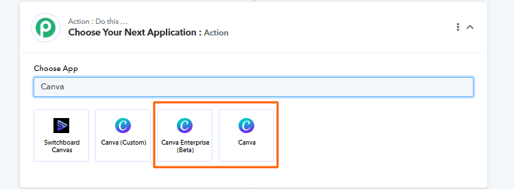

Hello @usman,

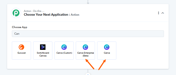

We’d like to inform you that our team has created two new applications for Canva:
  • If you have a Canva Enterprise account, please use the Canva Enterprise (Beta) application.
  • If not, you can use the regular Canva application in your workflow actions.
These updated applications are designed to resolve the token expiration issue you were facing.
Please give it a try and let us know if you encounter any further issues.
MLBalog17 — Reply ·
Is this the only way to resolve this? If I switch to a new app, I have to redo every step in my plan...
You will need to switch to the new application to avoid encountering this issue, as there is no other workaround.

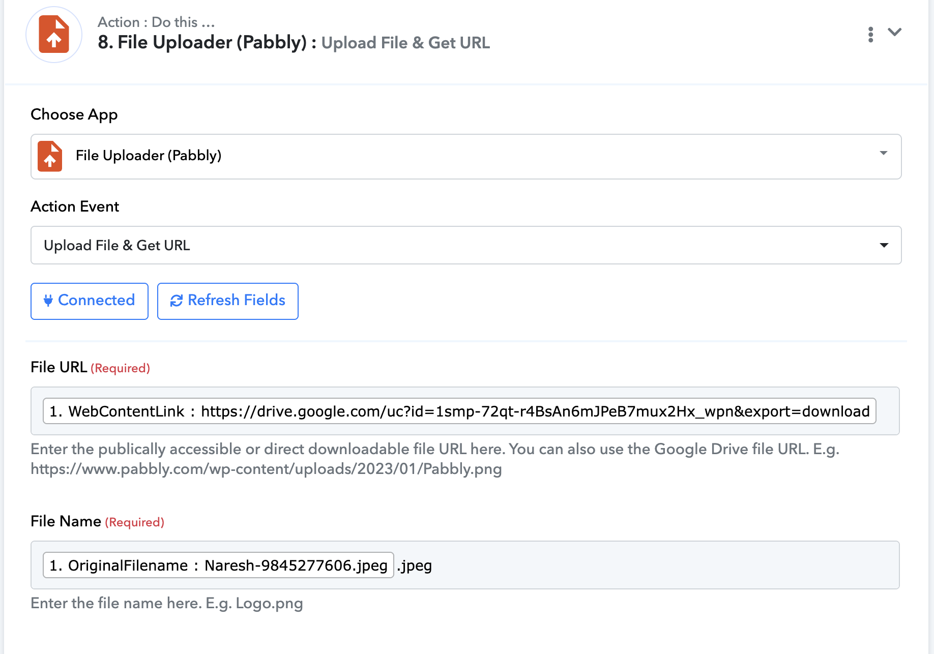

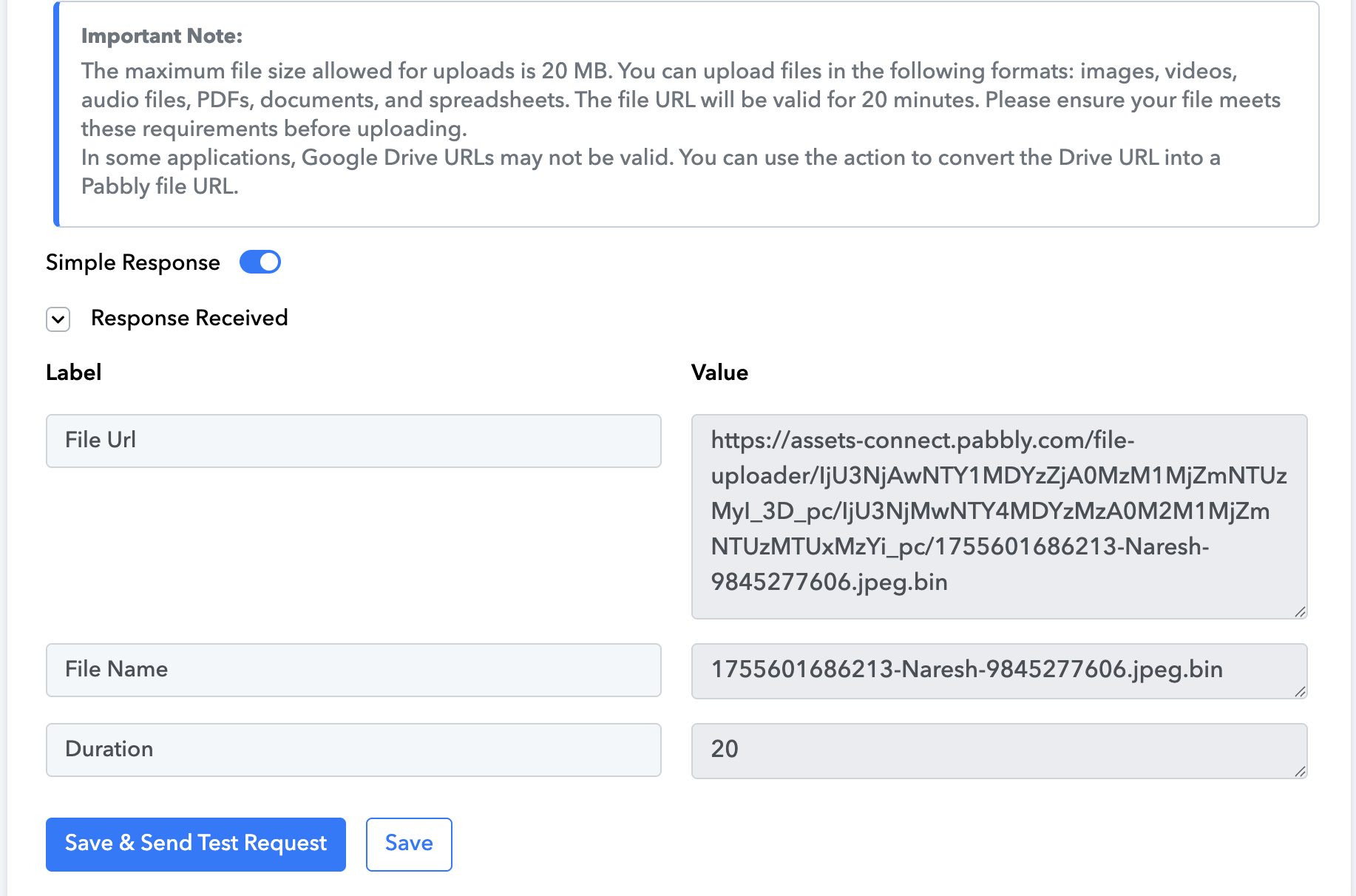

Hi I have tried the new Canva app connection. It does not accept google url for uploading the asset, so i used the Pabbly File uploader. I am uploading a jpeg file but the file url i am getting back is a *.bin format. I tried adding the file extension as well separately in the file name field but the same issue.
Hello @usman,
Could you please provide us with the Workflow URL where you are facing this issue This will help us investigate the problem more effectively and assist you accordingly.
usman — Reply ·
This is sorted. The file in drive had got deleted as it was an old one and the same files wa sbeing processed.

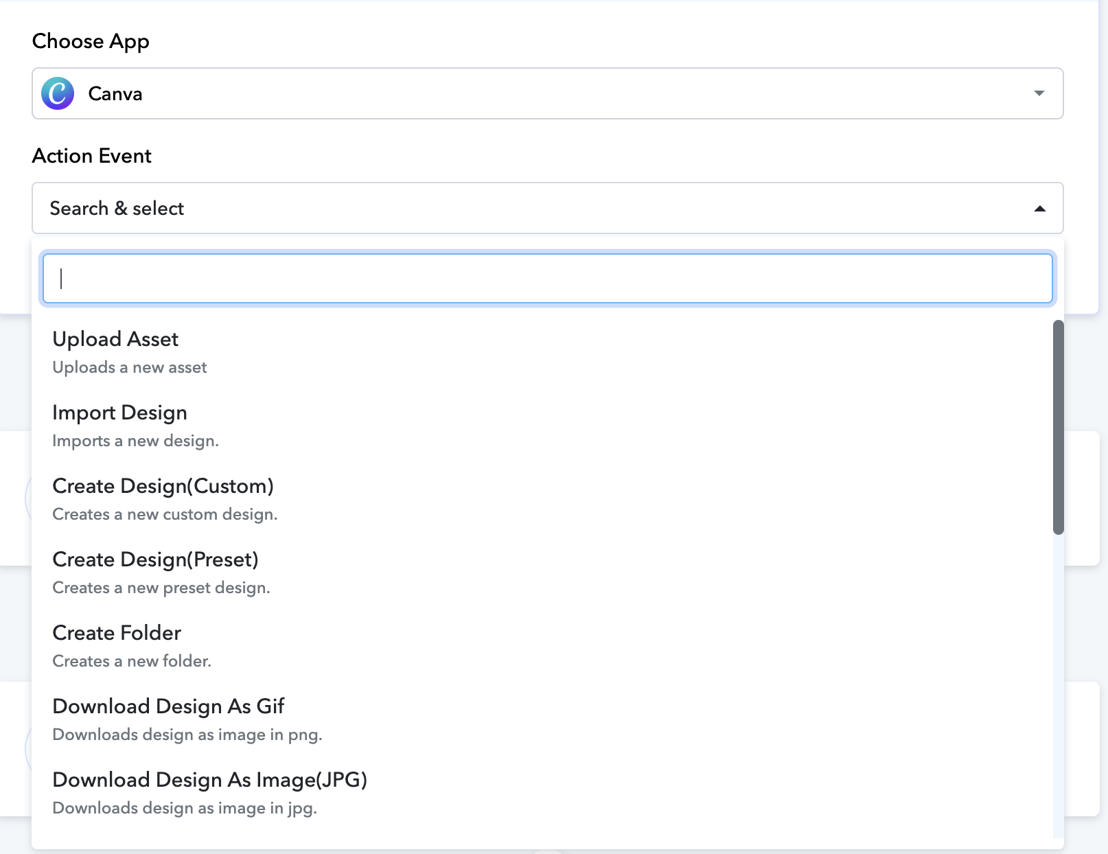

dont see the Create Autofill Design job in the new app. What is the alternative.
Hello @usman,
The Canva custom application you are currently using has been deprecated. To move further, we recommend switching to the updated applications.
  • If you have a Canva Enterprise account, please use the application named Canva Enterprise.
  • If you do not have an enterprise account, please use the standard Canva application.
Please note that the Create Design Autofill job is available under the Canva Enterprise application.
Kindly make the switch based on your account type and let us know if you need any assistance
usman — Reply ·
I don’t have the Canva enterprise account. So how do I do this in the pro account.
Hello @usman,
That particular action is currently available only under the Enterprise account. If your account is not on Enterprise, you won’t be able to use it.
