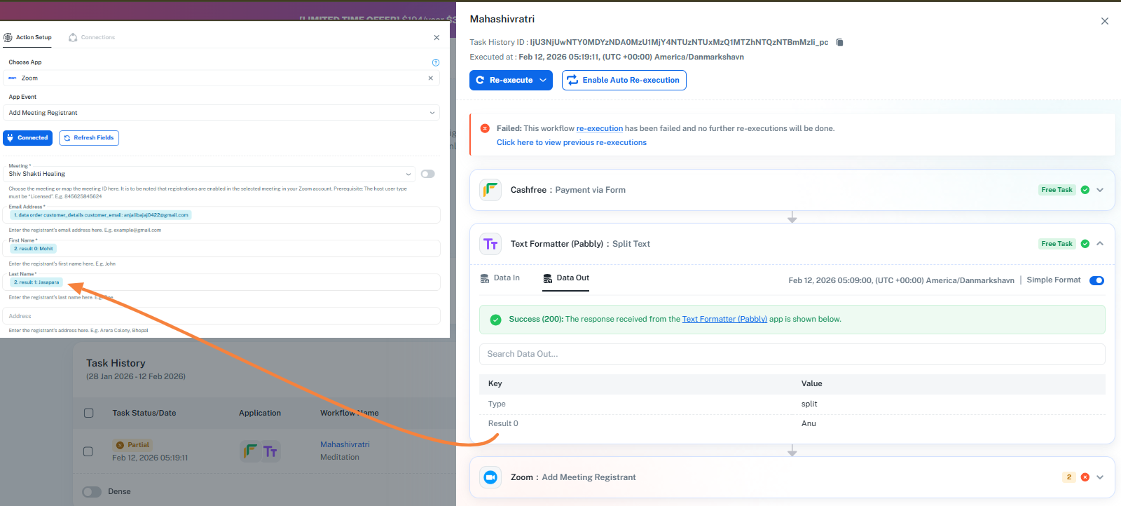

Hi @ABC,
Upon checking your workflow, we noticed that in the Zoom step, both First Name and Last Name are required.
However, from Cashfree, the full name is not consistently coming in, which is causing the issue. Because of this, the Text Formatter (Split Text) is unable to properly split the name into first and last name, and the Zoom action fails.
Please ensure that in Cashfree, the customer always enters their full name (First + Last name) in the name field. This will allow the split step to correctly separate the values and map them properly in the Zoom action.
Once updated, please test again and let us know.

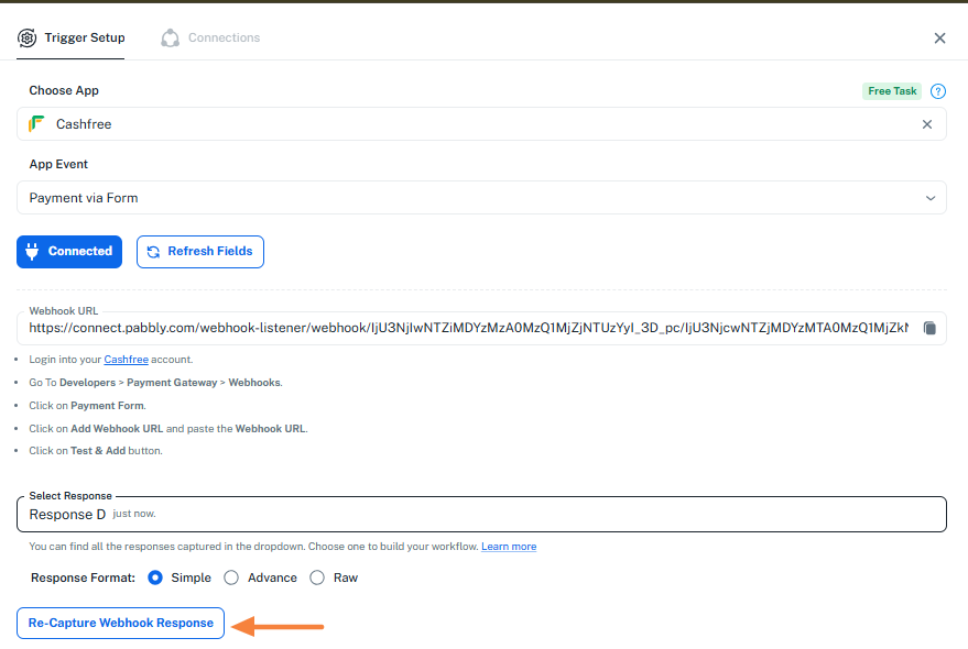

Since you have now updated the Cashfree form to capture First Name and Last Name as separate fields, you will need to recapture the webhook response so the new fields are reflected in Pabbly.
Please follow these steps:
  1. Click on Recapture Webhook Response in the trigger step.
  2. Submit the Cashfree form again with the new First Name and Last Name fields.
  3. Once the new response is captured, remap those fields in the Zoom action.
  4. Test the workflow again.
Currently, the old response structure is still being used, which is why the new fields are not appearing.
Please try this and let us know how it goes.

When I tried clicking this I m getting this error

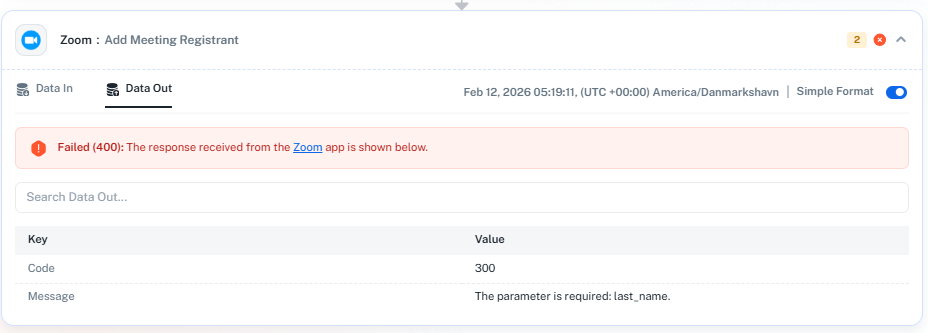

This is the workflow written in Pabbly. Where in two separate fields are created in cashfree form to capture first name and last name then mapped to the fields of zoom. This was working fine in the test environment but stopped working in the Prod with zoom giving 300 error field missing
Please let me know what to do to rectify. If possible to rectify at your end please do the same.

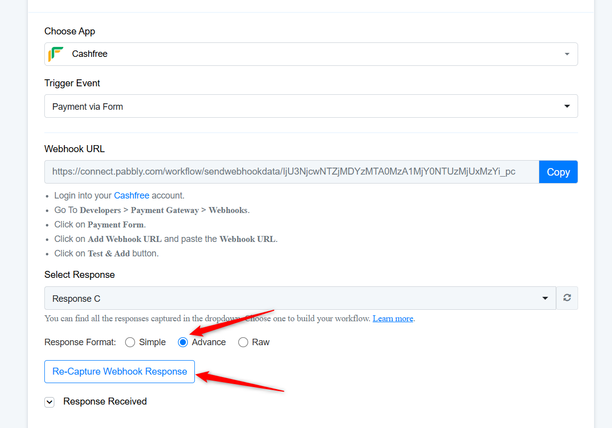

The issue is related to the shuffling of fields in the Cashfree trigger step. Please select Advanced as the response format, then click on Re-Capture Webhook Response and capture a new form submission. This will give you the response in JSON format. Once you’ve done that, please let us know—we’ll add a Code step to your workflow to prevent the shuffling.

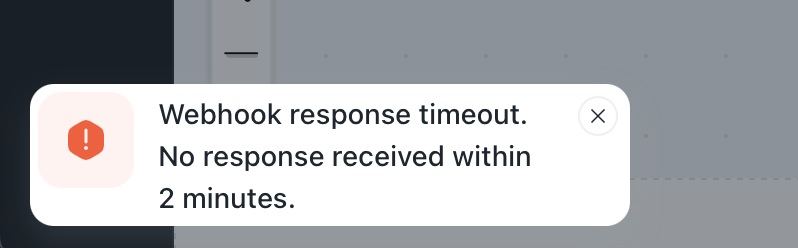

Tried the above step. Now it is showing the timeout error again
Clone the workflow, then set up Cashfree as your trigger step, and while capturing the form submission, capture it in the Advanced format. Once you have done so, please let us know.
