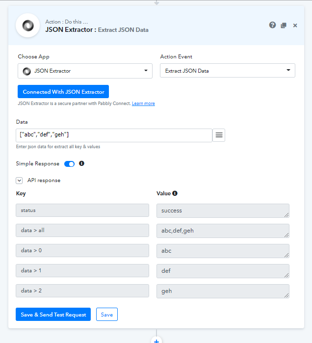

Can you try to get the above data not as a simplified response and then, pass the value array to JSON extractor to get the values as shown below:
And then you can replace comma from the data > all with <br> in the next step using Text Formatter - Replace Text action to get the desired values.

Hey Phil,
Just turn of the simple response and send the test request in the Google Sheet step, you will get the values as an array and map the same in the JSON extractor field, you will get the response with comma separated values

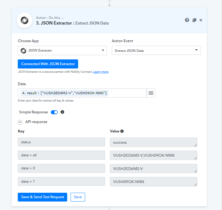

I have created a simpler one, for you to test
Thanks for sharing the workflow.
I can see, there are nested square brackets causing the problem, but, I have made some changes to make it work.
I have added a couple of Text Formatters - Replace Text to replace [" and "] with " (double quotes) to get the final array like ["val1","val2"].
Please check the attachment and your workflow. Now, you can get the comma separated values.
I hope you find it helpful.
