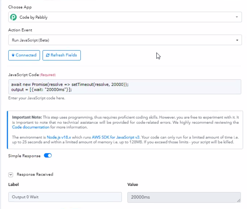

Hello @kotakeio,
Instead of using pabbly connect's Delay action, you can use code - javascript action like this to have a delay of 20 seconds.
Here is the code-
await new Promise(resolve => setTimeout(resolve, 20000));
output = [{wait: "20000ms"}];
