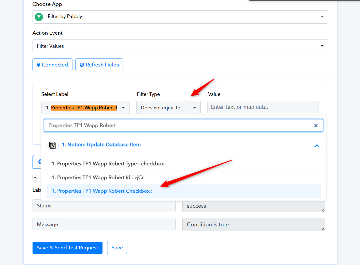

hey guys...so i want to trigger a whattsapp message whenever a notion box is checked .
I did the message part..and created the filter...but I donno exactly how to filter to send only if a certain box is checked...could you please help??

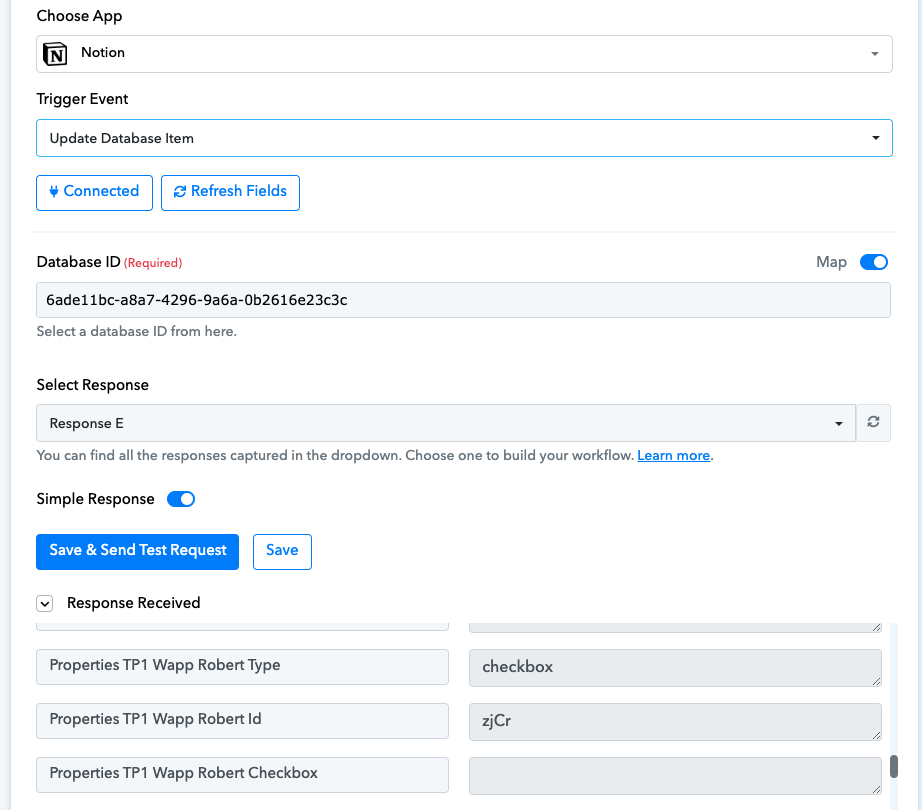

So here ..my thought was if the Checkbox is checked....send the messages...but now I realise it might not be ok.
So what I really need is actually when I check a box in notion *Tp1 Wapp Robert T to send the messages on UltraMSG whattsapp...the message sent part works perfectly now....BUT the condition is not working yet....because there can only be made just Once.

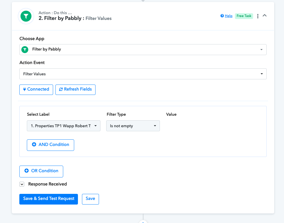

Please try using the following filter condition for your use case once and then try again.

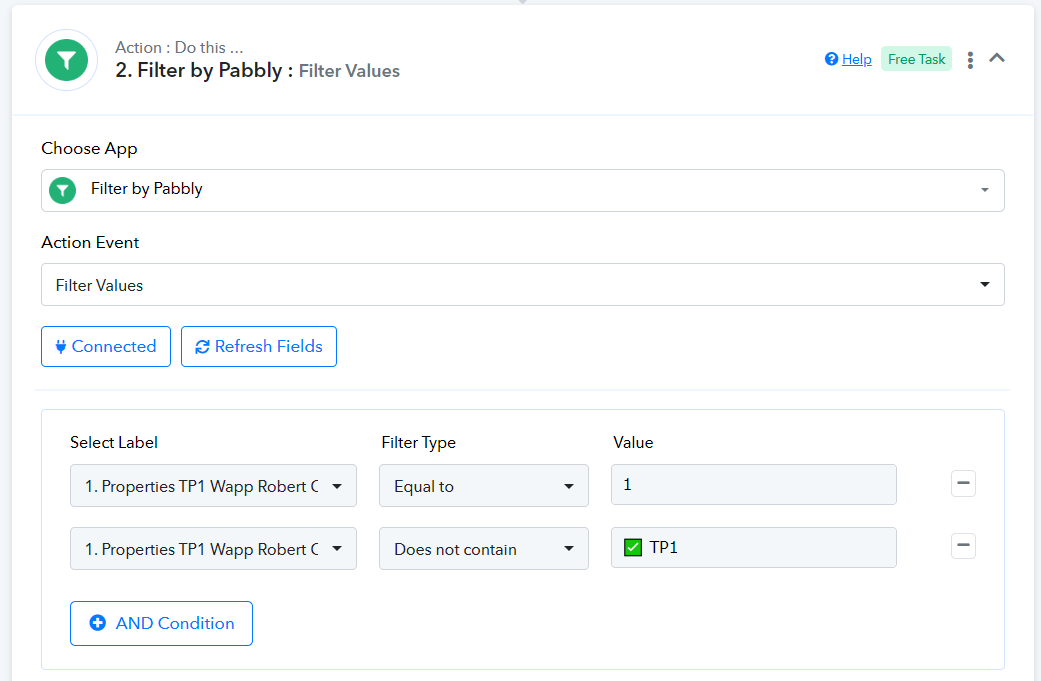

Now it works...Thank you! But it send the message 2-3 times.
So I added another condition intro the filter...after sending the message to add a tag to the Page....and to check if that tag is set before sending messages...to protect from double texting the same person when another update has been done to the page...but it does not seem to work,...could you please advise?
Arshita — Reply ·
Hey @EugenWLF
Upon review, it appears that you have set another filter condition with an "AND" condition, indicating that both conditions must be met for it to work. I recommend referring to the tutorial below on how filters work, and then try again.
