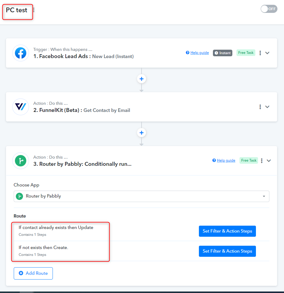

Hey @Buschi
We have made a test workflow in your account called as PC test and added the logic for if contact exists then kindly update it and if contact is new then Create a contact in Funnelkit. Please once check the workflow and then make the required changes in the workflow and make it live.

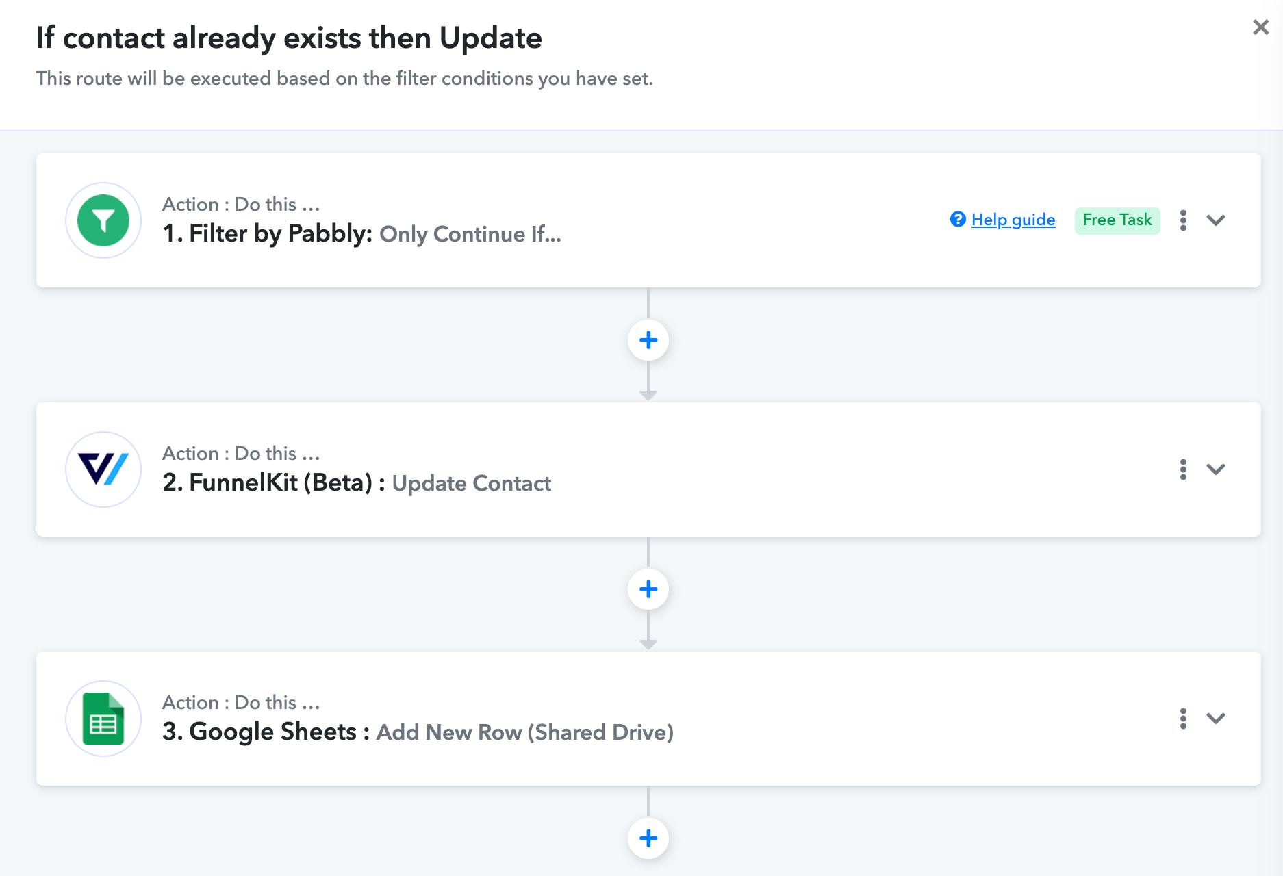

Buschi — Reply ·
Hey my friend. I realy appreciate your fast and valunrable response.
1. The "If contact already exists then update" path is not working. Can you take a look again?
2. Can there be a second "Router app" within the "if contact already exists than update" path/filter? I want to set two different tags. If the contact is “unsubscribed” than tag #A and if the contact is already subscribed then tay #B. Is this possible?

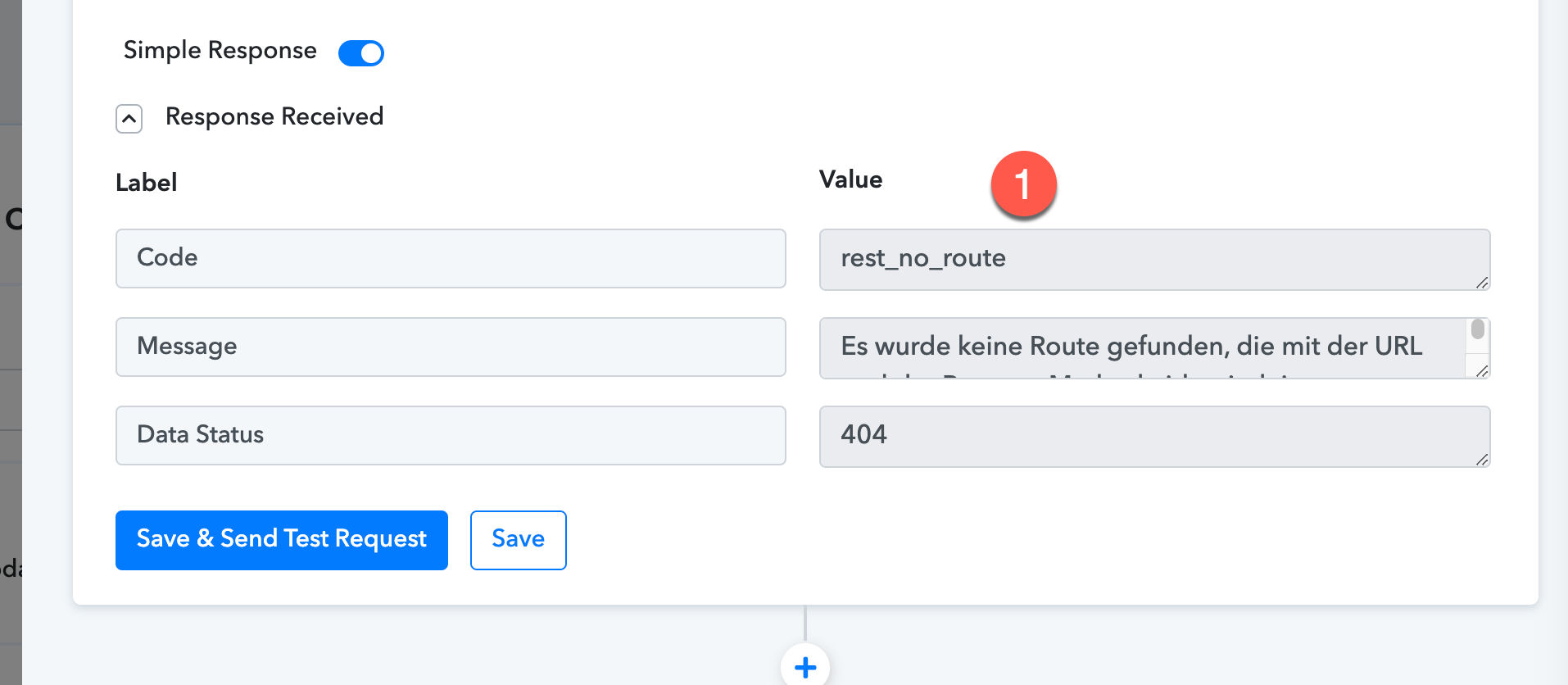

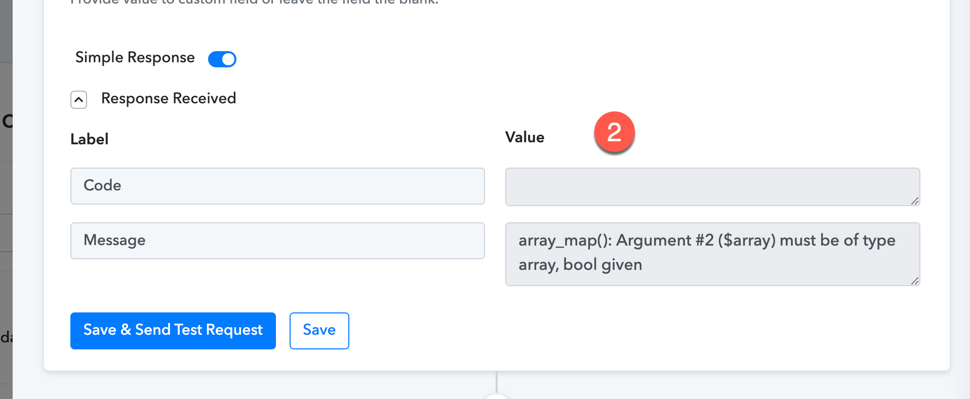

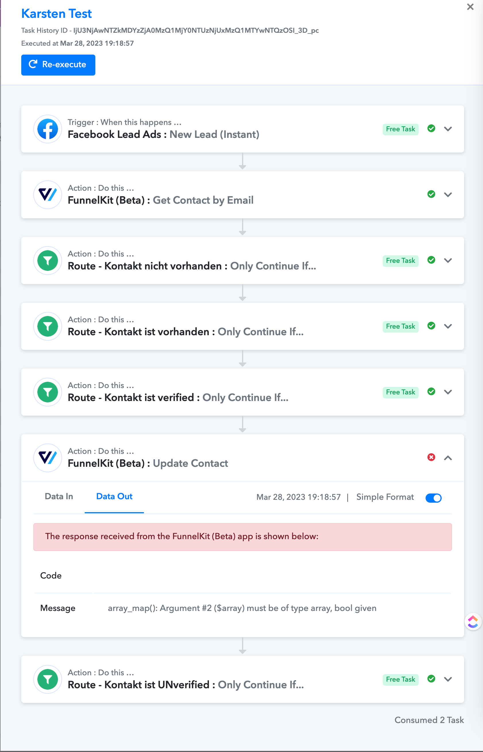

Heyho. Thx for the videos. I watched both. But I get this errors: it is for this workflow

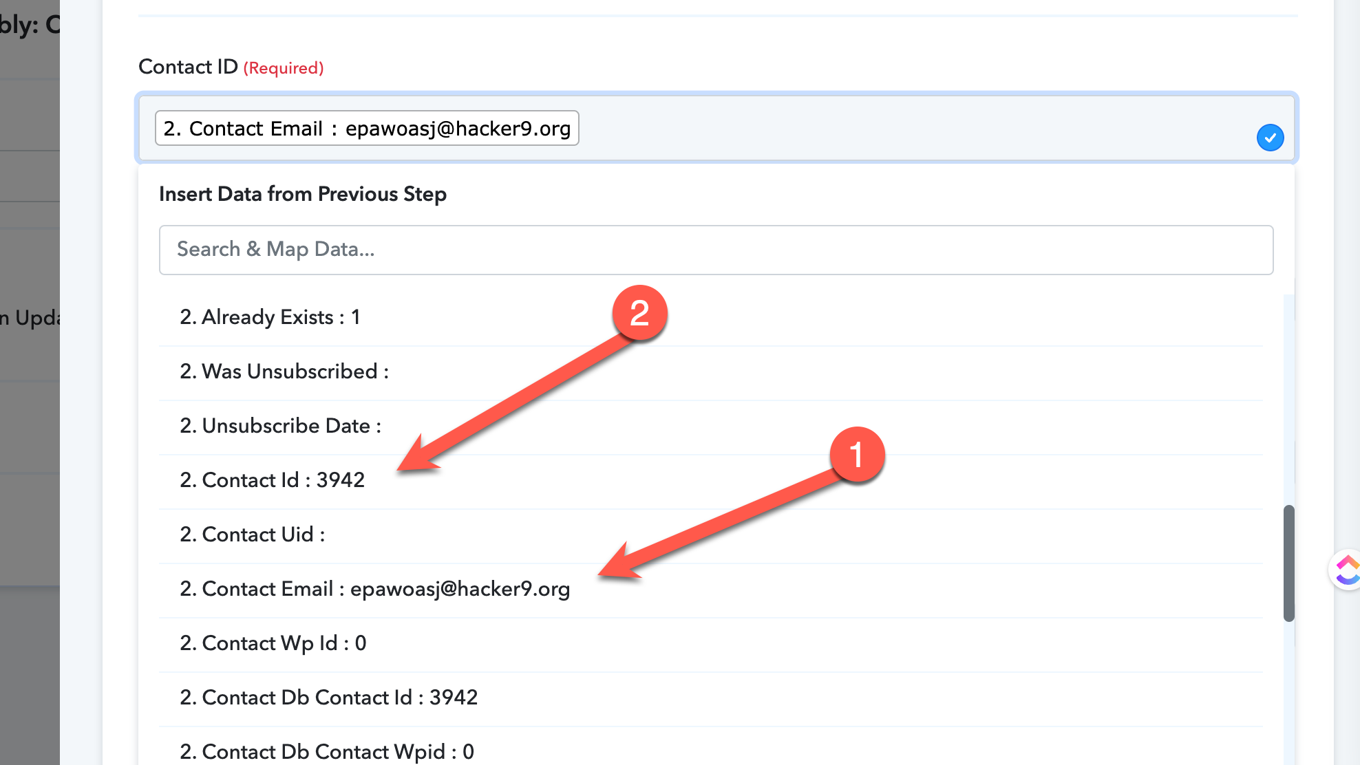

It is in the second step: for contact ID I choosed #1 or #2.
This are the errors:
Do you have any suggestions on this?

Arshita — Reply ·
To properly map the contact ID, it is necessary to select the correct field from the response. Currently, it seems that you are mapping the contact email instead of the contact ID.
Also, I would like to bring to your attention that the task was re-executed, which resulted in the loss of all the previously mapped fields. This occurred because Facebook lead cannot be re-executed, and doing so will discard all the mapped fields.
To resolve this issue, I have remapped the fields again. I expect that the workflow should now work smoothly without any problems. However, to ensure that everything is working correctly, I request you to generate a new Facebook lead and try to capture the response once again.
By doing this, you can verify that the fields have been remapped successfully and that the workflow is functioning as expected.
