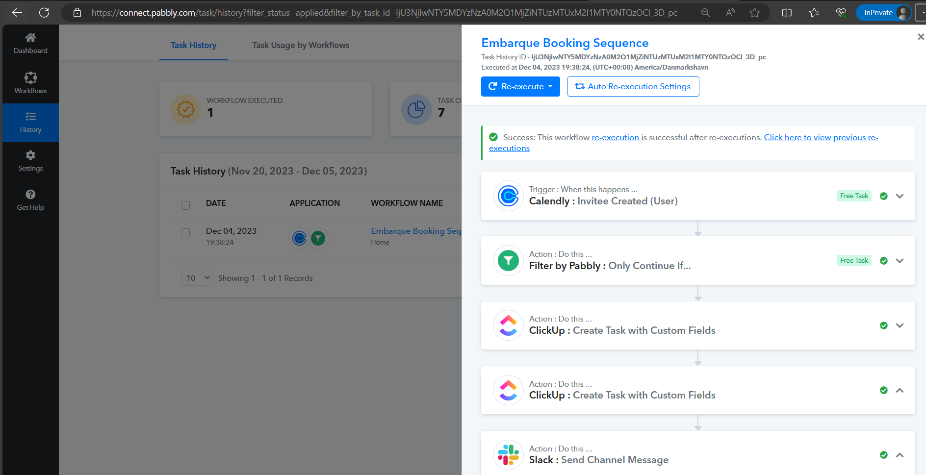

Could you help me diagnose the following error on the same automation:
Task History ID -
IjU3NjIwNTY5MDYzNzA0M2Q1MjZiNTUzMTUxM2I1MTY0NTQzOCI_3D_pc
Executed at
Dec 04, 2023 19:25:20, (UTC+00:00) America/Danmarkshavn
samvanme — Reply ·
@Supreme
Hey @samvanme
As we can see from your tasks history we can see that your execution has worked accordingly.

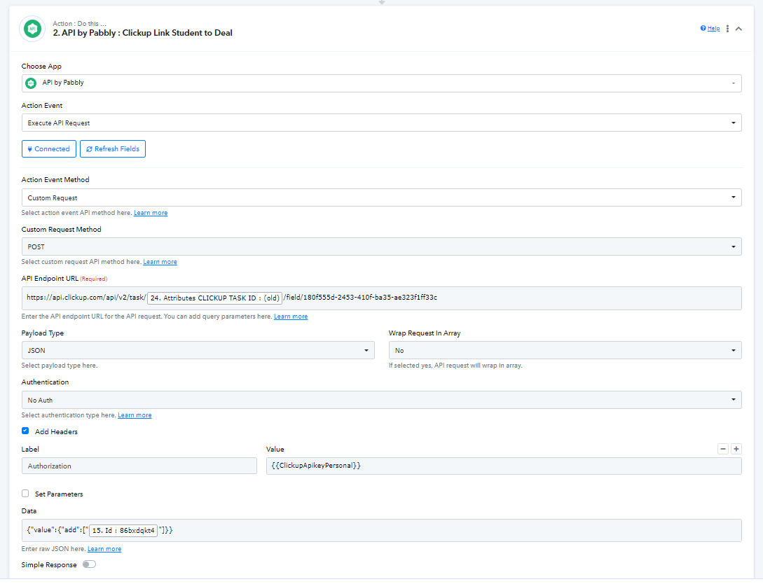

Matchspace AG — Reply ·
This is how I set up Clickup Add Relationship using API Custom method. It works:
