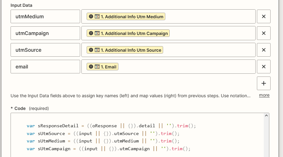

Next question. In Zapier, we pass though 'Inputs' from previous steps, I can see 'Labels' within Code by Pabbly - can this acheive the same? How do I then reference them in JS (like we do with input. in Zapier)?

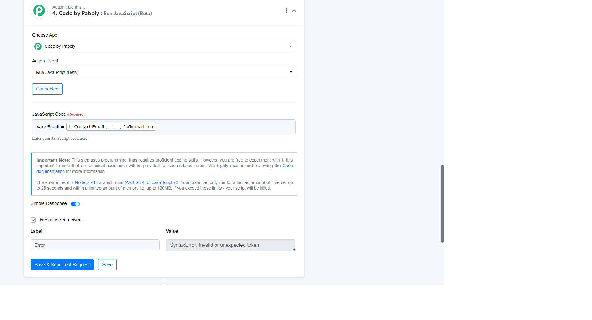

OK. Watched a couple of videos about inserting the inputs directly in code, so most should be reworkable from Zapier to Pabbly - but any idea's on this error? Something as basic as setting a variable - doesn't seem to like the input (from a Clickfunnels webhook)?
karl_sws — Reply ·
With more testing, it seems I need to wrap the previous steps input within quotes, which wasnt the case in Zapier. That seems to stop the SyntaxError.
The problem with the JavaScript code given is that the variable sEmail is assigned an invalid value. JavaScript variable names cannot begin with a number, and the dot (.) character is not permitted within the variable name. Furthermore, enclosing the email address in quotes is necessary to treat it as a string.
