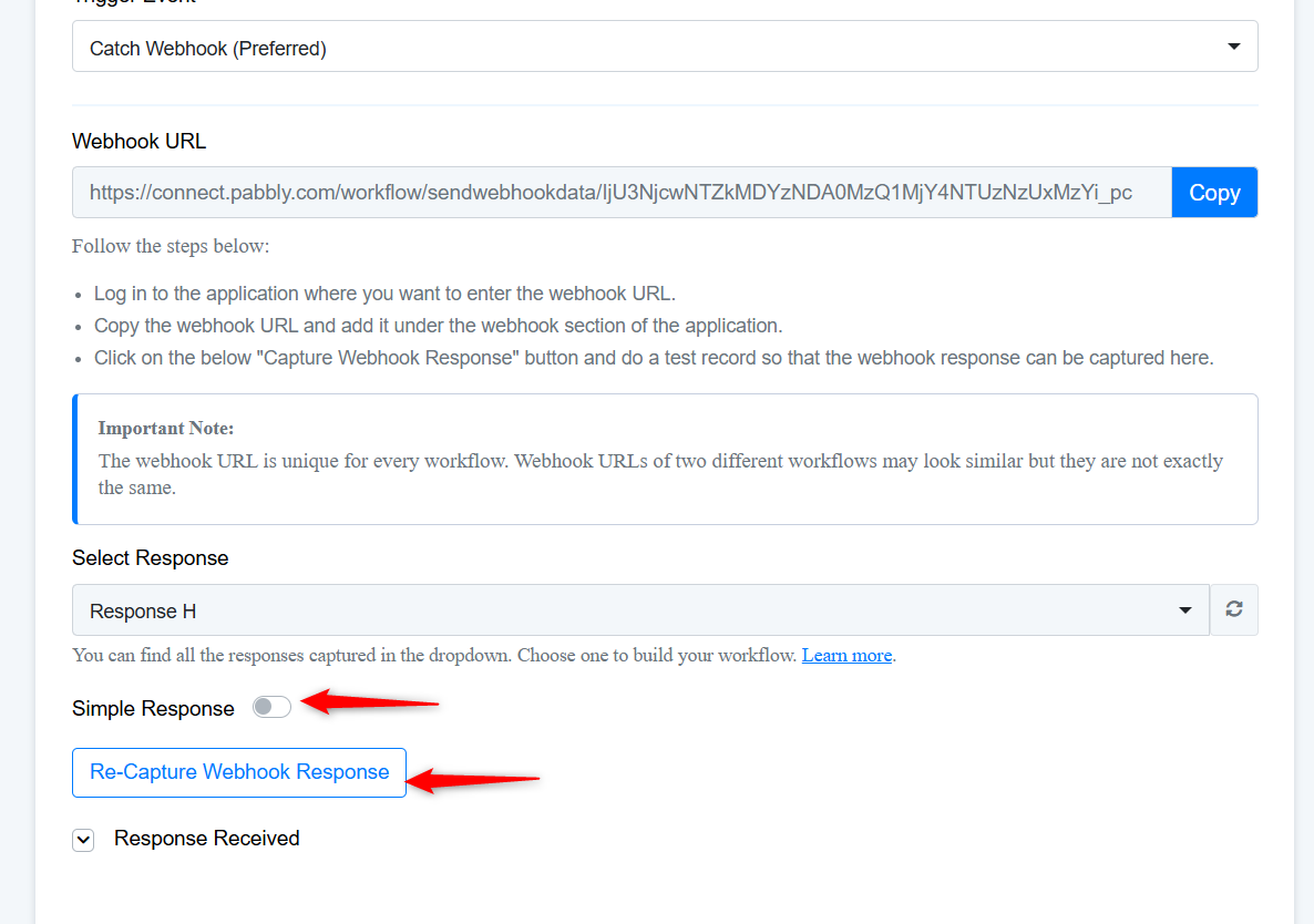

Thank you for the detailed explanation of your issue. Please disable ‘Simple Response’, then click the ‘Re-Capture Webhook Response’ button and capture a new 10-answer response in your trigger setup. Once you have done that, let us know and we will guide you through the remaining steps.
And gemini suggested turning off simple response in the trigger, but that means everything needs to be coded to make the AC connection working.
Do not worry, you will not have to use code to map the data to ActiveCampaign. We have tools that you can use to extract the data, and you will be able to map it the same way you have mapped the rest of the data.
