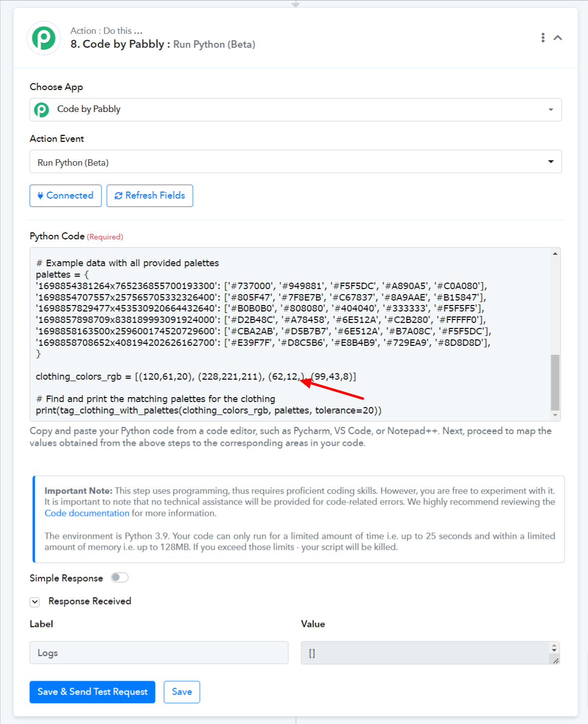

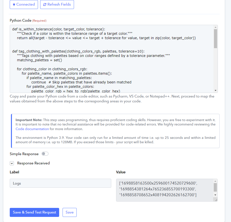

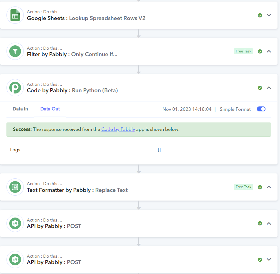

My code runs fine during testing in pabbly, but when the full workflow is run, it sends a blank response.
When I re-run the workflow step by step manually, it works again.
Seems like this is on Pabbly's end. not sure what to do.

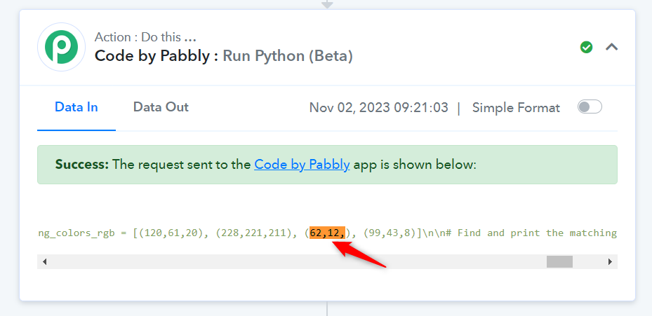

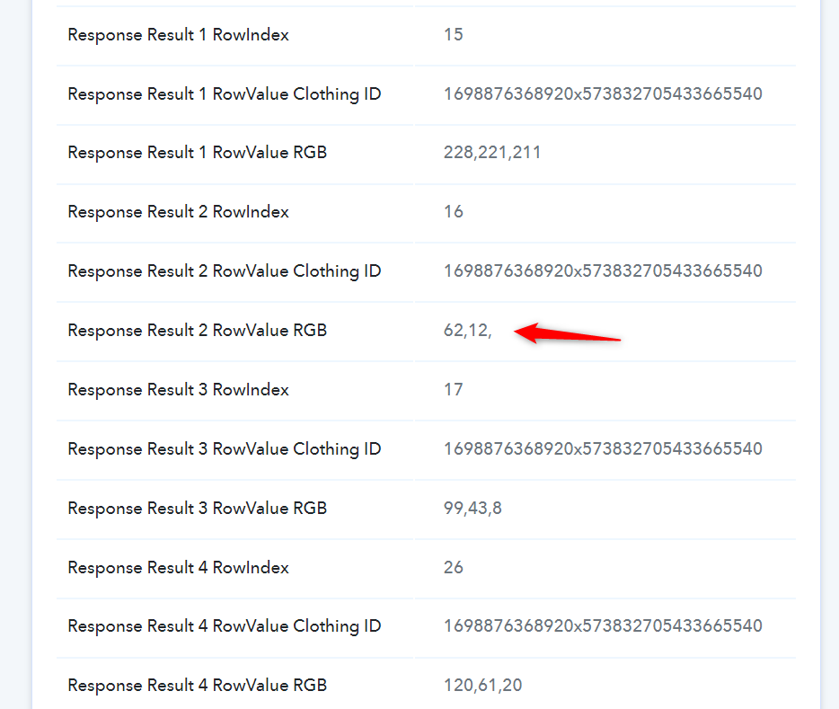

Hi @cjc,
The issue appears to be related to not receiving the correct data from the Google Sheets spreadsheet. When this incorrect data is mapped into your code, it results in a blank response.

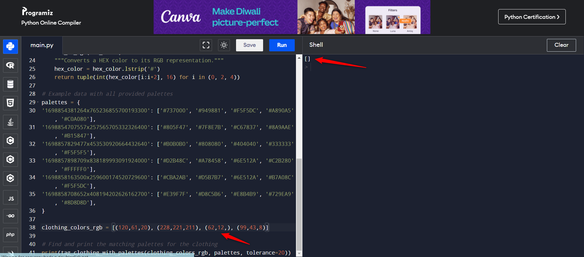

We ran the code exactly as it appeared in the Task History in an online compiler and manually in Code by Pabbly, and obtained the same result.
