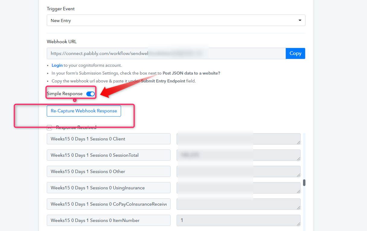

I have a robust Cognito Form that utilizes Repeating Sections. Pabbly is able to pull the data in, but it doesn't put the repeating section into an array. I am struggling to figure out how to best handle these repeating sections inside of Pabbly. For example, I have independent contractors that perform services daily, however, sometimes they work more less than 7 days, and perform several services in one day. I need to pull specific data from each service, but am not sure how to make this work. It would make sense if it was in an array that I could iterate the information and create a filter for the data that I wanted information from. Does anyone have any ideas about this?

You need to capture the webhook response in advance response by turning off the simple response. Then you can use the Iterator action step to process each and every line item(If required).
