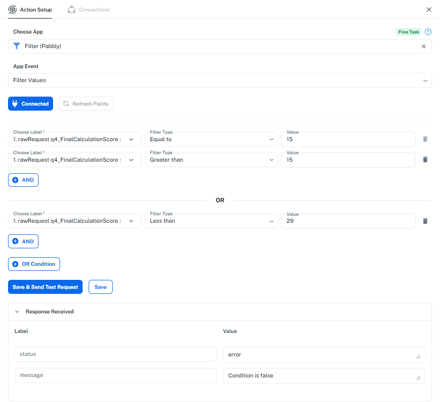

Condition is false
Status: Open · Asked by mido on · 0 views
Hi @mido,
It looks like you have set the filter with 'AND' conditions, so all three conditions must be met. Since two of your conditions are not true, this is causing the issue you’re encountering.
mido — Reply ·
Than you. What would be the best setup for it. I want it to filter it the score code 15 and higher but lower than 29.

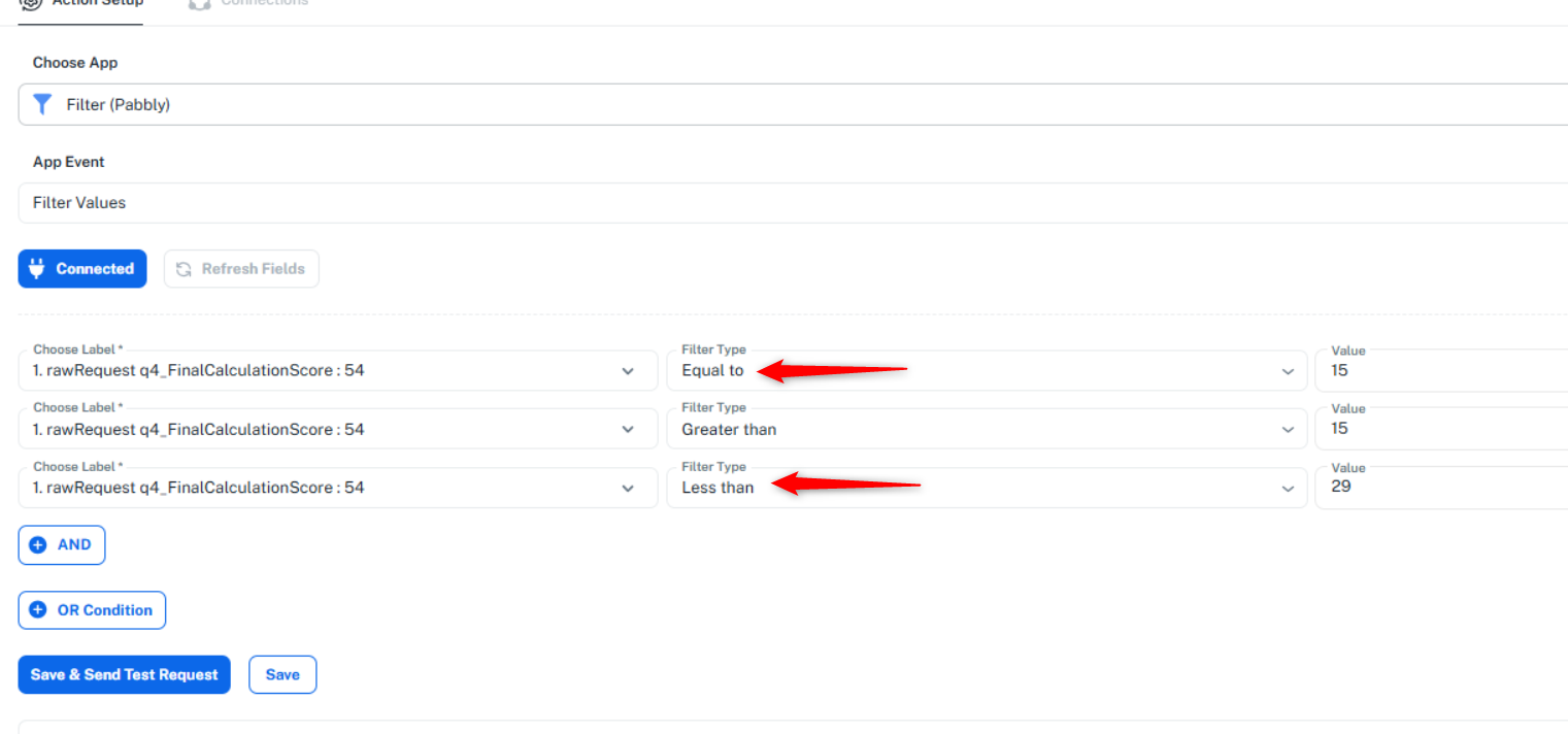

Hello @mido,
You can set up the filter as per the attached image. We have edited the filter on your behalf.
mido — Reply ·

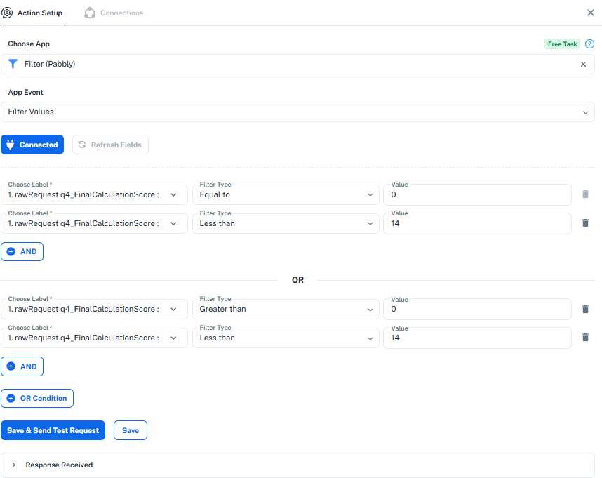

Hello @mido,
Could you please clarify the conditions for each case/route and specify which particular score should be processed This will help us assist you more effectively.
mido — Reply ·
The data coming form Jotform has a score from 0 -24.
0–14 pts → Survival Mode
15–28 pts → Stuck Mode:
29–35 pts → Scaling with Struggle
36–42 pts → Authority Mode
Hello @mido,
Thanks for the clarification,
We have made some slight changes to your filters. Kindly monitor and let us know if your workflow works as expected going forward.
