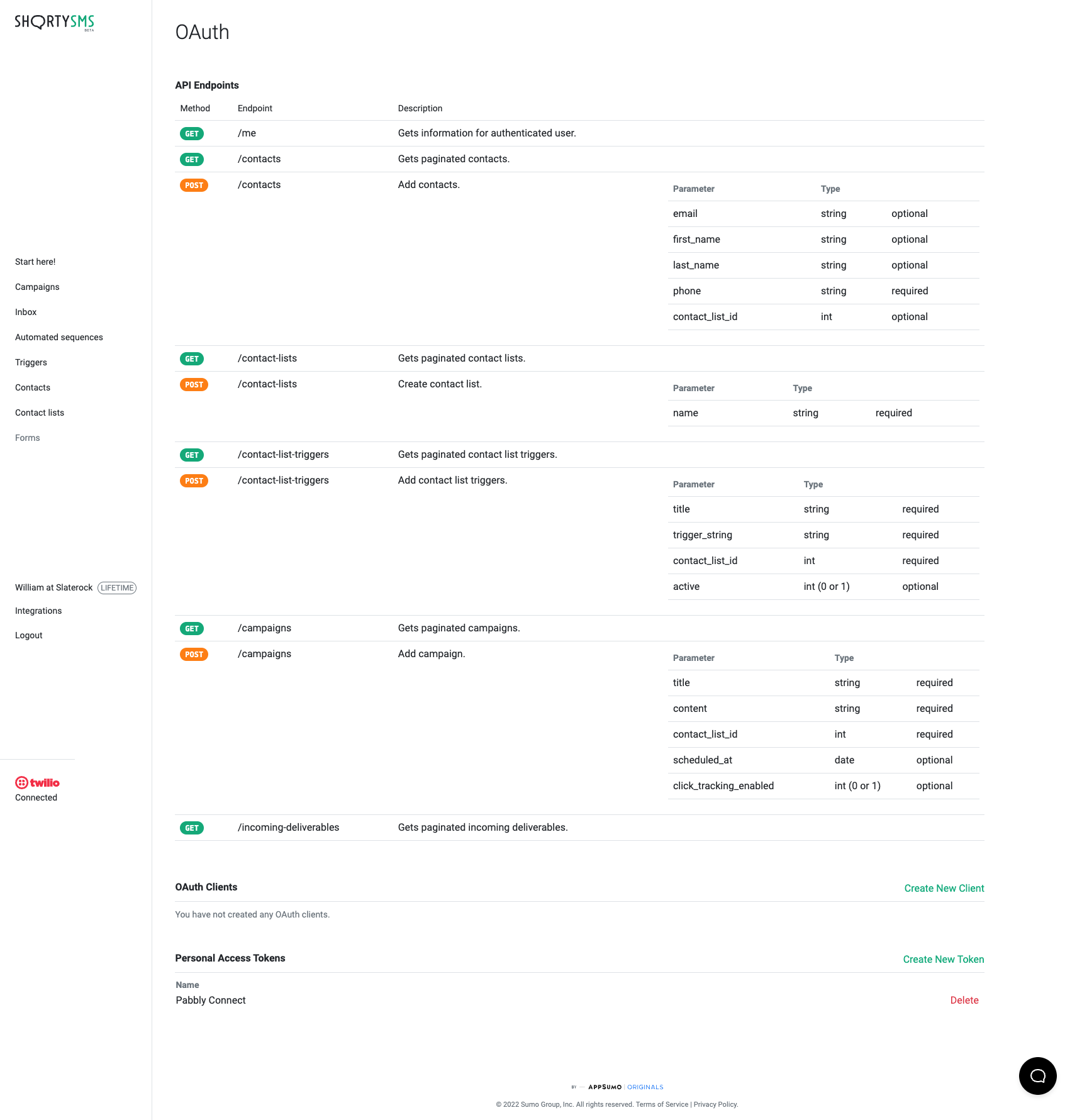

Below is a screenshot of their Oath Page.

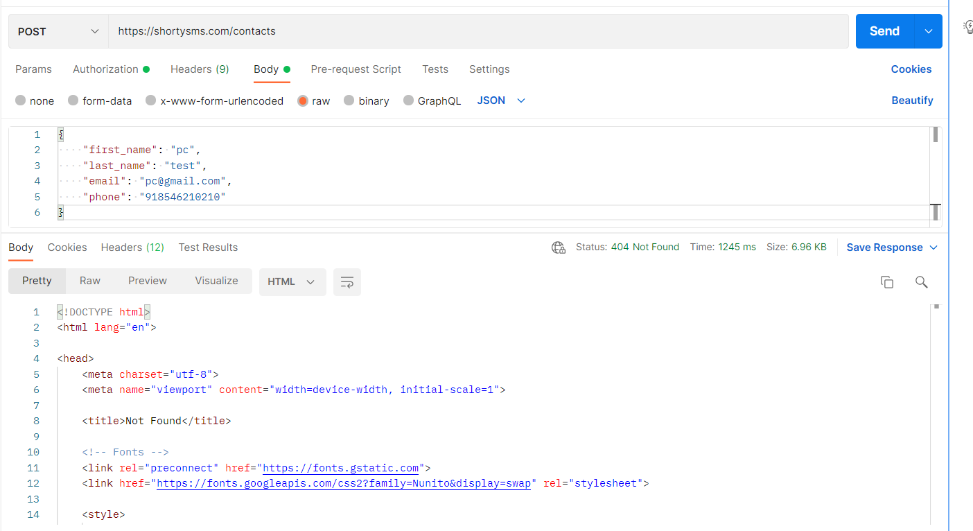

I tried using the /contacts Endpoint to add a contact every time I receive a new subscriber using Encharge. I have attached a PDF screenshot below but I cannot seem to get it to work as I get an error each time.
Does anyone know how to set this up properly? I think it has something to do with the Shortysms API endpoint but there isn't any information on the matter and support doesn't seem to know what the issue is.

Thanks for replying, I have attached a PDF of the API documentation page for Shortysms. This is all the information that is available, but it doesn't seem like its everything we need, is it?

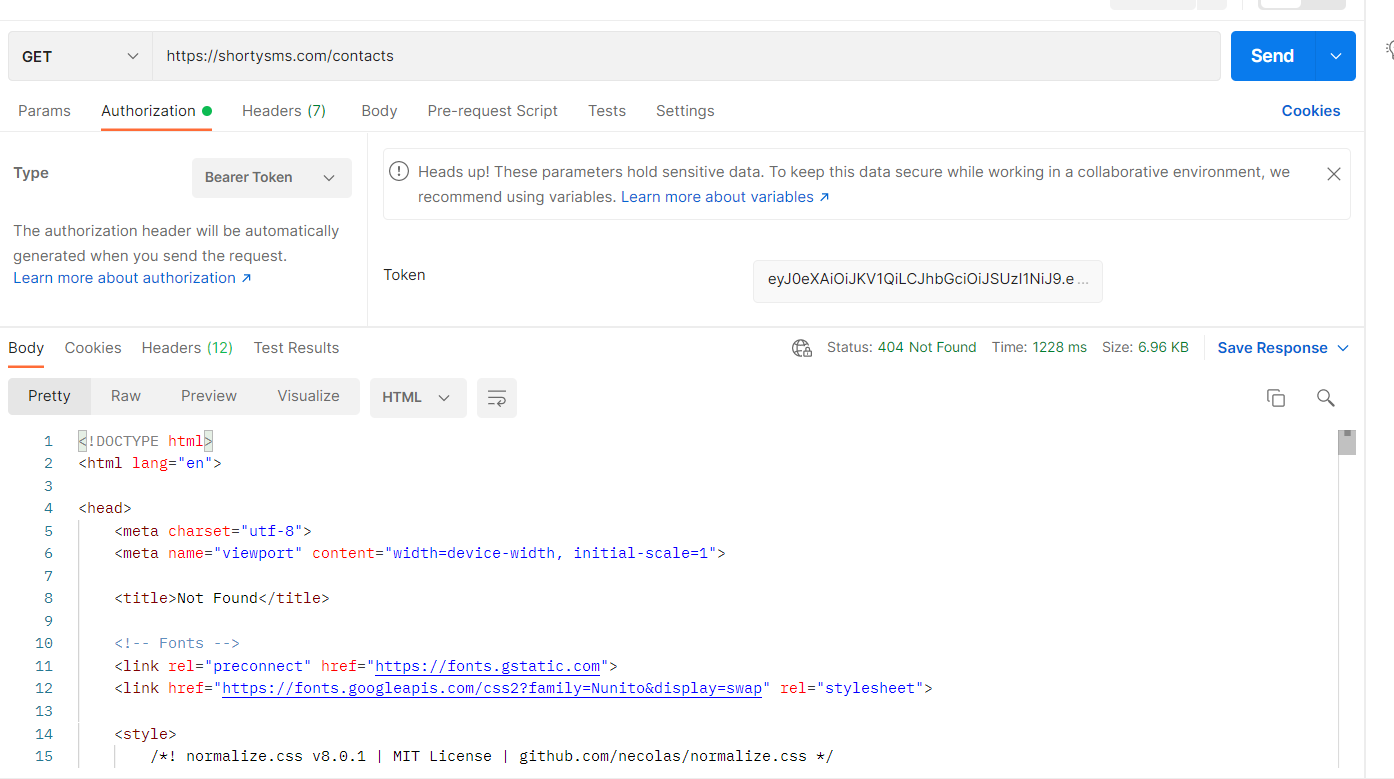

We tried to build the API at our end from the API document which you have provided on Postman and it is showing absurd error. Kindly check again with the application's support team for the proper implementation of the endpoint.
Get Method we have tried on Postman -

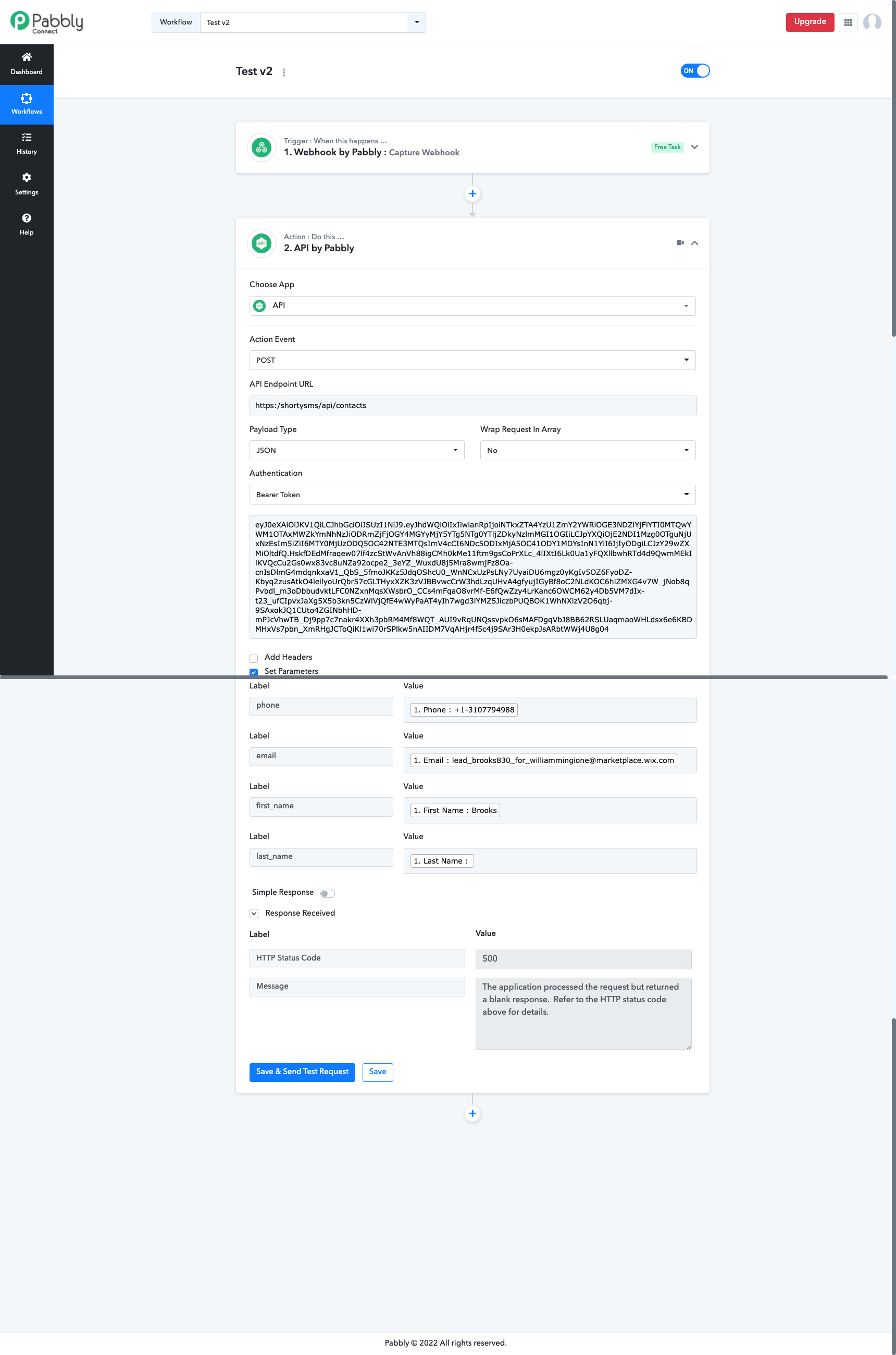

UPDATE:
Appsumo support has brought it to the attention of the developers, but they did mention the endpoint should be:
https:/shortysms/api/contacts
After switching it, I did receive a response, but it was blank and still did not work. I have attached a screenshot below.
Hey @billymingione
We have again tried the same as you have asked and the API is still not responding at all. Kindly contact their support team for proper guidance.

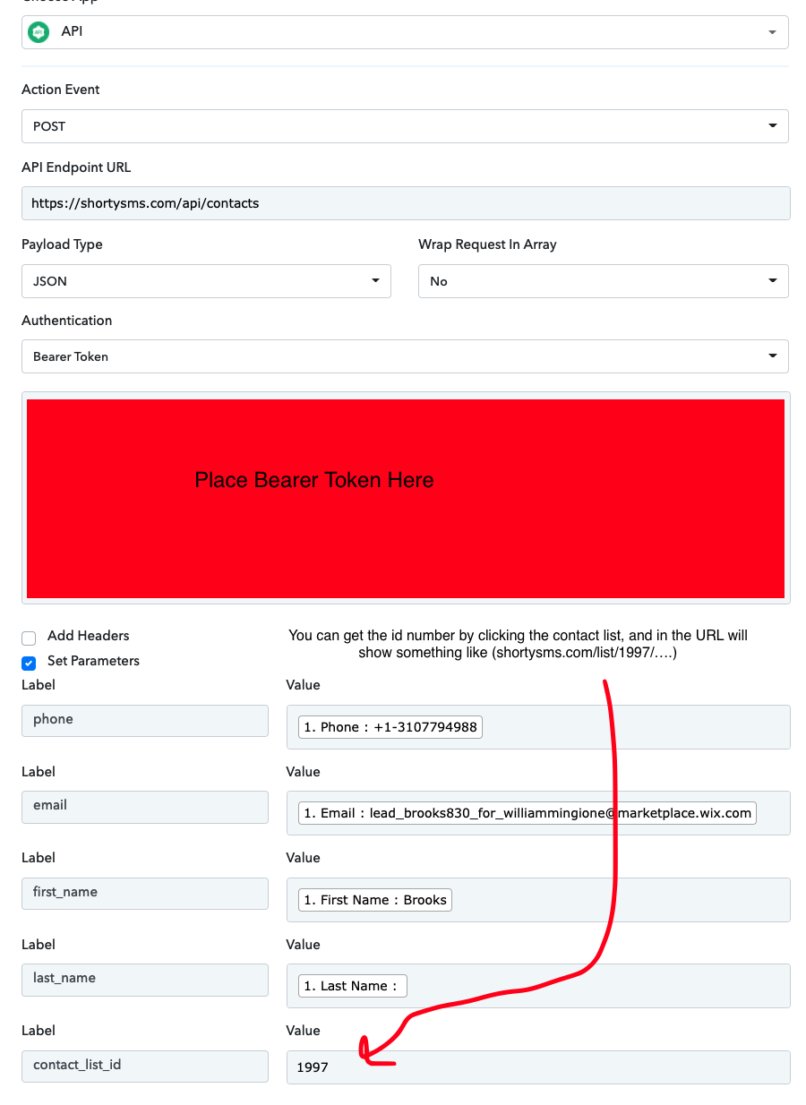

SOLVED
Their support messed up again. The proper Endpoint URL is:
https://shortysms.com/api/contacts
I now have the "create new contact" working!
Thank you, @Supreme for your help and for providing valuable resources to show to the Appsumo team!
mcohen — Reply ·
Hi Billy & Others. I was able to use your hard work to get most of the way but I can't seem to get the number into a specific contact list in ShortySms. Wondering if you might have any idea of how to do this? Here is a video of what I'm trying to do: https://share.getcloudapp.com/OAu4nrL9
