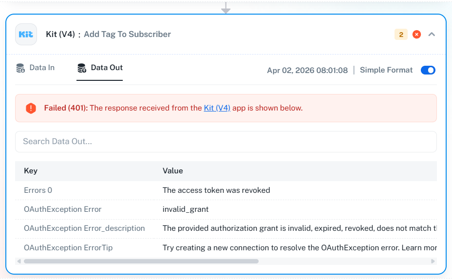

I created this flow and it was working fine till 18 March. I saw today that after that only 1st 2 steps where executed and the 3rd step is showing error.
I have attached the error message as a screenshot. Please help! This is very important for me!

Hi @Nehha Jaiswal,
Thank you for sharing the details and screenshot.
As per the error, it appears that your KIT (V4) connection has expired, which is why the 3rd step (adding tag) is failing.
Suggested Fix:
  • Please reconnect the KIT account by creating a new connection (as mentioned in the error)
  • Update the connection in your workflow
Also, could you please share the workflow URL so we can check the setup more thoroughly and assist you further

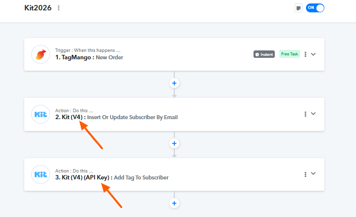

Hi @Nehha Jaiswal,
Thank you for sharing the details.
We have checked your workflow, and it appears that in Step 2 you are using the Kit (V4) application, while in Step 3 you have used Kit (V4) (API Key). This mismatch in applications is likely the reason the workflow works intermittently and then starts failing.
To ensure consistent performance, we recommend using the same application connection in both steps. Since Step 2 is working fine with Kit (V4), please update Step 3 to use the same Kit (V4) application and reselect the action event accordingly.
After making this change, kindly test the workflow again and let us know if the issue persists. We will be happy to assist you further if needed.

Hi @Nehha Jaiswal,
Thank you for the update.
Upon reviewing your workflow, we noticed that in Step 2, you are using Connection #5, whereas in Step 3, a different connection is being used. This inconsistency in connections can lead to such intermittent issues.
If both connections belong to the same account, we recommend using the same connection in both steps. Specifically, please update Step 3 to use Connection #5, as it appears to be working consistently without issues.
Once updated, kindly test the workflow again and monitor if the issue persists over time.
