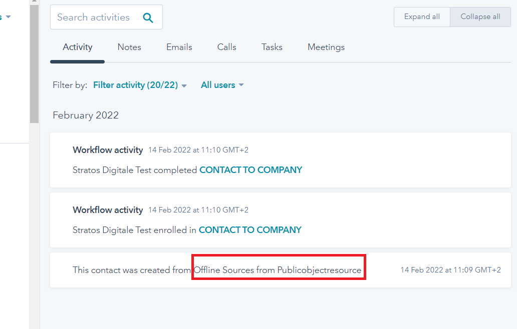

However, I noticed in HubSpot that the Contact created by the workflow in Pabbly counts as offine (the workflow in Pabbly goes from Google Ads Lead Form to New Contact HubSpot.
How can I see that new contact as Google Ads, Paid etc in HubSpot but not offline?

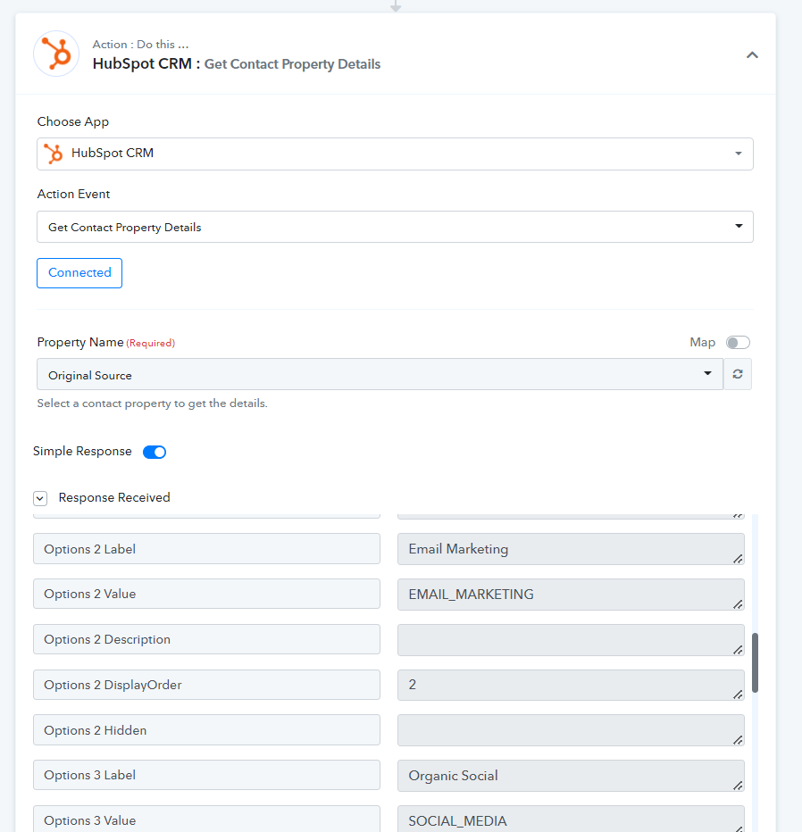

The Offline Source from Publicobject source appears as default from Hubspot if you do not pass anything in the "Original Source".
Though if you do not want that then you pass the "Original Source" in the field as mentioned in your Hubspot. And to retrieve that you can use the "Get Contact Property Detail" action event.

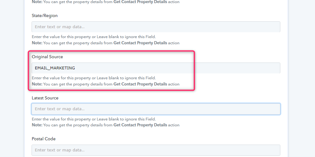

Thanks @Supreme,
it worked this way and I can see the original source as I manually set it in the workflow!

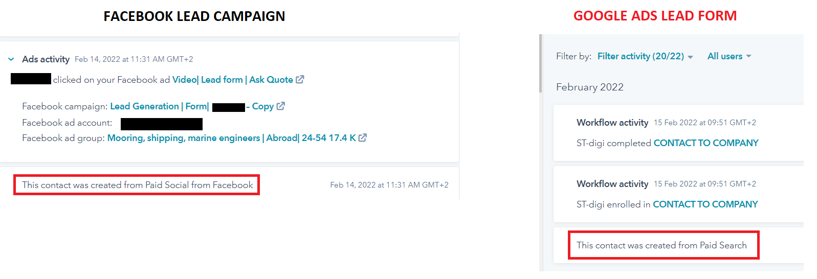

However, I can't get more info about the campaign. For example in the facebook lead campaign (just HubSpot- no workflow), it shows the "ads activity" where I can see the campaign name and some extra info. On the google ads lead form I can only see the source but no other activity. Is there any way I can see more info from the workflow to HubSpot?

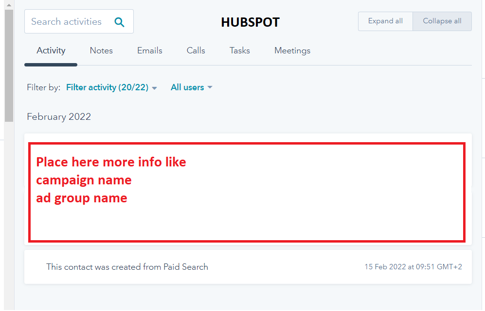

Is it possible for the Google Ads Lead Campaign, in the HubSpot to show more info?
I would like to know which campaign and which ad group brought that lead. I can only see now that the contact was created by Paid Search. Is it something that can be set from Pabbly and provide me more info on HubSpot?

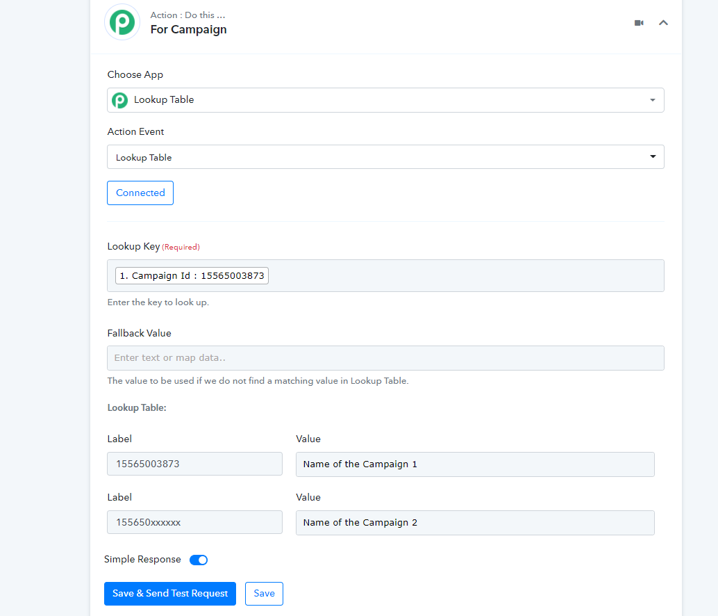

If you can retrieve the Campaign and the ad group ID with their name from your Google Leads account then you can use the Lookup Table action step.
For better understanding, you can refer to our tutorial video -
youtube.com/watch?v=0umsoycOlfo

Thanks @Supreme for the tutorial, the guidance and your precious time (I know that you have many requests all day and your time is limited), but I am not sure how I can pass that info (campaign name, ad group) on the HubSpot when the contact is created.
For example, as you mentioned above I had to replace the "original source" with a value in the HubSpot "Create a Contact (with All Properties)" and that info successfully appeared on HubSpot.
However, even if I created the lookup table for the values, I am unaware in what field/properties I have to add these values to, because I can't find related fields in the "All Properties".
To put it simply, can I somehow pass in the HubSpot environment the Google Ad Campaign value, Ad Group value, etc from Pabbly when a user submits a Google Ads Lead Form?

Since the Google Leads Form doesn't send Ad names and Campaign's names with the lead data. Though as we have suggested if you can set two "Look Up Tables" in your workflow one for Ad names and another one for the Campaign's Name on the basis of their IDs you can use their responses to map the ad and Campaign name.
As we can see in your workflow you have already created the lookup table for ads, kindly make the same for campaigns name and map their response to the Hubspots' action event where you want to show.
