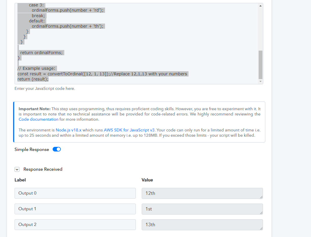

Fagun Shah — Reply ·
Try this JS code action instead, which converts multiple comma separated cardinal numbers to ordinal numbers -
function convertToOrdinal(numbers) {
if (!Array.isArray(numbers)) {
return ['Input should be an array of numbers'];
const ordinalForms = [];
for (const number of numbers) {
if (typeof number !== 'number') {
ordinalForms.push('Not a number');
} else if (number % 1 !== 0) {
ordinalForms.push('Not an integer');
} else if (number >= 11 && number <= 13) {
ordinalForms.push(number + 'th');
} else {
switch (number % 10) {
case 1:
ordinalForms.push(number + 'st');
break;
case 2:
ordinalForms.push(number + 'nd');
break;
case 3:
ordinalForms.push(number + 'rd');
break;
default:
return ordinalForms;
// Example usage:
const result = convertToOrdinal([12, 1, 13]);//Replace 12,1,13 with your numbers
return (result);
Fagun Shah

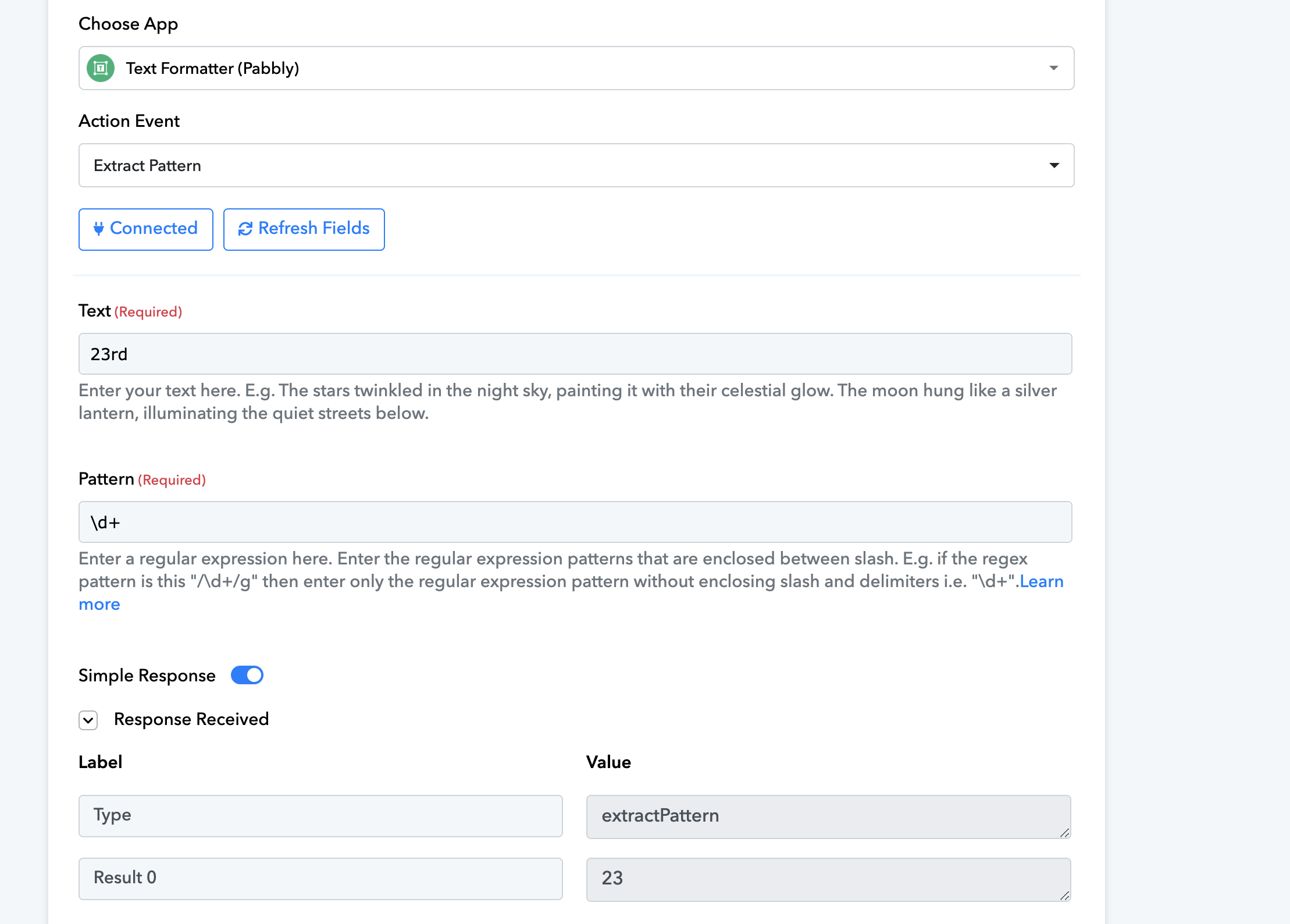

Stuart Sandweiss — Reply ·
use regex to strip out non digits

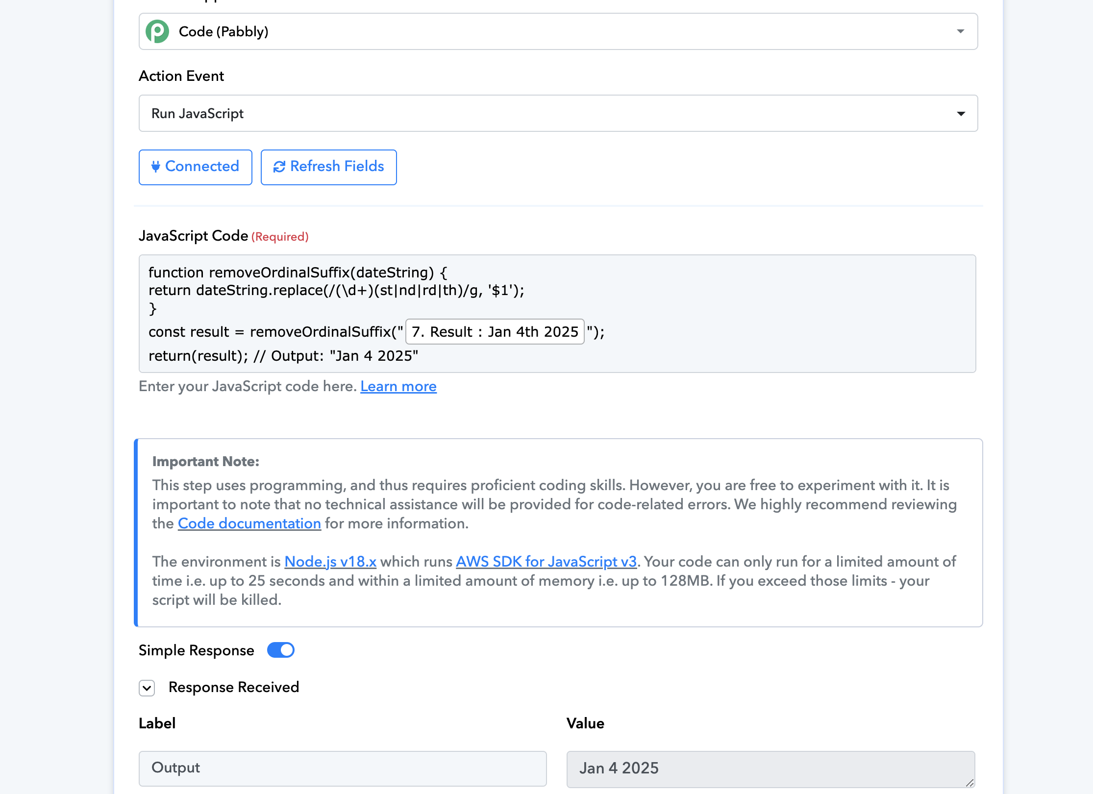

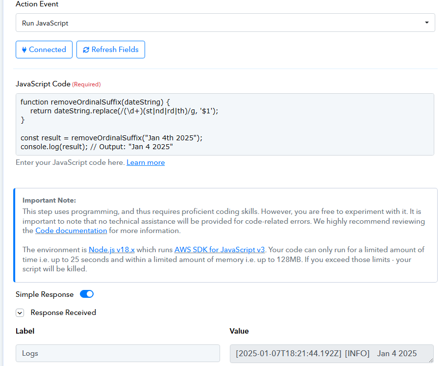

I've tried with javascript, but i don't want the info in [ ], just the result:
you could do that just change the last line from
console.log(result)
to
return(result)
but it is a paid task.
