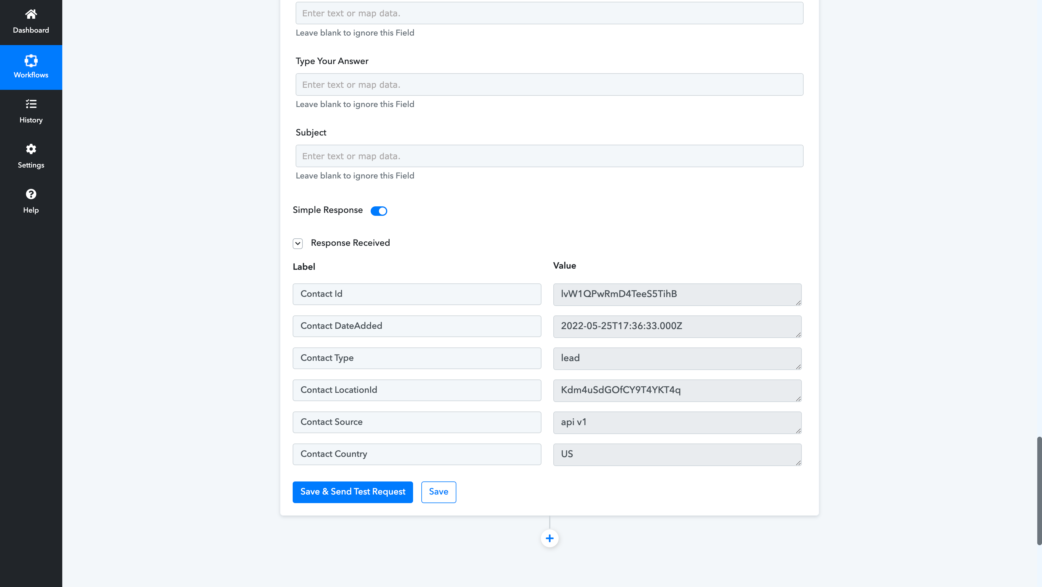

I am having an issue with four of my workflows for creating contacts in HighLevel. They were working fine until two days ago and now they won't pass the information through.
I actually just tried resetting one completely to see what would happen.
This is what happens when I try to save and send a test response:
otherlife — Reply ·
I also just tried setting up a new workflow to do create contacts within a different and new sub account within our agency account and I'm getting the same response.
So, while it will create the contact record, it does not pass through the actual contact record information.

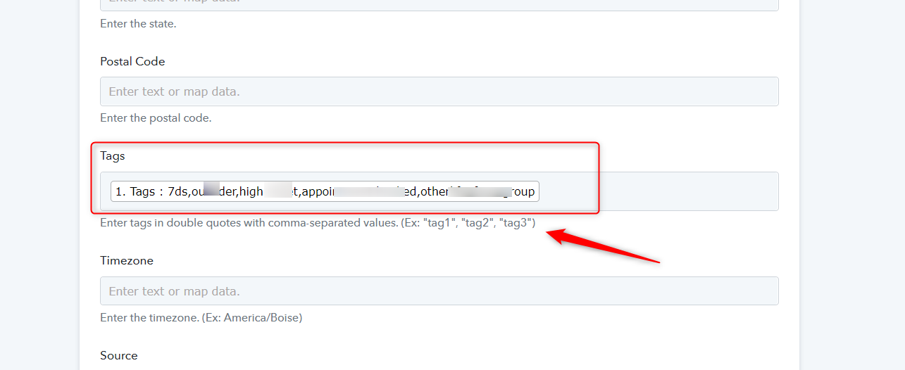

Hey @otherlife
As we can see from your GHL action step you haven't passed the tags in double-quotes as mentioned in the help text and because of that, you are getting such an issue.
Kindly pass the tags in double-quotes and try again. I hope this might help you out.
otherlife — Reply ·
Ahhhh...I understand that now. Okay, thank you so very much for your help once again!
